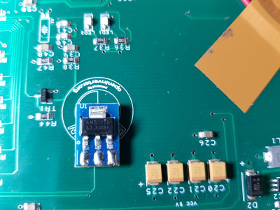

I have a trouble with spontaneously stack a logic board during driving. If I run a Plot it occure wery quick.
I think it some connect with STM core load if load more, it will occure quickly.
Is anybody faced with this bug?
Difficult is - board inside an inverter on a car. How it examine and fix? Change a board?
My Tigra is driving, but the problem can occure on 100km/h on a motorway. It`s damn :x

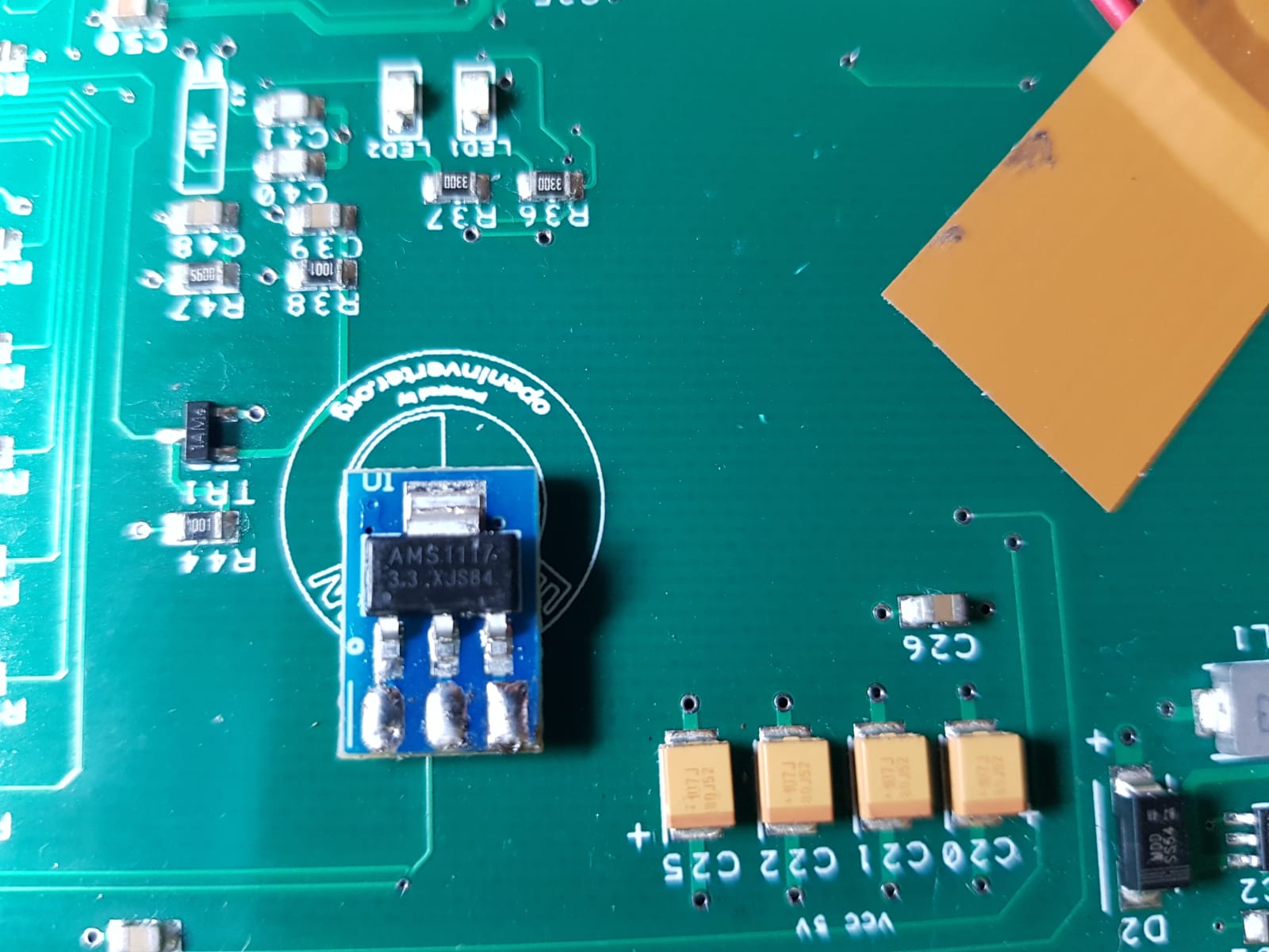

UStas wrote: Mon Aug 30, 2021 9:39 pm I have a trouble with spontaneously stack a logic board during driving. If I run a Plot it occure wery quick.
We may be looking into another LDO issue. Wifi module soaks up 3V3 power giving garbage ADC readings that somehow lead to tripping out.
Posts: 1884
Has thanked: 91 times
Been thanked: 517 times
If that's the issue, I've updated the wiki with Damiens suggested fix. A capacitor needs replacing.

Bigpie wrote: Tue Aug 31, 2021 8:57 am If that's the issue, I've updated the wiki with Damiens suggested fix. A capacitor needs replacing.
I try to suit thinking hat and see :
ESP8266 consume 215mA in transmit mode, but LDO (XC6206P332) provide only 200mA :geek:
Where is power for STM32 ?? Asking I ?? (Where is money lebowski ?(C))
May be we must place one more LDO for STM32 separately??

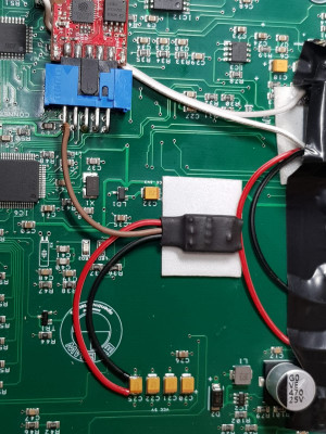

UStas wrote: Tue Aug 31, 2021 8:46 pm
OK. I placed one more LDO separately for ESP8266. First pin to the ESP8266 I cuted .
It`s working!!
I`ve not faced with brain board shuts down.
I think it must be in Wiki .
