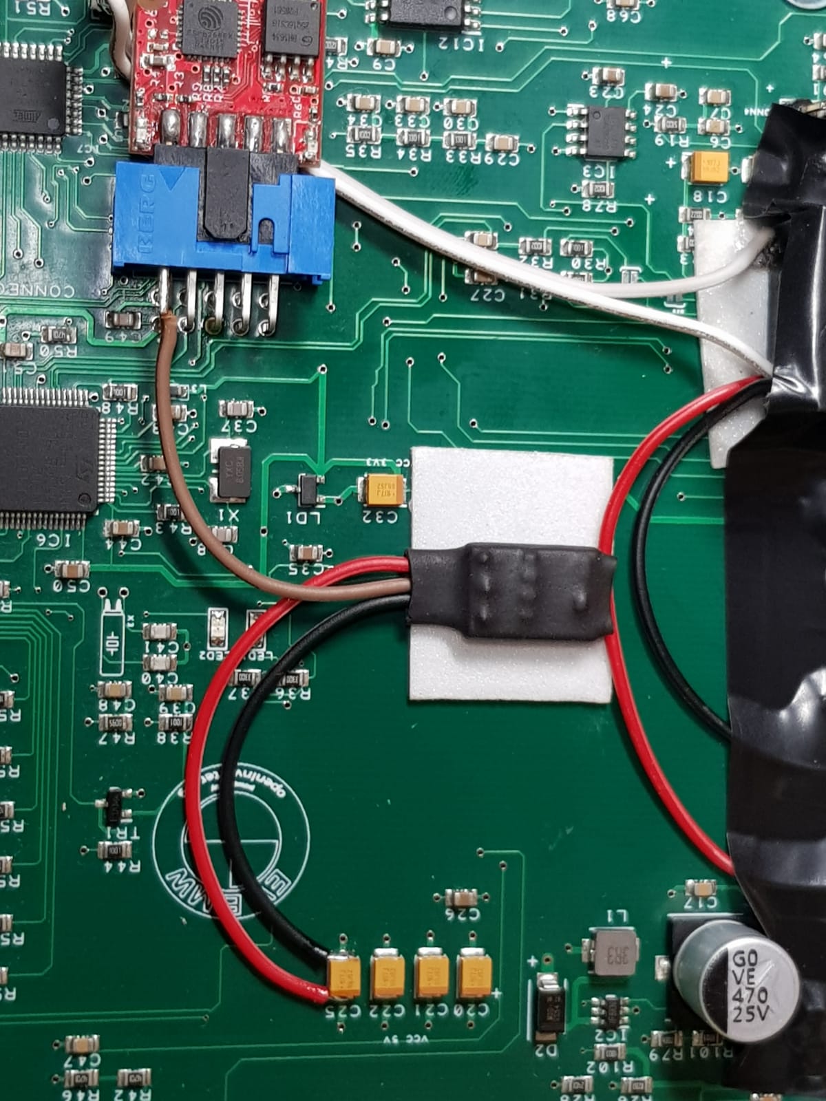

I try to suit thinking hat and see :
ESP8266 consume 215mA in transmit mode, but LDO (XC6206P332) provide only 200mA
Where is power for STM32 ?? Asking I ?? (Where is money lebowski ?(C))
May be we must place one more LDO for STM32 separately??
My project is Electro-Tigra https://electrotransport.ru/ussr/index. ... 5.0#topmsg

I didn't do the cap change yet. I had a little dc dc board laying around so used that from 5v.

I have this problem with two Olimex boards on my dual inverter, each using its own ESP8266 wifi module. It needed a lot of decoupling even with 500mW LDOs each. I am not sure what happens, but i suspect reference plain rises because of noise and one Olimex drops OC error when i press throttle or just start DC switch.
Interesting enough i didnt observe the sam with Wemos D1 mini board. Here i have stable wifi.

OK. I placed one more LDO separately for ESP8266. First pin to the ESP8266 I cuted .
It`s working!!
I`ve not faced with brain board shuts down.
I think it must be in Wiki .
