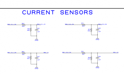

My current sensor CAPs (C57,C59) are indeed out of range at 3.84V. I checked the voltage dividers and found the resistors are all pretty close to the V1c circuit guide. the largest difference was R72 at 2.8k when it should be 3k but im not sure if that alone can cause 3.84v on the caps. the only other variance i could find was -4.95v not -5 on conn7 for the - 5v pump test on MG2. does anyone have any additional ideas for components i could test thanks
- bexander
- Posts: 897
- Has thanked: 78 times
- Been thanked: 102 times
Yes, 3,84V seem way out of spec.
What is the voltage before the current sensor voltage divider? Measure the voltage on the left side of R62 to gnd resp. R71 to gnd.
My schematic for V1c board states 6k2 and 3k6 resistor in the dividor circuits?

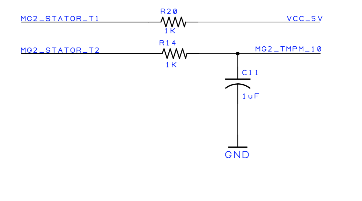

Struggling it workout how the motor thermistor should be connected and the voltages be calculated. This doesn't match voltage dividers I'm used to seeing for my simple projects.

So it's become apparent there's an error here, R14 should be in parallel C11. I'll add this info to the wiki but just posting here as an FYI.
