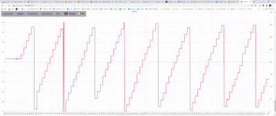

I am working to get an industrial ACIM running using a throttle pedal. I am able to successfully spin run my motor in manual mode, so now I'm on to getting my setup to work using an E46 hall effect throttle pedal. After spending time fiddling about with my inverter and searching this forum, I was able to get control the motor using the throttle pedal. Since I had this modicum of success, I wanted to share my progress with the forum in case anyone might find it useful.
Areas where I've made progress:
Areas where I still lack understanding:
I'm still not clear on how to get the A/B mode of the inverter software to work properly with my A/B encoder. I'm using an optical incremental encoder with an A/B (90 deg. offset) and an index (Z). I do not anticipate using the index input, but wanted to have it just in case I might use it in future. I started off with "encmode" = 1(A/B), but I couldn't get the motor to work properly in this mode. My encoder has 200 ticks on it and so I used a value of 200. I decided to switch to manual model and set "ampnom" = 0 and "fslipspnt" = 0 and spun the motor by hand while plotting angle. Based on what I saw in the plot, the angle parameter went through two rotations for every one rotation of the motor shaft. I then updated "numimp" = 400, and restarted the inverter and while the motor responded to throttle input, the response was very weak. Also, the motor did not respond to any of the tuning parameters (like boost, etc.) with "encmode" = 1.
In a last ditch effort, I switched "encmode" = 0(single), set "numimp" = 200, and restarted the inverter. With these parameter values the motor finally responded as expected to the throttle pedal. In this mode, other parameters began to responding to changes in input, so I considered this a success.
However, I wanted to understand why the motor didn't run properly when "encmode" = 1(A/B). In order to understand what was happening, I plotted "angle" and "turns" with "encmode" = 0(single), set "numimp" = 200, and restarted the inverter. I switched to manual model and set "ampnom" = 0 and "fslipspnt" = 0 and spun the motor by hand while plotting "angle" and "turns". I observed that the angle went from 0 to 360 (as expected) and for every turn of the motor shaft, the "turns" variable incremented by 1. This was good and made sense.
I switched back to "encmode" = 1(A/B) from "encmode" = 0(single) and plotted "angle" and "turns". Again, I switched to manual model and set "ampnom" = 0 and "fslipspnt" = 0 and spun the motor by hand while plotting "angle" and "turns". However, instead of getting "angle" = 360 deg. corresponding to 1 "turns", I get something like an "angle" = 720 deg corresponding to 1 "turns". As I stated earlier, there's something I probably don't understand or a parameter I've set incorrectly, so I wanted to ask if anyone else has run into this and what they did to resolve it so they could use an A/B encoder.
Has any one else experienced this? I think there must be something I'm missing here. Anyone have any thoughts on how I can correct this and use the A/B mode for "encmode"?
I've made two tedious videos of my efforts and posted below:
1: Update firmware via WiFi, but motor doesn't respond to throttle because I didn't have "udcmin" parameter set properly.
2: Motor responds to throttle with "encmode" = 0 (single), but doesn't respond well with "encmode" = 1 (A/B).

Hi i think enc channels A B on your board are linked together on main board so that you can only use channel A on input. Its hardware
Check schematic if you need to unsolder a jumper or resistor maybe.
I remember experimenting with AB encoder and ACIM motor. Generally motor would run on only A channel just fine. Difference shows only in little things such as reversing downhill in gear or a bit smoother running at really slow speed.
- Posts: 3660
- Has thanked: 10 times
- Been thanked: 334 times
No it uses seperate lines for A and B there is no linking. Most likely you need to swap A and B.
I double checked my wiring for encoder channels A and B and everything was correct. As I was troubleshooting, I noticed that when I plotted the angle parameter and rotated the motor shaft by hand (in the anticlockwise direction), the angle parameter values increased for encmode = single and decreased when I set encmode = A/B. So, I was pretty well convinced I needed to swap the encoder channels.Jack Bauer wrote: ↑Tue Mar 02, 2021 9:16 am No it uses seperate lines for A and B there is no linking. Most likely you need to swap A and B.
When I swapped the A and B encoder channels, the motor spun up beautifully!
Note that when I switched back to encmode = single after swapping the channels, the motor would not spin.
Thank you Jack Bauer!
