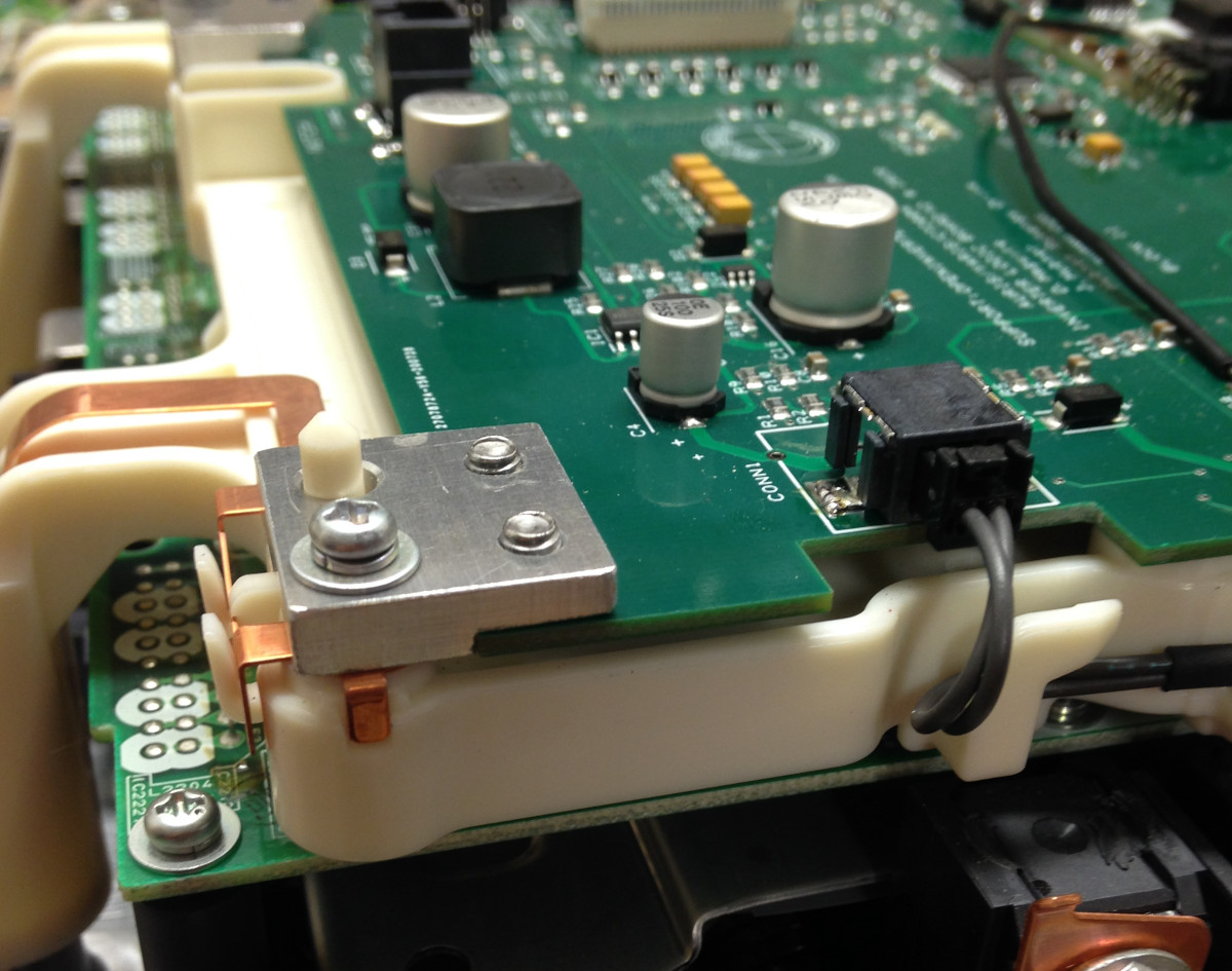

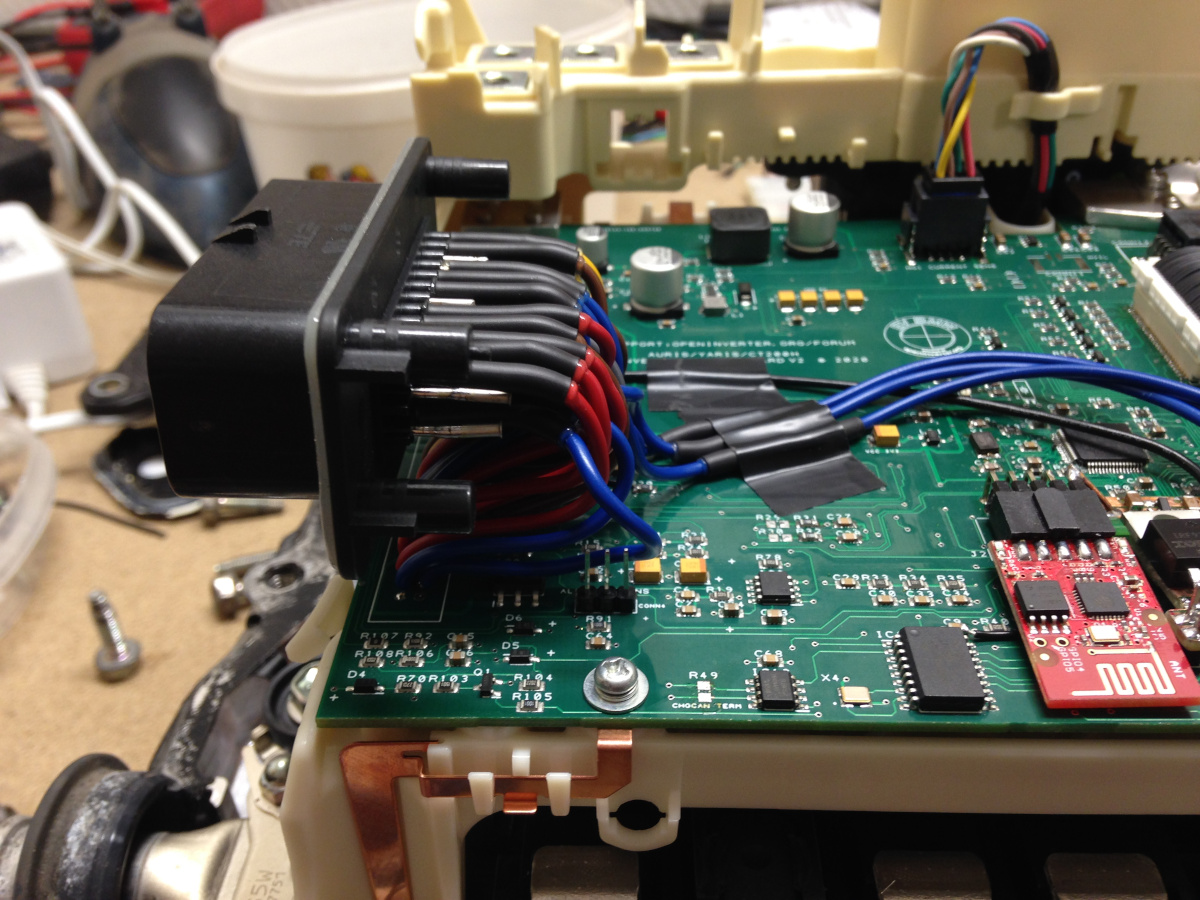

It seem to be possible to fit a Yaris board in a Prius inverter, using some adaptors to elongate the PCB to reach the mounting points. Will post pictures when the install is complete.
The battery bus main capacitor in the Prius inverter is specified for 470V so there are some margin left.
Tomorrow I will have a look at the DC/DC side of the inverter.

Here is a picture of how I made the Yaris logic board fit in a Prius Gen3 inverter.

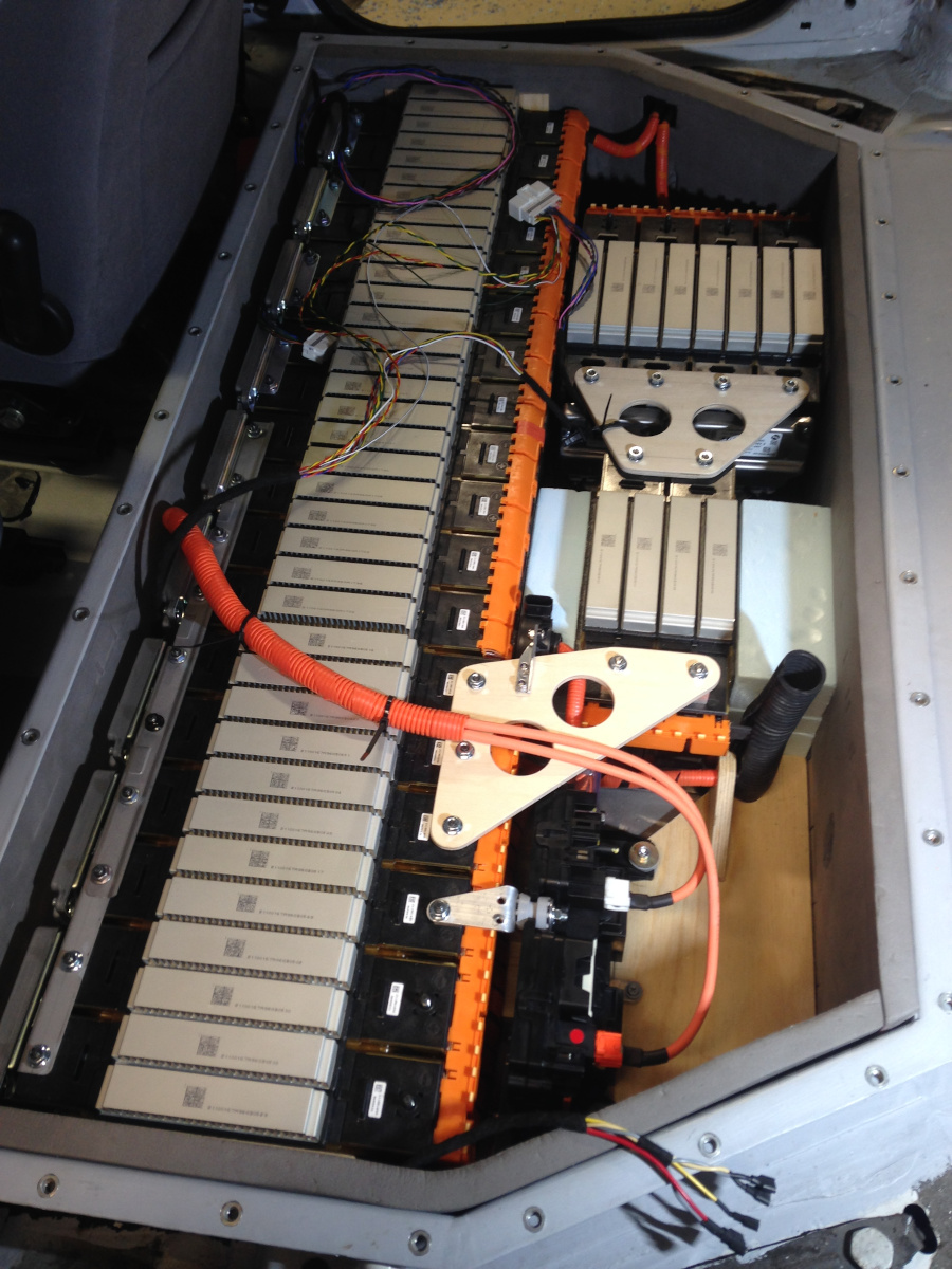

I have decided to use a battery pack from a Kia Niro PHEV so will end up with 96S @ 3,75V for a total of 360V with a capacity of 24,7Ah and a total energy of 8,9kWh. This is similar to what I'm currently are running in terms of energy but the weight will be approximately half, so a weight saving of about 50kg.
I will have to sort a BMS. The OEM slave boards are included with the pack so I will have to wait and see what can be done there. Otherwise I need to expand my current BMS to handle 96S or, as a last resort, Johannes BMS.

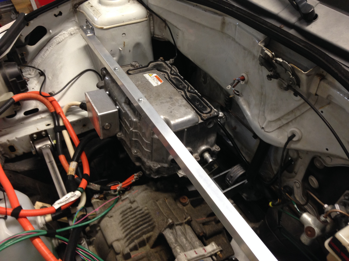

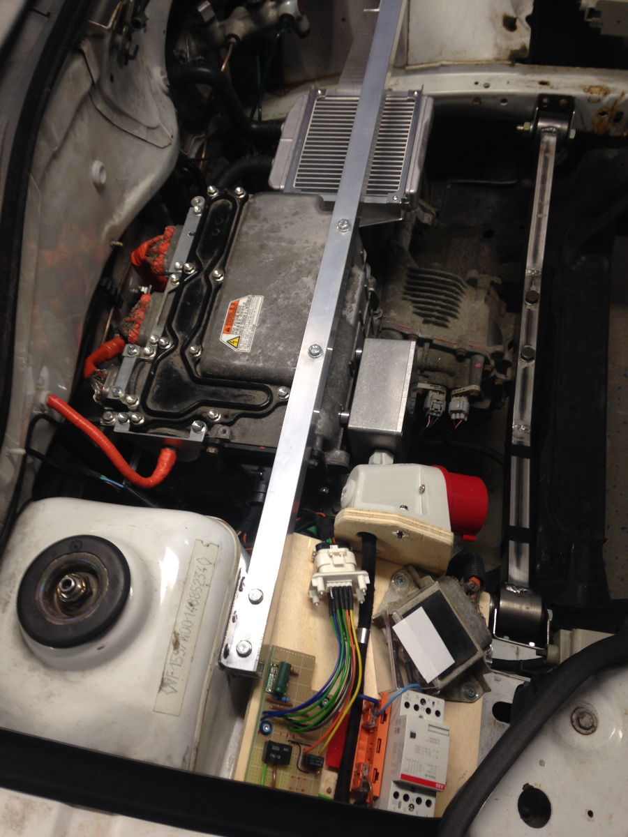

Finally some progress to report.

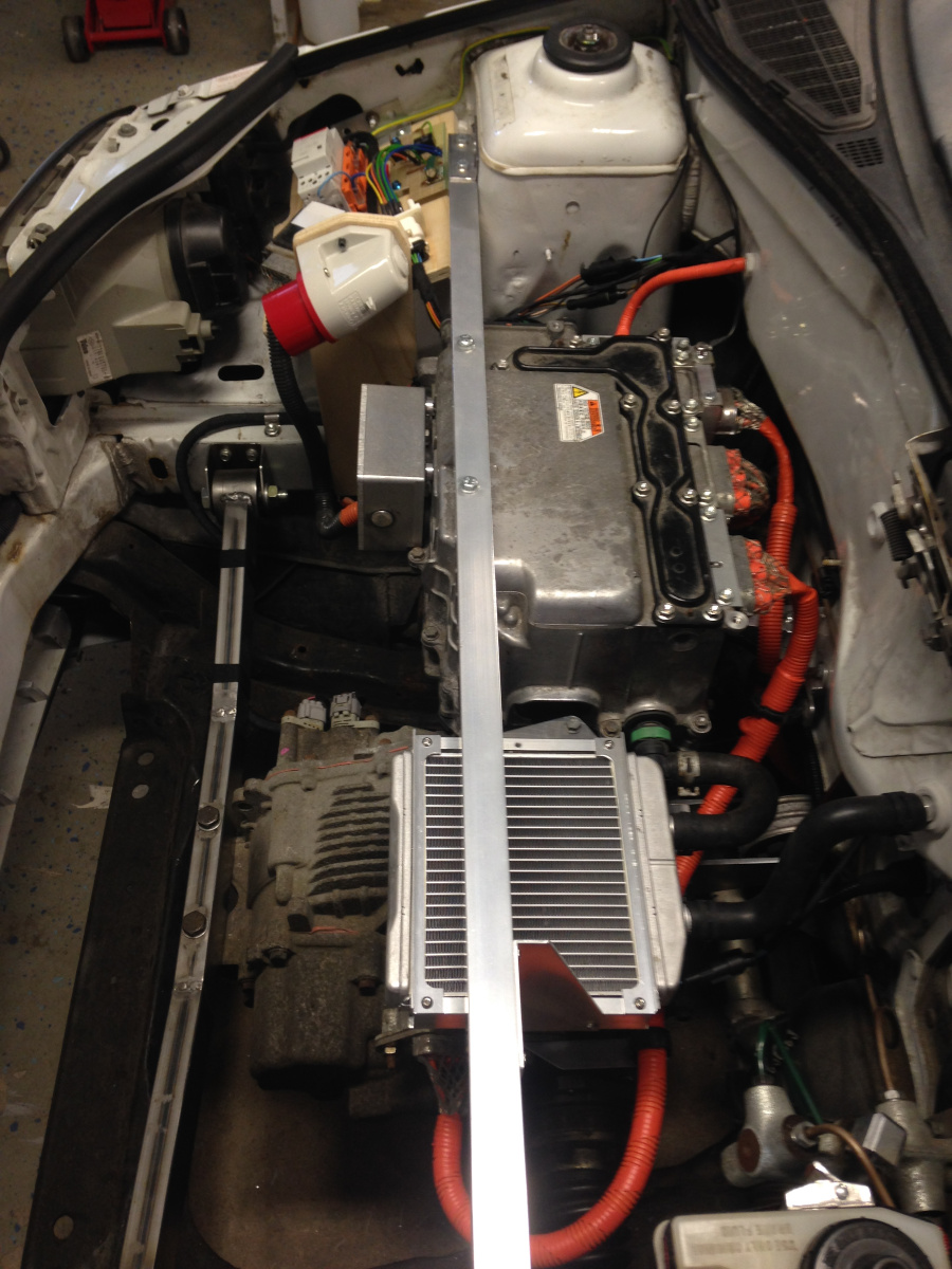

Prius inverter installed in a more final position.

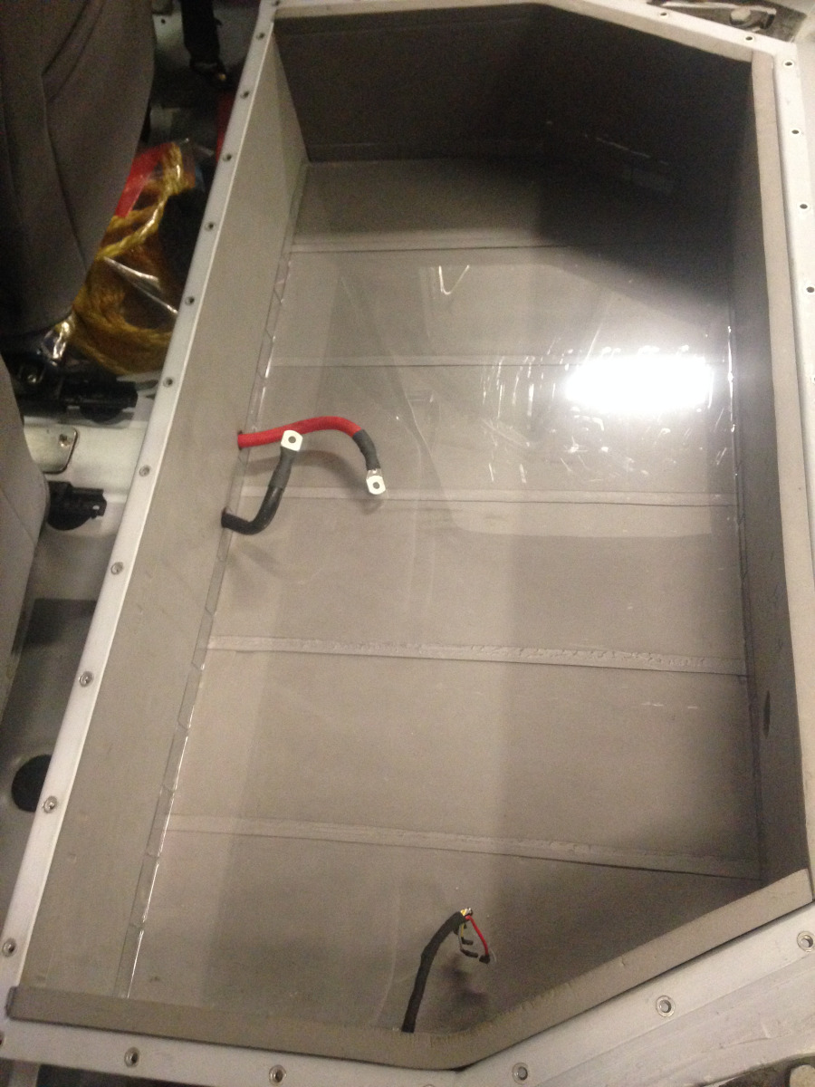

This is how the battery box used to look.

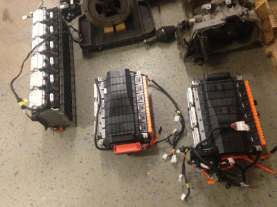

Battery box as of now.

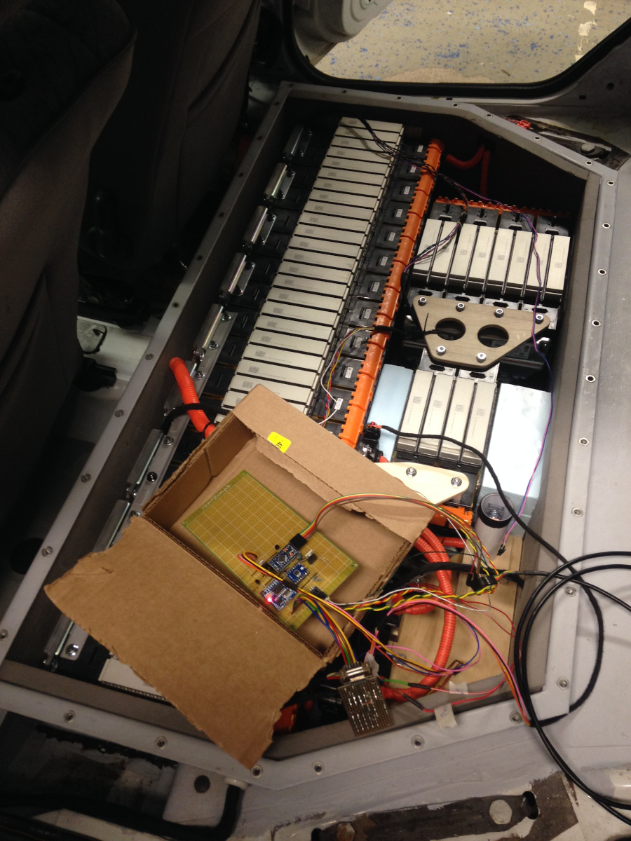

This is whats intended to go in the box. Battery from a Kia Niro PHEV (same drivetrain as Hyundai Kona PHEV).

I will try and post specific info on the BMS in this thread.
viewtopic.php?f=13&t=1179
My intention, as of now, is to try and use the slave boards together with a home built master board.
Will start by reading up on the MAX17823BG chip used in the slaves and hopefully understand how the communication is done.
Then try to decide whats needed as master controller. Would be good if I can get away with a Atmega328p.

Some updates.

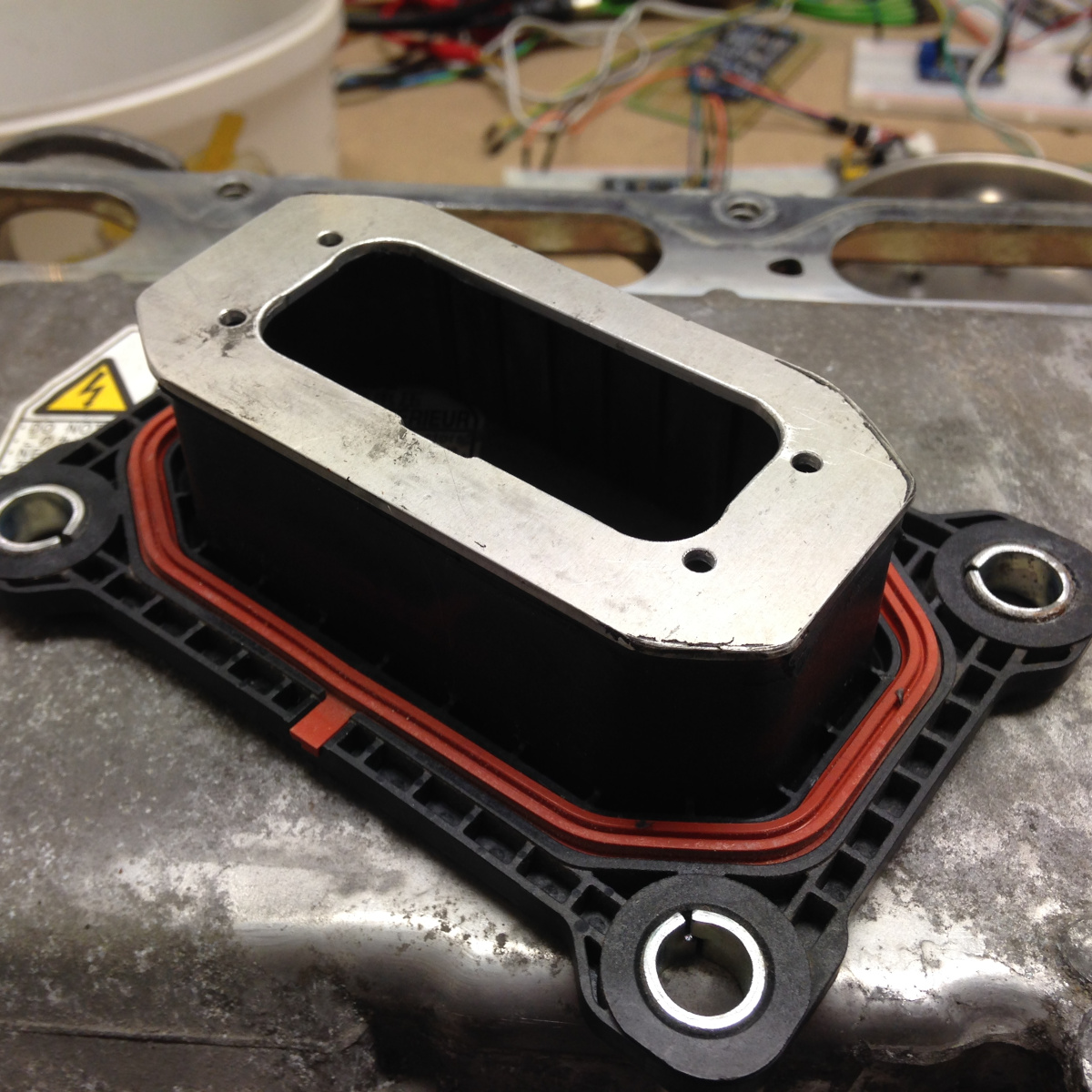

I have assembled the inverter for what I hope is the final time.

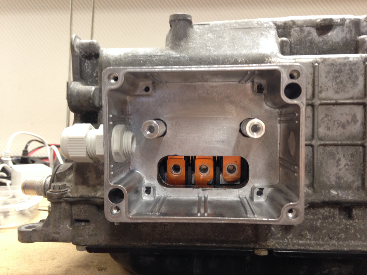

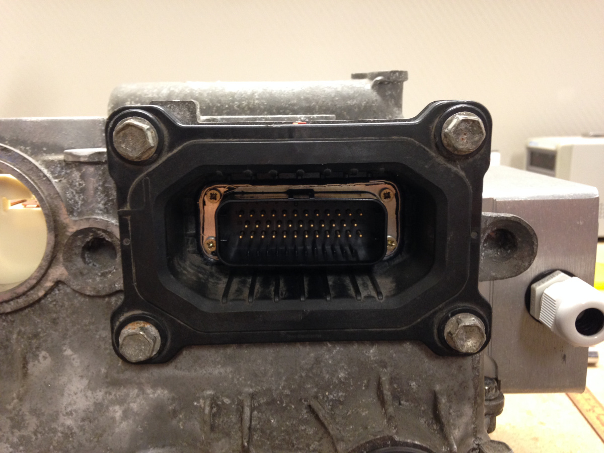

The mods I have in place are to be able to fit the Ampseal connector by using the original connector cover.
I have also added a contactor to be able to short the buck/boost while driving but still be able to use buck/boost for charging.
Inverter back in car.
Next to do is HV and LV wiring.

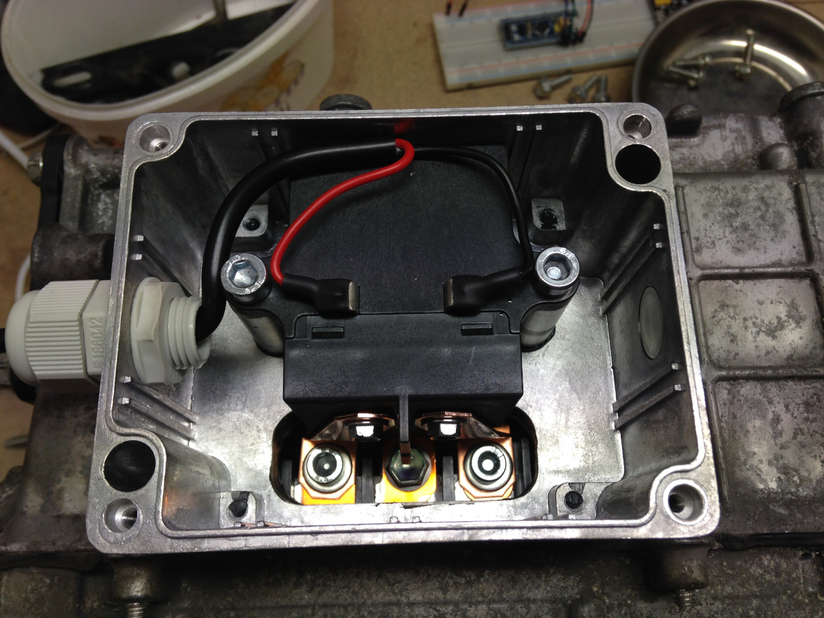

Got the motor cable in place. Looks almost OEM if you ask me.

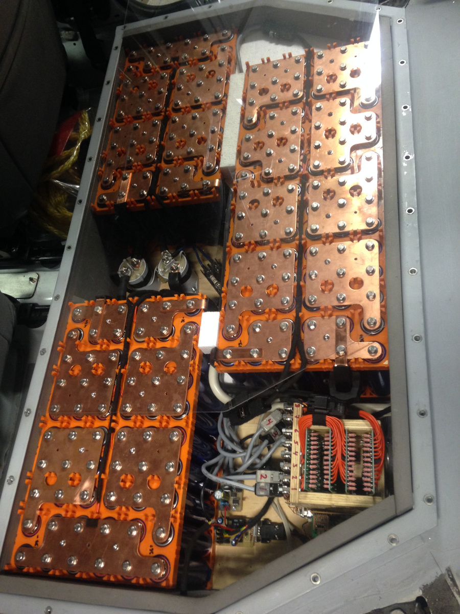

The battery change process goes very slow but now it is almost done.
Battery cells in battery box.
Next is to look into BMS and at least get cell voltage monitoring to work so I can test the car.
Wiring for the Prius inverter also needs to be sorted.
Lastly, get the charger running. Thanks to celeron55:s code this will hopefully be straightforward.

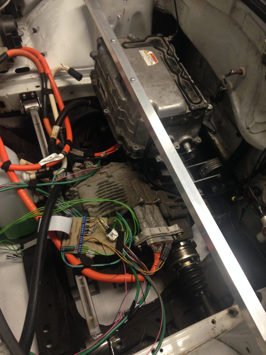

Time for an update.
I now have all the HW in the car, some very temporary like the "charger" AC-input and the BMS is work in progress.
Pictures of engine bay. My intention is to stuff the AC-input in a sealed box when I know everything works the way I want it to.
A picture of the battery box as well with temporary BMS wiring.
Will get a PCB made for the BMS when everything is up and running.
