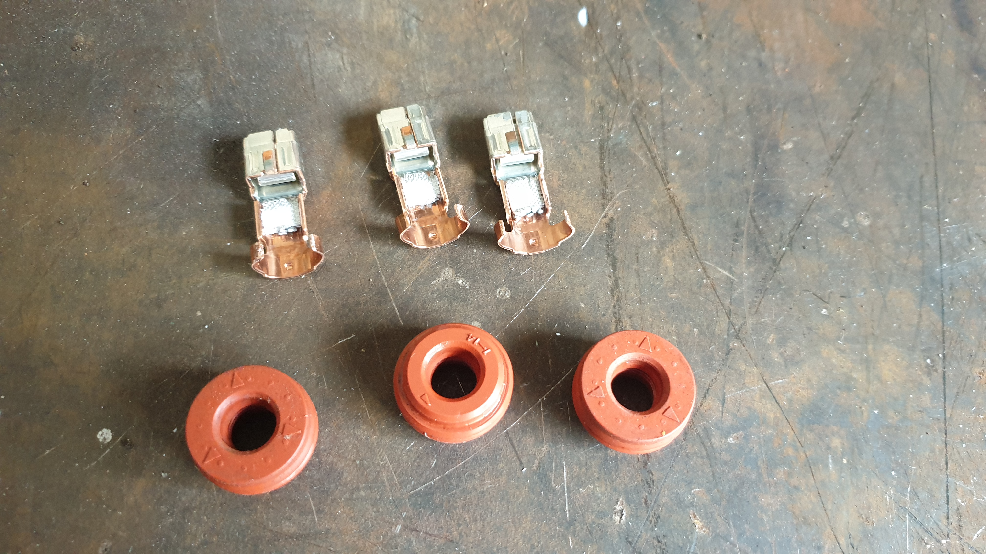

Re: The Blue Yacht : E39 + Lexus MGR
So I found a potential source of connectors for the MGR. I happened to have 3 Gen 2 prius battery to inverter plugs. Massaged off the plastic with a mallet and got 3 nice large connectors that fit the MGR terminals perfectly. Wouldn't be surprised if they were the same part.
THANKS! I was wondering what to use and didn't even think of that. Worst part is that my HV cable is laying there coiled up next to the bench....Jack Bauer wrote: ↑Wed Sep 30, 2020 7:06 am So I found a potential source of connectors for the MGR. I happened to have 3 Gen 2 prius battery to inverter plugs. Massaged off the plastic with a mallet and got 3 nice large connectors that fit the MGR terminals perfectly. Wouldn't be surprised if they were the same part.
I've tried to just pull Lexus cables out of inverter side plug and insert them into prius's inverter side plug, but they won't fit. Terminals profile and lenght are different, as well as latching hole size. Cable diameter is also slightly different - when I pulled prius sealant rubber on Lexus cable, it ripped.Jack Bauer wrote: ↑Wed Sep 30, 2020 7:06 am So I found a potential source of connectors for the MGR. I happened to have 3 Gen 2 prius battery to inverter plugs. Massaged off the plastic with a mallet and got 3 nice large connectors that fit the MGR terminals perfectly. Wouldn't be surprised if they were the same part.

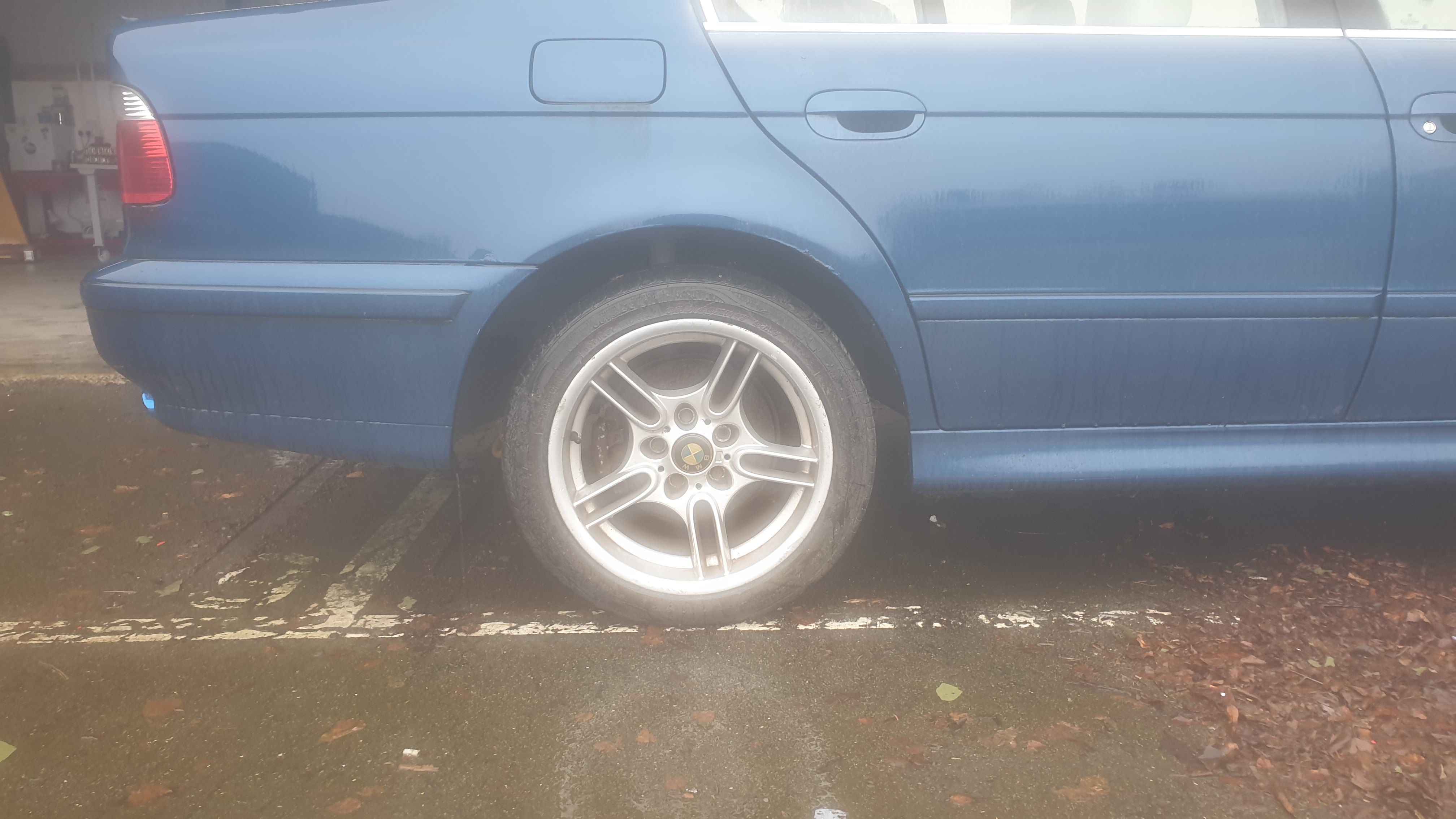

As you folks know I hate warm and dry climates so I spent a few hours rolling around on the tarmac today until I got soaked and cold. Ahhh so refreshing
Anyway subframe is back in the car, only needed a small bit of cutting to accomodate the mods but wow did my favorite automaker ever build a car as tough as the E39! Back to base soon and we'll see about making those wheels turn.
