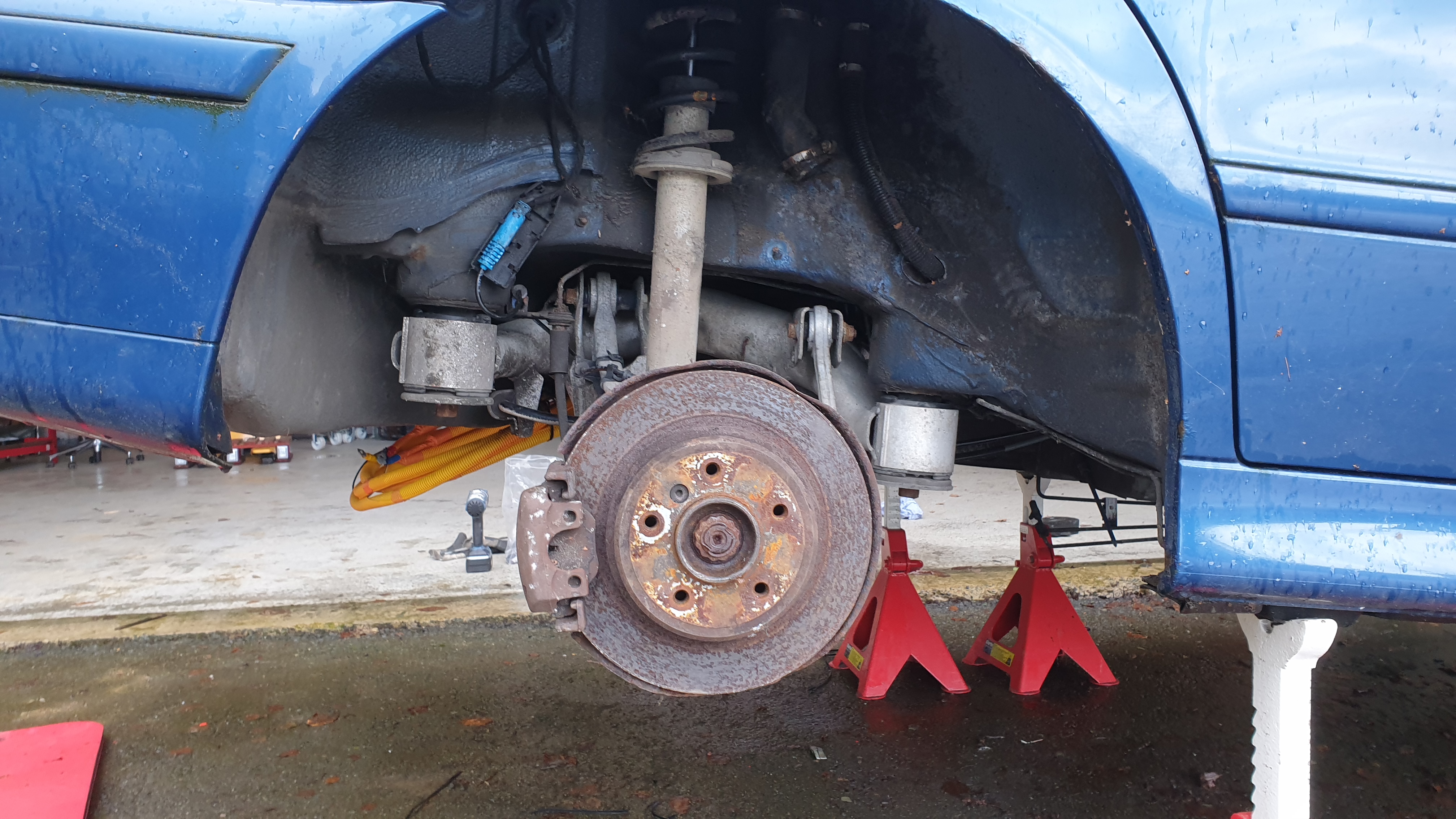

- Posts: 4000
- Been thanked: 1115 times
Re: The Blue Yacht : E39 + Lexus MGR

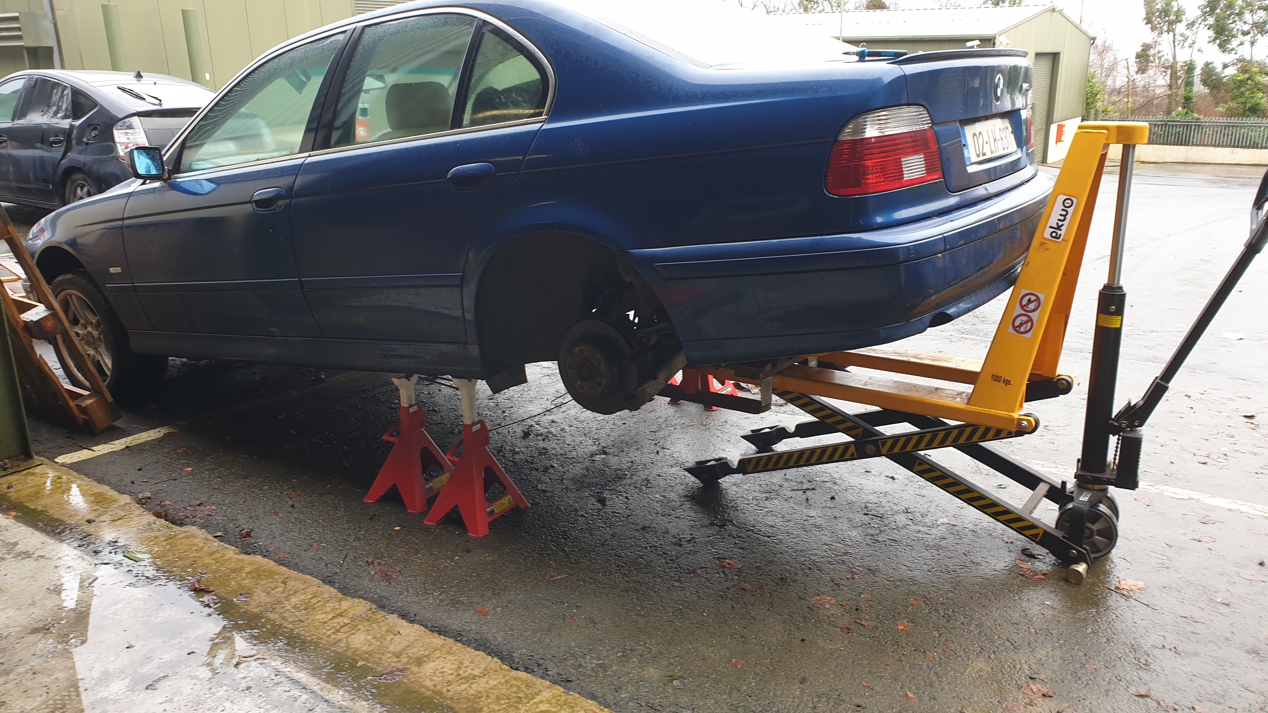

As you folks know I hate warm and dry climates so I spent a few hours rolling around on the tarmac today until I got soaked and cold. Ahhh so refreshing
Anyway subframe is back in the car, only needed a small bit of cutting to accomodate the mods but wow did my favorite automaker ever build a car as tough as the E39! Back to base soon and we'll see about making those wheels turn.

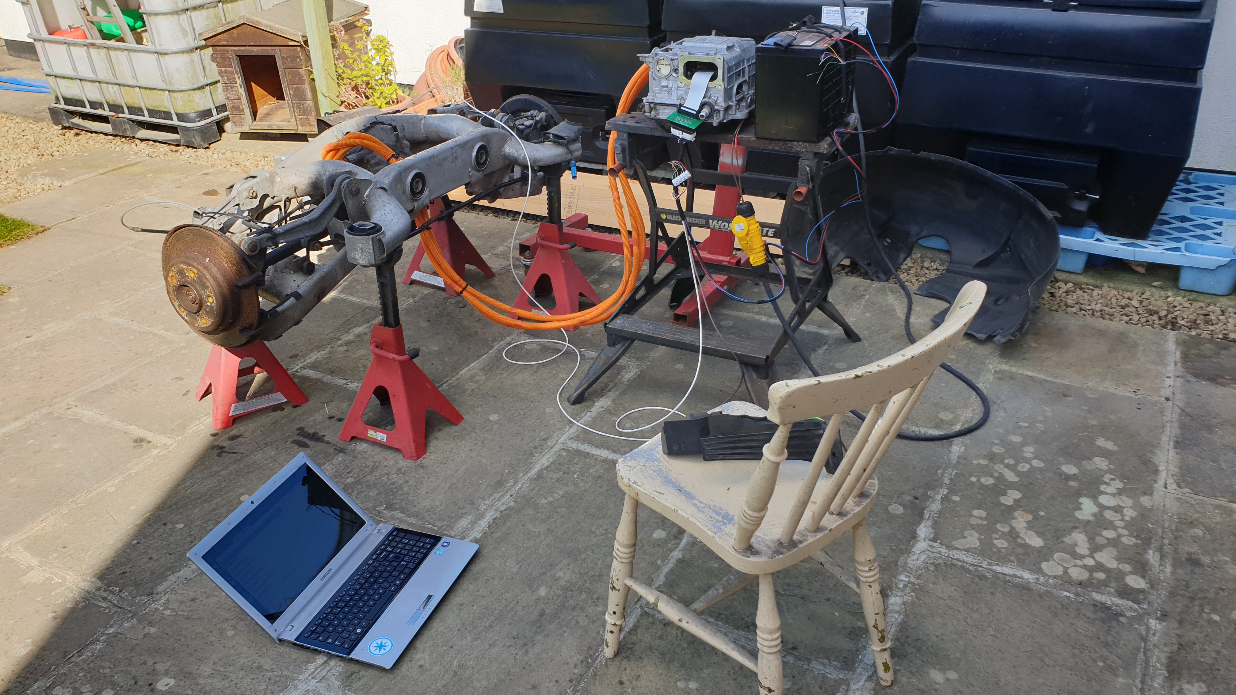

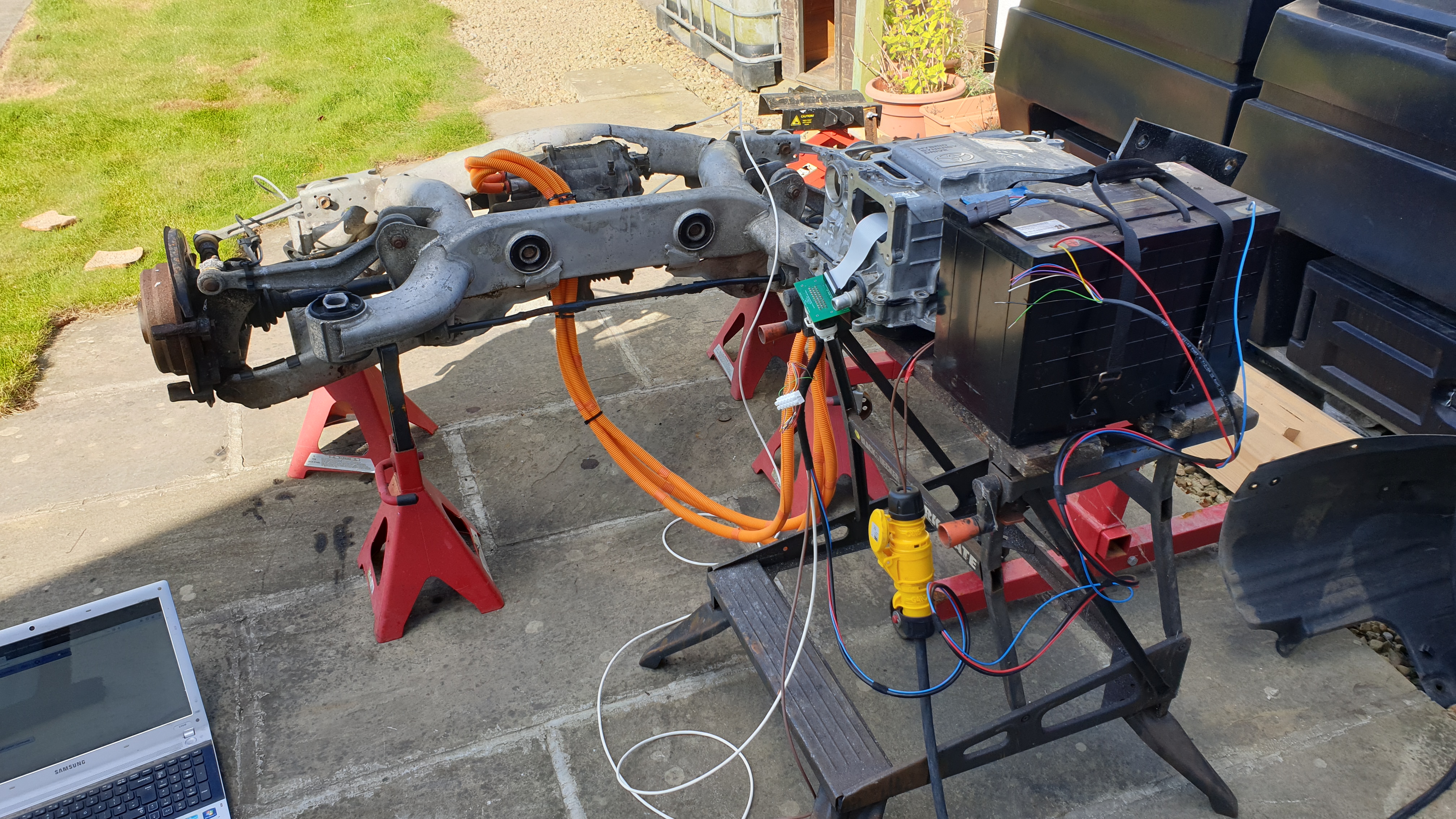

I will indeed, First task was to get the car wired up to roll it off the transporter. For this I made use of 3 of the now infamous valence 18v batteries and a Nissan Leaf contactor box a spdt switch , and a small 12v battery I had handy. The only goal in this was to move car off trailer. I did have some fun parking the car out of the way. Before anything is said , car has handbrake half on and 12v supply gets disconnected if cable to throttle gets tight https://photos.app.goo.gl/ioT52UTaCcQovBBi6
That throttle pedal looks familiar
54v moving a comparatively heavy modern BMW with it's handbrake partially on, makes me all the more confident that 240ish volts could get the job done in the VOLTswagen Squareback
