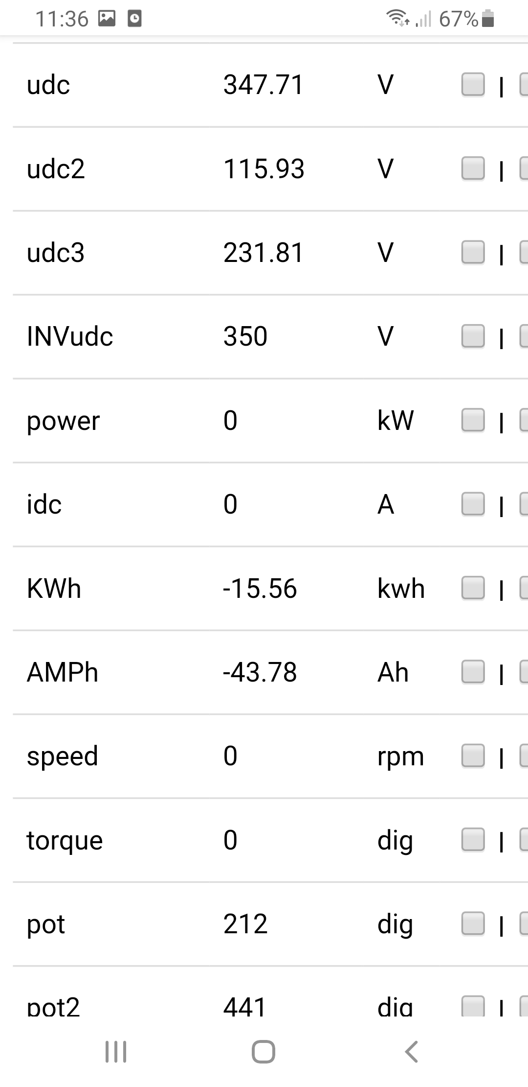

Posts: 4000
Been thanked: 1114 times
Re: Nissan Leaf Powered E46 Touring
Took the goose on a run today. 325wh/mile by my math with no regen and mostly 70mph+ on motorway.
