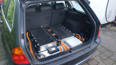

What sort of battery setup does the goose have at the moment, if I recall correctly its a Renault Zoe 40kwh pack right? Are there any plans for adding rapid charge capability to the Zoe pack?

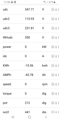

Got started on wiring the Zombieverter vcu today. That pcs is still mocking me of course....

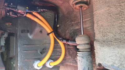

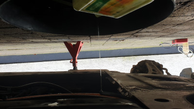

Finally a bit of progress on the touring. Fitted a brake vacuum pump (vag version with built in relay) and did some charging with my trusty "middle class man's" charger. Got two birds with this : 1)tested out charge mode in the vcu and 2)got some charge into the pack.
Obviously we'll be using the pcs in the near future but I have an nct test soon for this car so just need it gassed up so can get there and back. PCS will need some dry weather as I'll have to camp out beside the car and fling can at the thing:) Of course nothing quite goes to plan and every 10 mins or so when I started charging a contactor dropped out. Spent an hour chasing a non existant software bug to find its a dodgy contactor! Glad I found this in the driveway and not out on the road. 10 mins is just enough time for me to have hit the motorway!

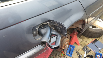

Some grey goose progress thanks to a few fine days. CCS charge port fitted. Planning to use the i3 controller for the CCS side of things. Two new tyres for the front and changed out some horrible looking brake fluid. While doing that found some genius had repaired a blown brake hard line with some tube and hose clips. Now that I have a vac pump running in the car it made enough pressure to blow it off! So yeah, after my pulse rate cooled off I did a proper repair.
Next job : fit the pcs controller and start trying to wake up its sleeping Elon brain. That's always easy ....

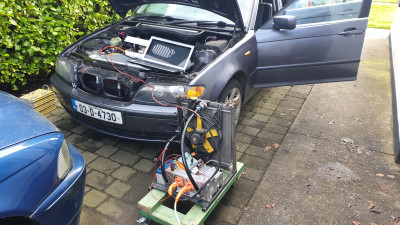

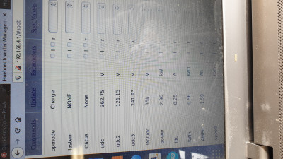

Few photos from today. PCS controller fitted and wired in. Starting to do some can on that tomorrow. i3 LIM and CCS contactor boax fitted to the rear.

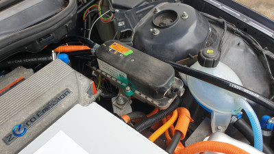

Took the goose on a run today. 325wh/mile by my math with no regen and mostly 70mph+ on motorway.
