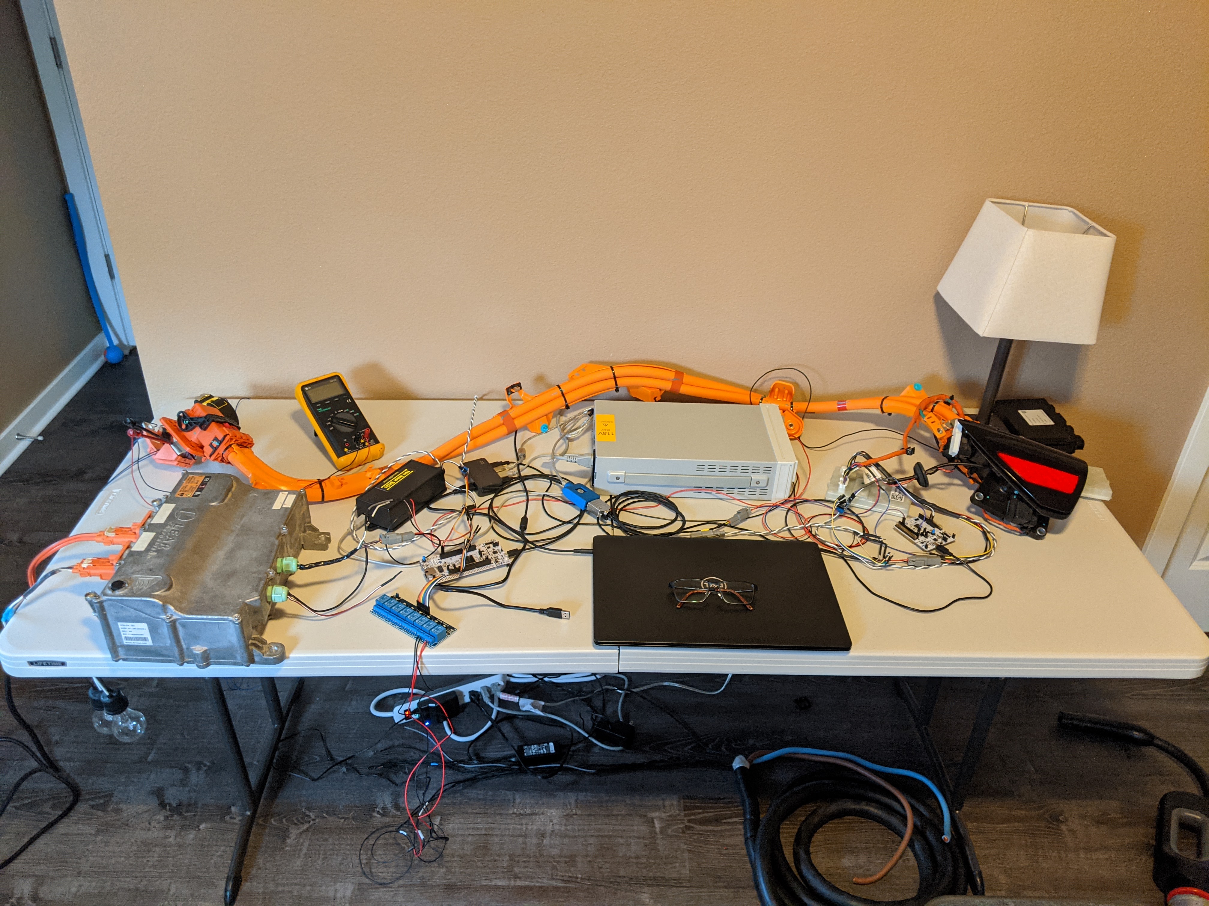

Good news so far today is that I've gotten the charger outputting voltage. I initially wasn't getting the right output, but I set the input current too low :D Annoyingly CAN Low was white, which is pretty much opposite from standard.. (de facto standard, but still...)
I now get 200V with a 1A current limit, looking good so far. I'll test the CHAdeMO out after I eat some dinner. Stay tuned!

YES, YES YES!!
We have working CHAdeMO!!!

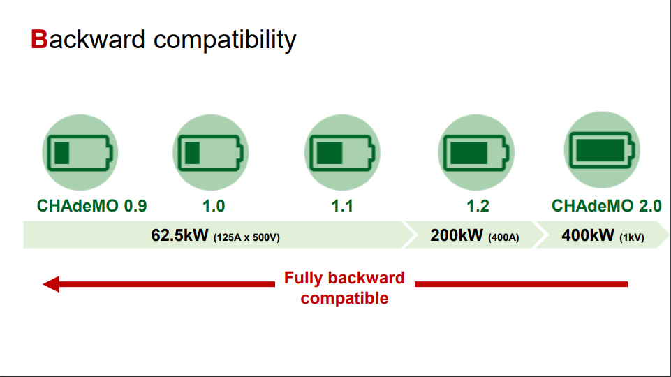

So, I've found current control.
Here's a fun bit - the CHAdeMO adapter _ignores_ anything above 125 Amps.
I'm having a heck of a time figuring out how to set the voltage, however.
That's all for now. Tomorrow I hope to find voltage.

mdrobnak wrote: Thu Dec 17, 2020 5:48 am Here's a fun bit - the CHAdeMO adapter _ignores_ anything above 125 Amps.
-Matt
Congrats! Great job.
What CHAdeMO Protocol is set?
0.9, 1.0 and 1.1 are 125A max
1.2 is 400A (but often you need different hardware/car socket)
See my blogpost on Introducing DC fast charging

0.9 is what the adapter uses.
Interestingly, Fast Charge Limits CAN _does_ show 255A when I set it to that, but it looks like the adapter refuses to send a value greater than 125.
I've only seen standard 50kW (technically 62.5kW @ 500V) ever.

larsrengersen wrote: Thu Dec 17, 2020 9:24 am 0.9, 1.0 and 1.1 are 125A max
Hmm, I've seen 135A on a 60 kW charger. I've implemented 0.9 in Touran.

Odd. From here:
https://assets.vector.com/cms/content/e ... eMO_DC.pdf
That's where I got the 125A number from, and seems to bear out in the Tesla implementation as well. Also note they don't claim to support more than 50kW anyway through the adapter.

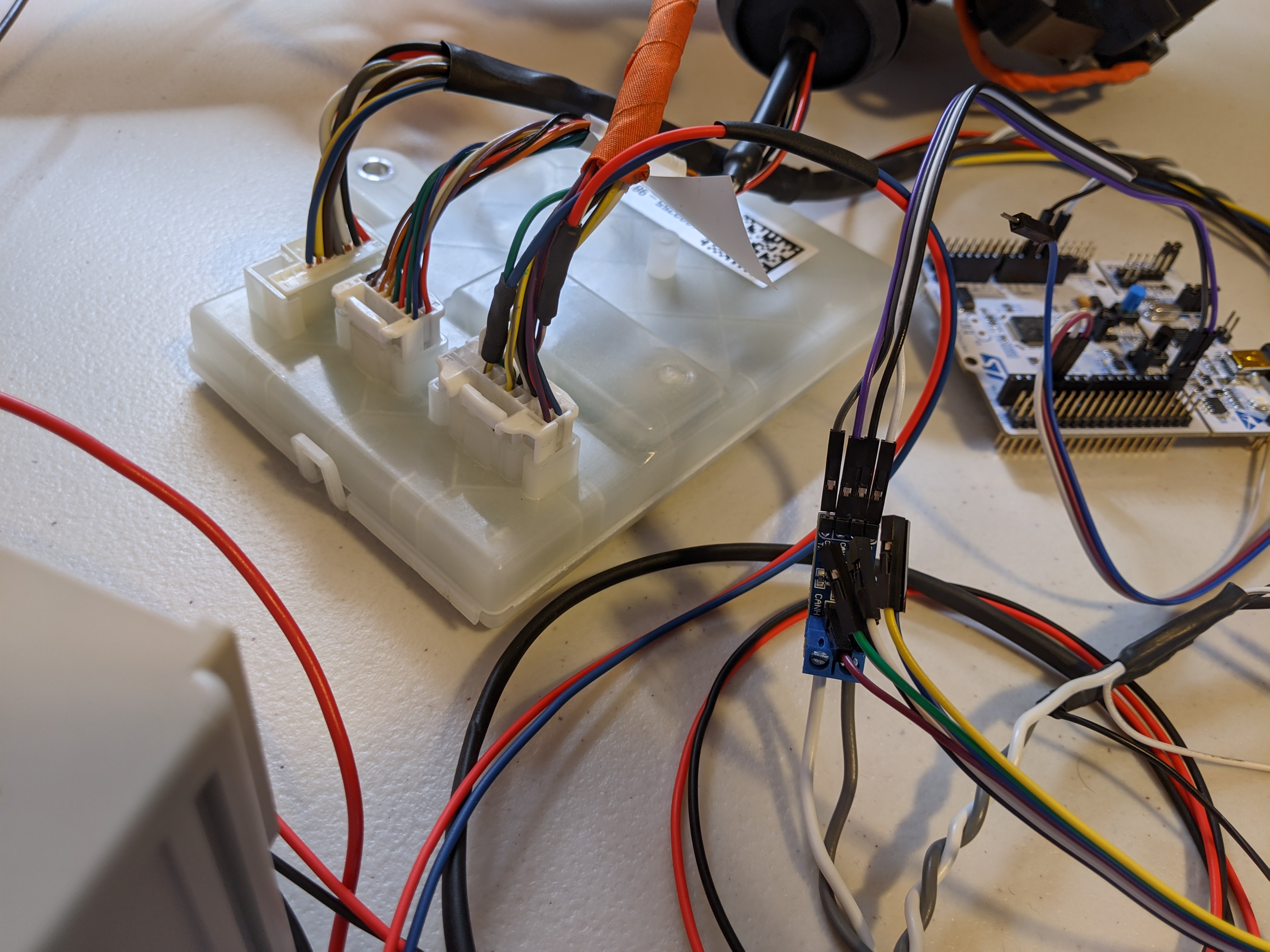

So, I somehow managed to mess with the LED blink pattern, and now my 2019 ECU blinks like my 2018 ECU. I made a dumb mistake and had it powered on while I unplugged the inlet connector, leaving the door / led and power connected.... No idea how I did that one lol.
So.. SWCAN is wired up for sniffing. Except..I can't do it in Linux. Nothing supports 33.3k, and frankly, it needs to be in silent mode due to the pilot -> SWCAN switch. So, off to Windows we go..and I logged some interesting data. Some things I am *not* transmitting on the HV bus are being generated and put on the SWCAN bus. I probably need to fix that data to make the right things happen.
I'll go over that more tomorrow.

So some clarifications... This connector is the one I unplugged and left the power on with:
The green wire is ground, and the white with purple is pilot. This connects to CAN Low (Ground), and CAN High (Pilot).
This then results in:
And my table still looks reasonable:
I did get it to work in Linux using my ValueCAN3. The key is the drivers basically just use the hardware config and can't modify it on the fly. So I booted into Windows, set CAN 1 to 500k and normal mode, and set CAN 2 to 33.3k and silent mode. Now I can capture in SavvyCAN and analyze in Vehicle Spy.

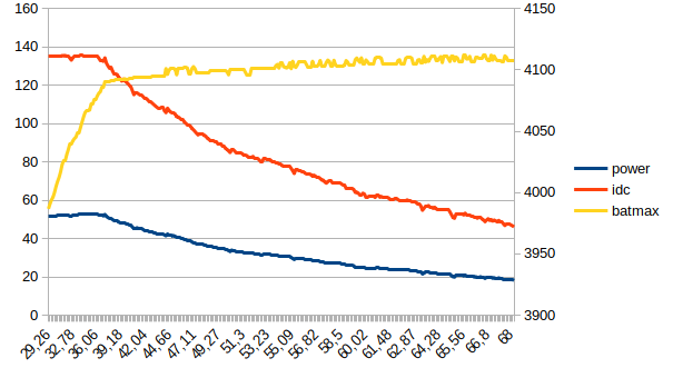

I know I've been quiet, but I'm really battling figuring out some of this data.
So far what I have for the CHAdeMO current request vs what I have listed as a 'BMS current limit' seem to be two completely different items. I'm also unable to get the voltage to change at the moment. So I'm a bit stuck. However I'm trying to attack this from a few different sides and I think I'll see some more progress soon.
