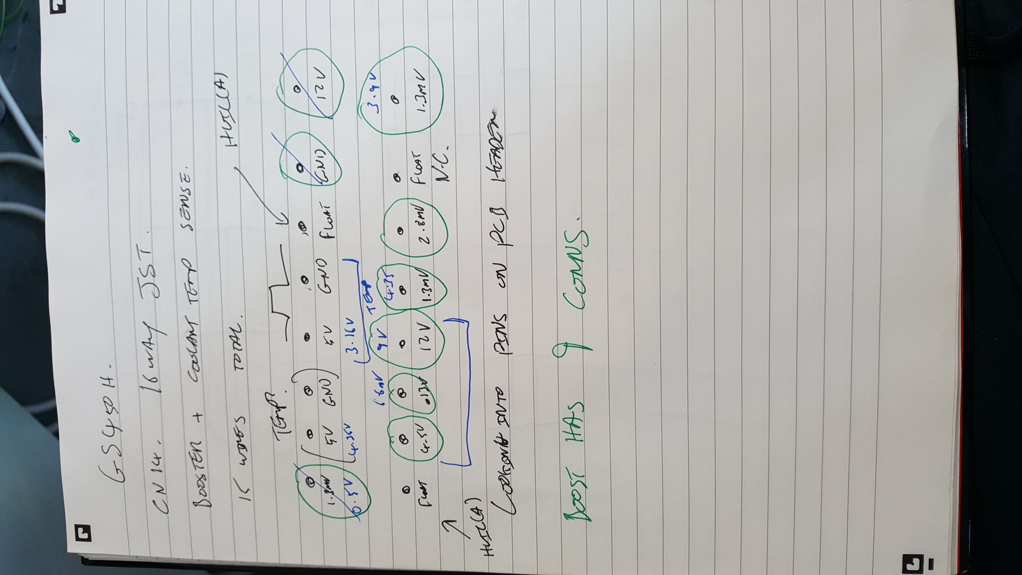

Re: Lexus Inverter Hacking
Here are some pictures from my notes. Please excuse my scribbles:) Will put something more sensible together asap.

We're going back in time a bit here, but following from this video:
How did you manage to enable the converter here? I've tried inputting PWM to what I believe to be the gate driver inputs of the converter PCB (the control board that lives in the converter housing), but I don't get a response. Do you have any info on this unit? Been pulling my hair out for 2 days so far on this!
Do you have any notes on the connections you made to this unit?
Yep I have notes and pictures. Give me a day or two and I'll post up here.
