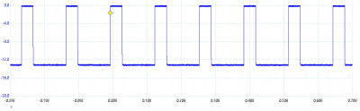

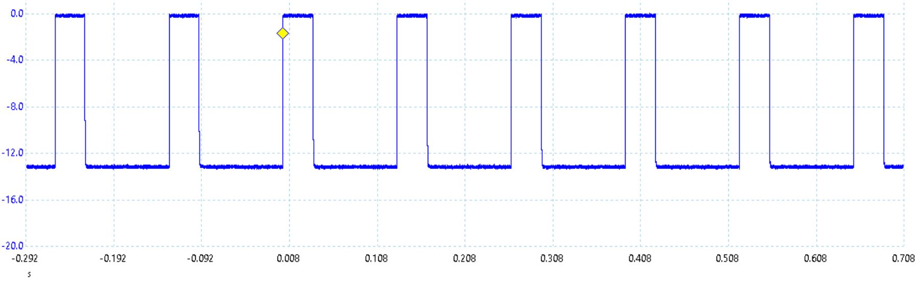

johnspark
Posts: 264
Has thanked: 59 times
Been thanked: 48 times
Re: Lexus Inverter Hacking
Post by johnspark »
i intend getting voltages off of the DC/DC connector off the side of the inverter when i get a chance with either voltmeters and or with a picoscope. I have a Toyota Camry Hybrid 2012 on the lawn to test with. Will submit oscillographs here when i can.
I have just picoscoped either NODD pin 21 or VLO pin 11 of Power Management Control ECU and got the following mark space oscillogram. I think i have the wrong polarity. I could not tell because i did this work when it was nearly dark. will try to get more waveforms in next few days.

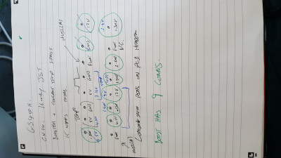

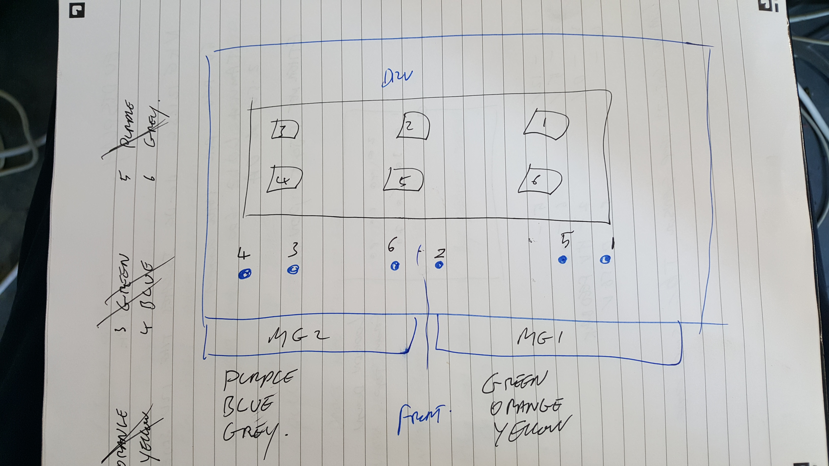

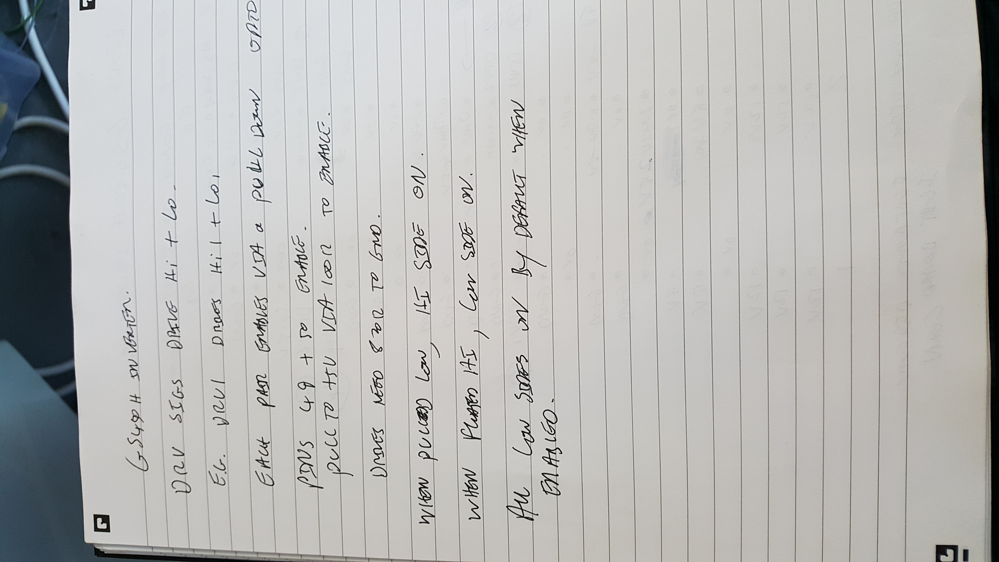

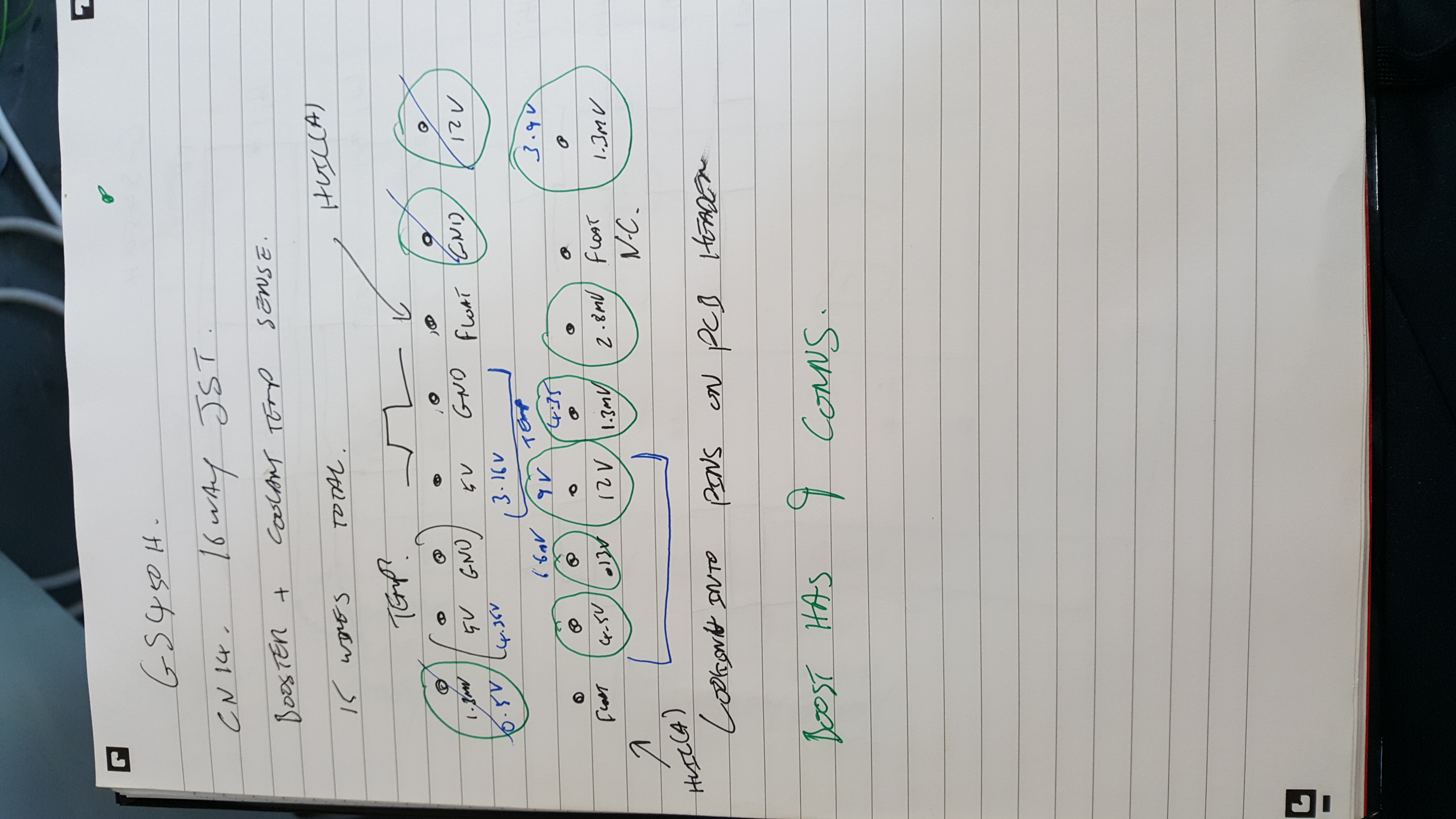

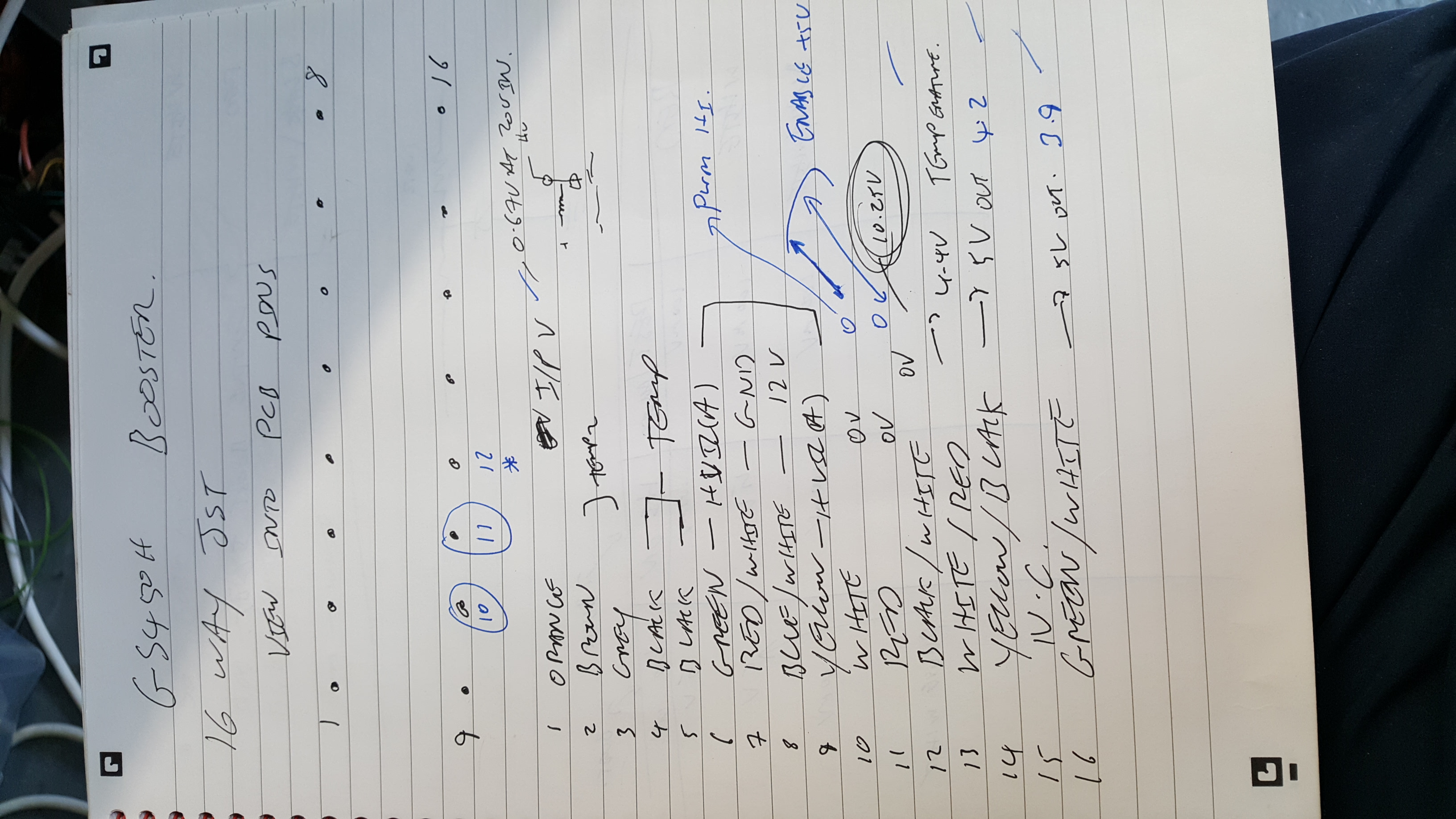

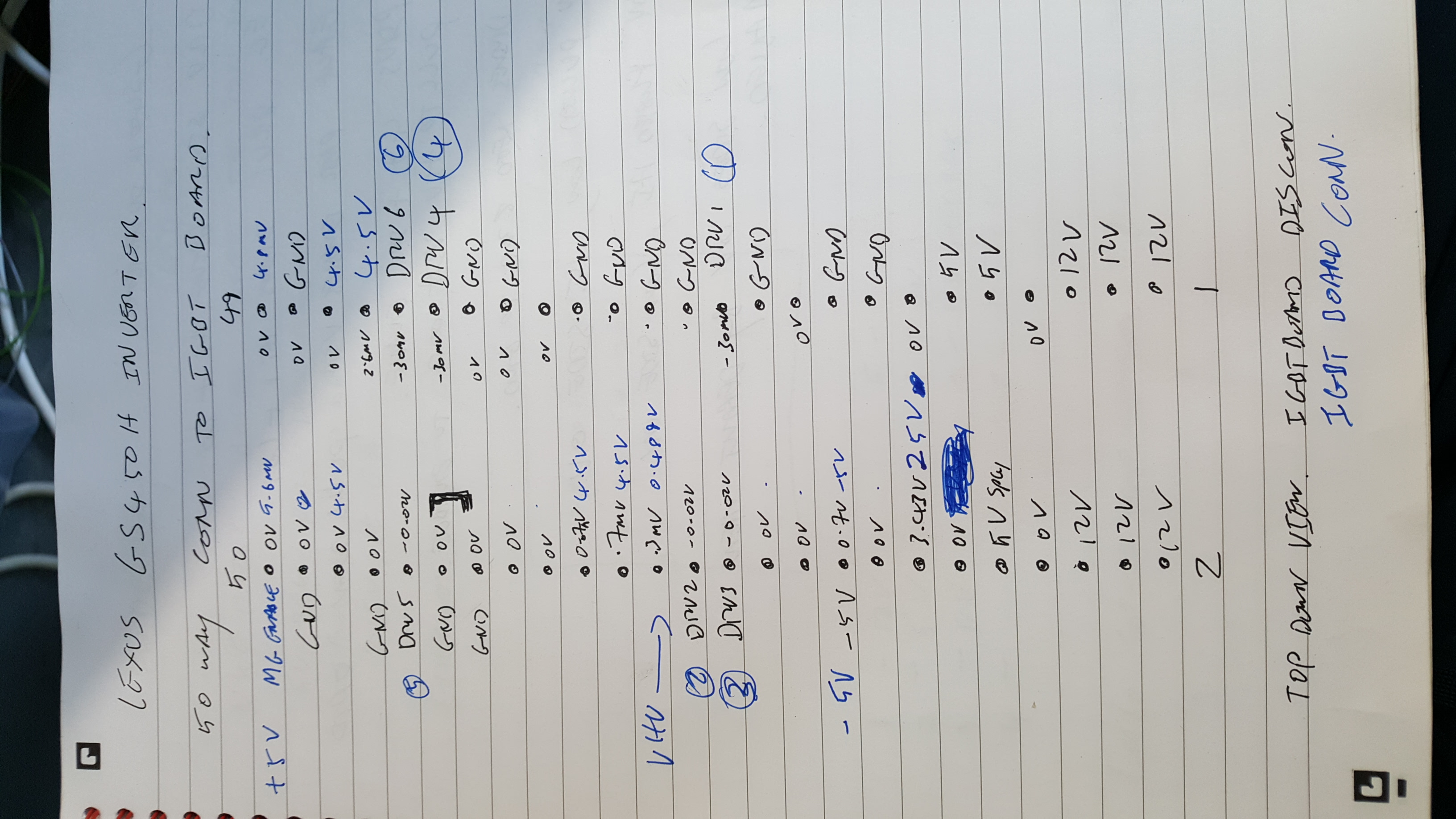

Posts: 4005
Been thanked: 1129 times
Here are some pictures from my notes. Please excuse my scribbles:) Will put something more sensible together asap.

We're going back in time a bit here, but following from this video:
How did you manage to enable the converter here? I've tried inputting PWM to what I believe to be the gate driver inputs of the converter PCB (the control board that lives in the converter housing), but I don't get a response. Do you have any info on this unit? Been pulling my hair out for 2 days so far on this!
Do you have any notes on the connections you made to this unit?
Posts: 4005
Yep I have notes and pictures. Give me a day or two and I'll post up here.
