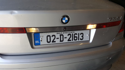

We have reversing lights:) Am I right in looking at message 0xA8 in that it has two bits that flip on press of the brake?

Jack Bauer wrote: Wed Mar 25, 2020 3:28 pm We have reversing lights:) Am I right in looking at message 0xA8 in that it has two bits that flip on press of the brake?
Glad I could help. :)
Two bits are taken into account to set the variable - ensuring the logic of the brake switch / test switch is all working correctly, and that's what sets v15...
  bn_can_send_temp_byte0 = (32 * v15) & 0xE0 | (bn_can_send_temp_byte0 & 0x1F);
...but only one bit actually gets set on the bus.
-Matt

/* Normal scenario?
Brakes off:
v3 = 1
v2 = 0
Brakes applied:
v3 = 0
v2 = 1
If brakes are off, I think it falls back to v15 = 2. So, actually, you're right, it's gonna be 2 bits. Test switch is gonna set 2, regular is gonna set 1..So if everything is working those two states should just flip...

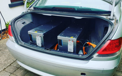

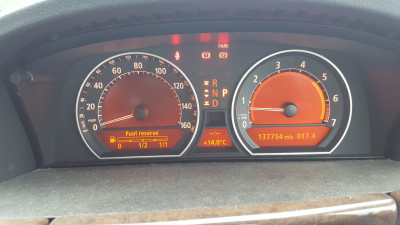

After a long absence the SuperYacht is back home. Drove today with the same crappy batteries but oh my god it is a BEAST! Clocked 90mph at 5500rpm on MG2 with the battery sagged to under 300v and it was still pulling!
Thanks to an amazing donation from a customer I have a 40kwh pack of Kokam cells that will be fitted soon.
