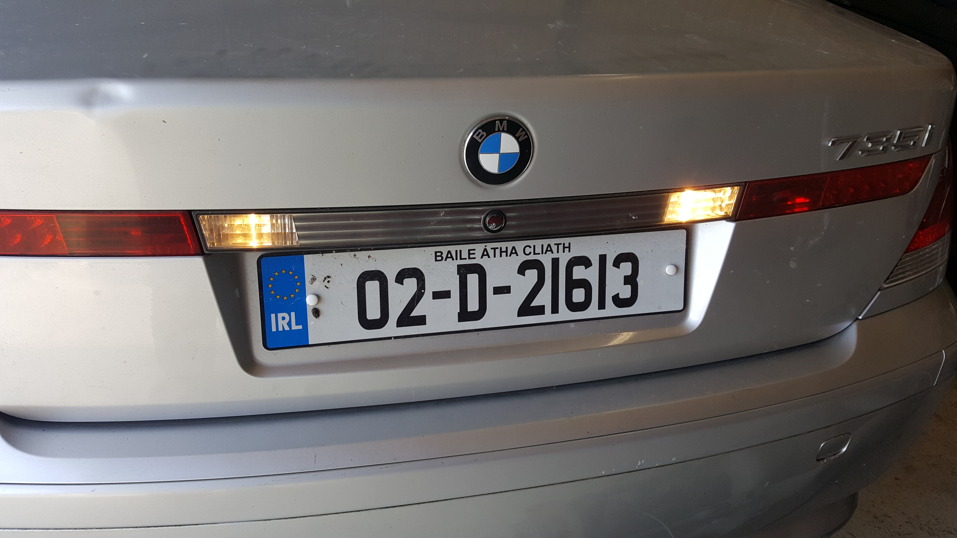

We have reversing lights:) Am I right in looking at message 0xA8 in that it has two bits that flip on press of the brake?

Jack Bauer wrote: Wed Mar 25, 2020 3:28 pm We have reversing lights:) Am I right in looking at message 0xA8 in that it has two bits that flip on press of the brake?
Glad I could help. :)
Two bits are taken into account to set the variable - ensuring the logic of the brake switch / test switch is all working correctly, and that's what sets v15...
  bn_can_send_temp_byte0 = (32 * v15) & 0xE0 | (bn_can_send_temp_byte0 & 0x1F);
...but only one bit actually gets set on the bus.
-Matt

/* Normal scenario?
Brakes off:
v3 = 1
v2 = 0
Brakes applied:
v3 = 0
v2 = 1
If brakes are off, I think it falls back to v15 = 2. So, actually, you're right, it's gonna be 2 bits. Test switch is gonna set 2, regular is gonna set 1..So if everything is working those two states should just flip...

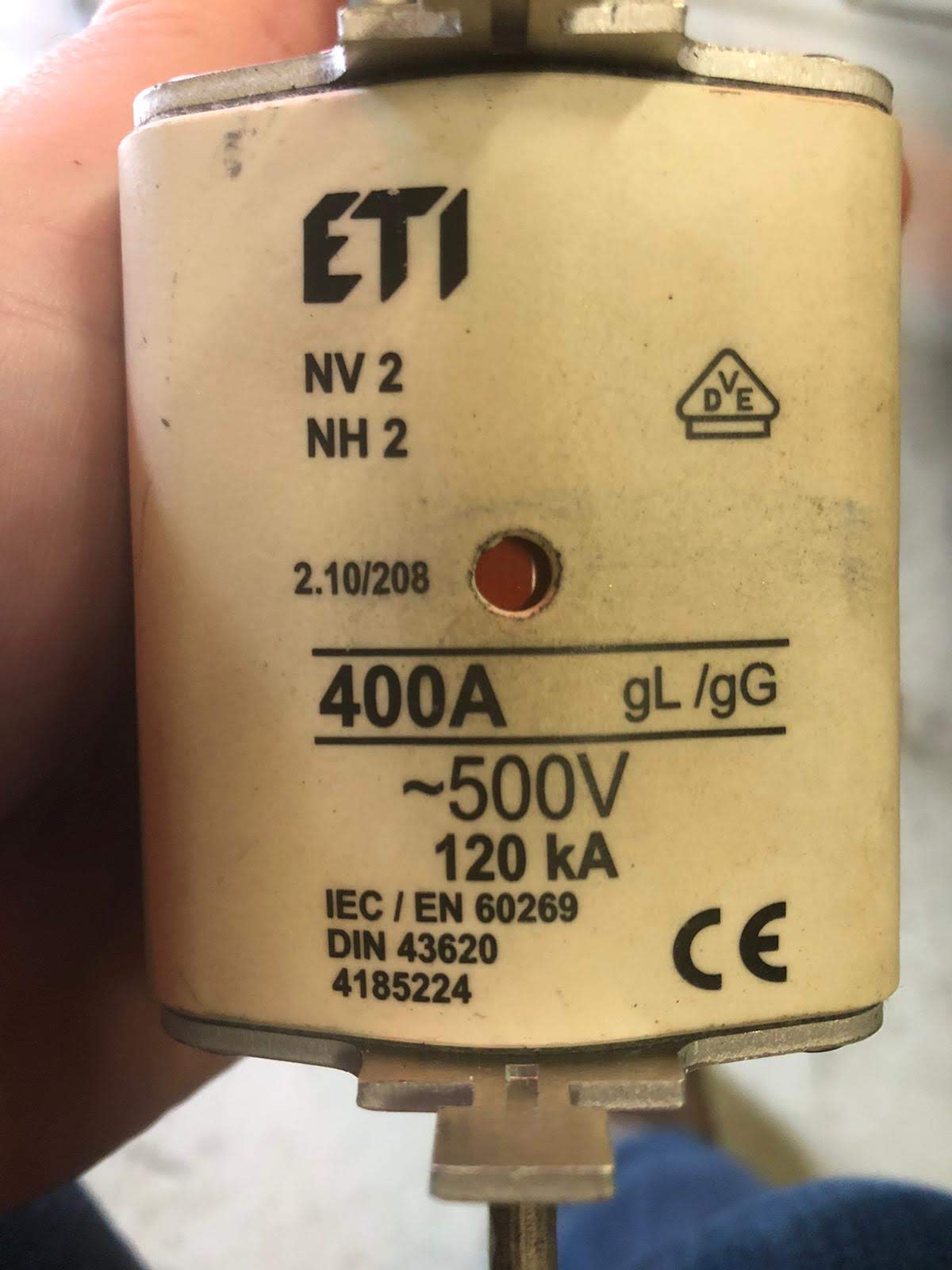

Kevin Sharpe wrote: Thu Feb 27, 2020 8:04 pm
mattndex@gmail.com wrote: Sun Feb 23, 2020 2:49 pm Is there a chance of you posting a schematic of how the high voltage junction box is wired.
The participants on next weeks course are building a HVJB for the Grey Goose project. It will be very similar to that used on BEXUS. I'll ask them to document the build and post details in that thread :)
What are AMP ratings on those fuses? Fast acting?

arturk wrote: Sat May 02, 2020 7:49 am What are AMP ratings on those fuses? Fast acting?
Damien tends to use whatever he has laying around... in the Grey Goose he fitted 400A main and 100A accessory fuses iirc.

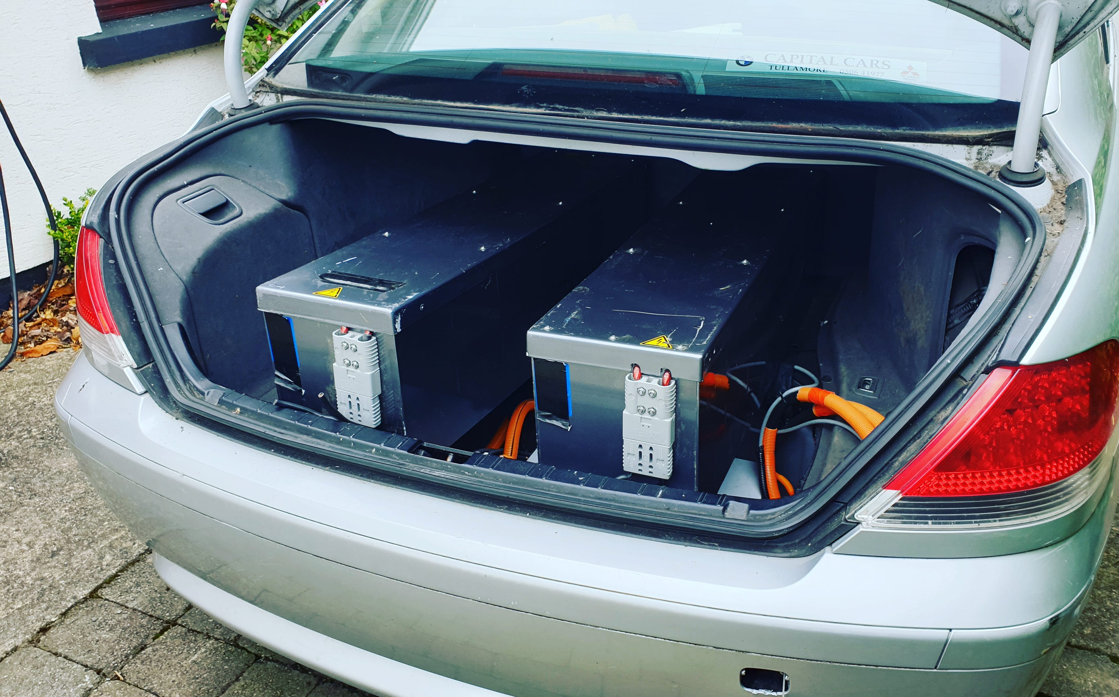

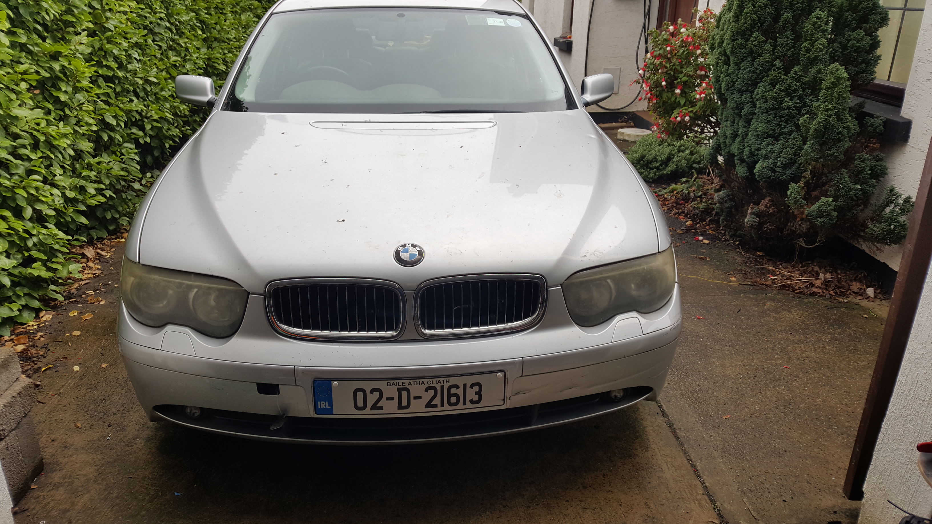

Re: The SuperYacht BMW E65 7 Series
After a long absence the SuperYacht is back home. Drove today with the same crappy batteries but oh my god it is a BEAST! Clocked 90mph at 5500rpm on MG2 with the battery sagged to under 300v and it was still pulling!
Thanks to an amazing donation from a customer I have a 40kwh pack of Kokam cells that will be fitted soon.

Post by JaniK »
Great to hear you get support in donation parts too :)
I have shown your cars to friends and they seem to be in disbelief that they are electric. But world is changing and soon DIY EV conversion can be as normal as ICE engine swaps. I am asked weekly about my leaf that: its not a hybrid? What, its only electric? Where can you go charge it? Well maybe in few years...
