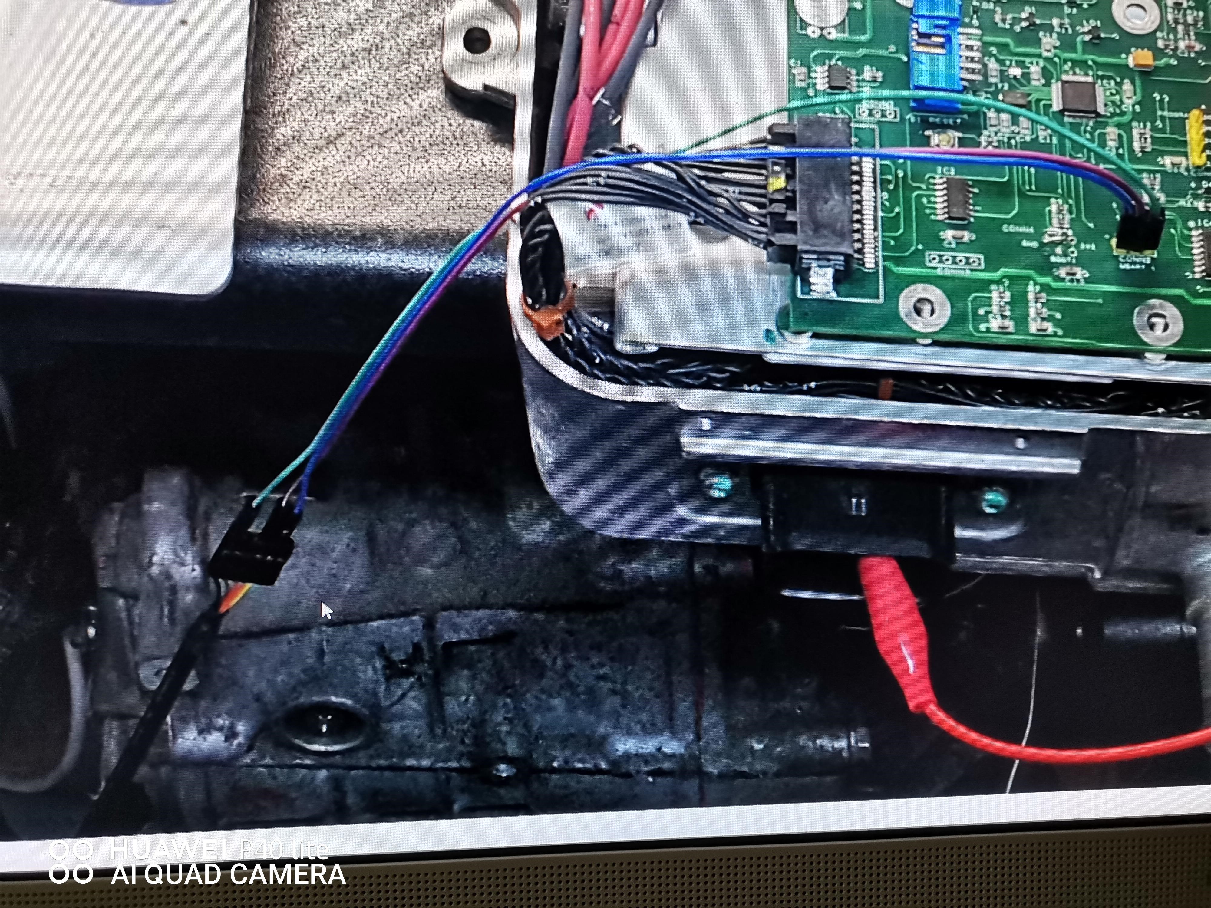

Can i ask if there is a software on the board or is it forbidden (only for developers)
and it means N O T !! Ok?

nesto1972 wrote: Mon May 25, 2020 11:04 am Can i ask if there is a software on the board or is it forbidden (only for developers)
A few people are working on the V5 software in their spare time (here)... hopefully they will get it working but for now V2/V3/V4 hardware/software is the most widely deployed and tested.

The boards are loaded with working software.

ok cool... is that the V5 software published on your GitHub in February?

Yes this is it here with the mods by Jon Volk and Tom. Working in Jon's car.

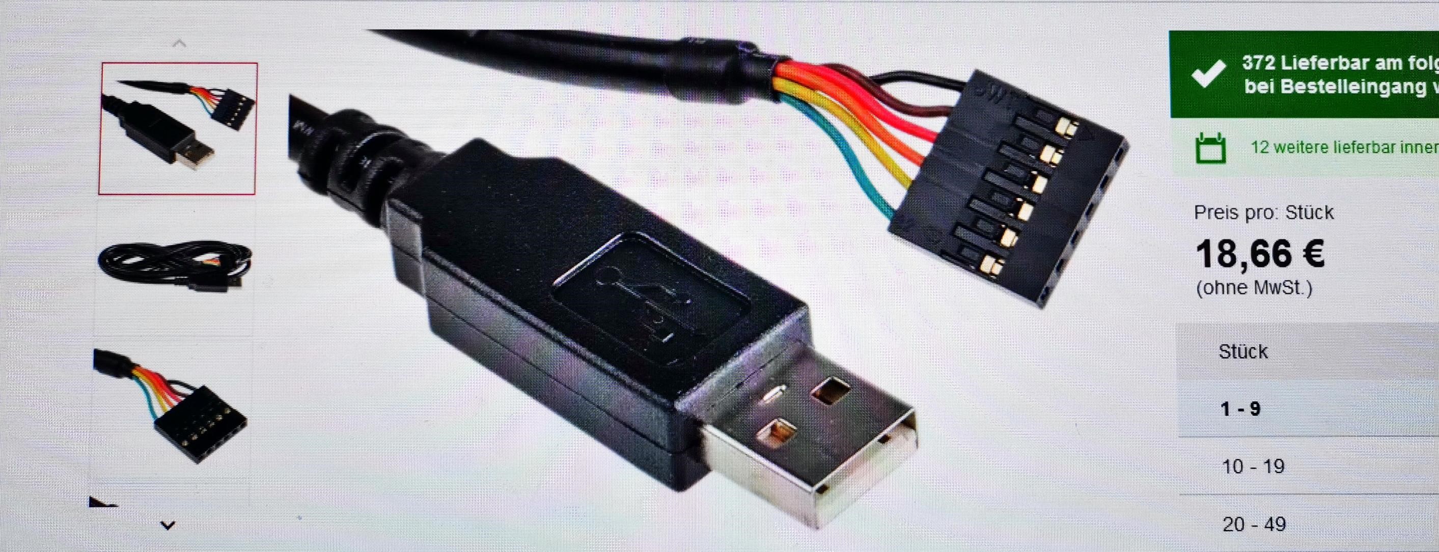

I found this picture from the cable for the Serial monitor !
Is that right ? TLL-232R-3V3?

Yep thats exactly what you need.
