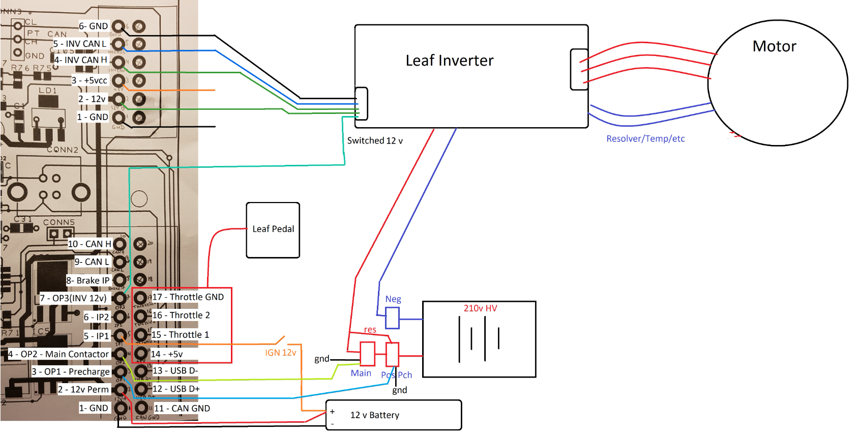

Here you go Kevin.
If you remember, I am using the Prius pack complete with precharge/main contactors and resistor. Gnd still goes to the 12v battery as it was during testing before moving to V1.5 of the firmware. The Pch and Main now go to OP 1 and 2 respectively.
I checked with James, and he also has his wired up his board pretty much similar and independently from mine, aside from him using Pin 1 instead of Pin 6 for his ground on the inverter vcu connector.
Edit: Previous image had CAN H and L flipped. Thanks JaniK for spotting;)

Cookie6000 wrote: Wed Apr 29, 2020 8:56 pm Here you go Kevin.
Thanks, I think I see the problem...
You are using OUT3 as if it's a switched 12V power supply for the inverter. However, OUT3 does *not* supply 12V it's a switched ground (see circuit below). My guess is you should power the inverter with 12V from your ignition switch and ignore OUT3.
Also note that unlike your drawing the inverter has three 12V pins according to this document;
http://productions.8dromeda.net/c55-lea ... tocol.html
You also have a similar issue with OUT1 and OUT2 driving your contactors. You should connect the contactors to 12V and the OUT1/OUT2 pins. The ground is switched by the NCV8401A devices;
https://www.onsemi.com/pub/Collateral/NCV8401-D.PDF
Let me know if this makes no sense :)
Edit: how are you controlling the negative contactor?

Cookie6000
Posts: 247
Location: Wicklow, IRL
Has thanked: 12 times
Been thanked: 33 times
Re: Leaf Gen 1 Inverter Board
Post by Cookie6000 »
That's brilliant Kevin, thanks for that detail!
All makes sense. That was my thought that the OP pins might not be supplying 12v, especially as I drew the schematic out. Ignoring OP3 is something I tried earlier in fact as you suggested. I connected the switched Inv 12v to the IGN but obviously, nothing else happened. The next step so is to just get the contactors to 12v as well as OP1 and 2.
On the neg contactor, ignore my diagram :D I left a bit out on the neg side.
Will switching the Inverter via the ignition and ignoring OP3 mean amending the code at all, removing it from the start sequence?

Appreciate the guidance here. Have a look at the latest rev and see if it makes sense. I think I have the inverter relay I added wrong. Should the gnd side I have in there actually be to 12v as do the contactors as the VCU controls switched ground?
Edit: CAN H and L flipped here in this image too, just so you know.

Cookie6000 wrote: Thu Apr 30, 2020 11:44 am I think I have the inverter relay I added wrong. Should the gnd side I have in there actually be to 12v as do the contactors as the VCU controls switched ground?
You are correct, the inverter power relay should be connected to the 12V not ground. One word of caution, I do not know whether this feature is used by Damien in the current software so this may not work.
We also need to check in the software whether the OP1 used to drive the precharge and negative contactors is active during operation or just precharge. Just try it and see what happens (I recommend you use a bulb or heater element current limiter for the HV when testing contactor operations).
In the future we need to add a kill switch and impact switch to your 12V circuit. We can address that once your system is working :)

Brilliant!
Success 8-) All connected up as in the schematic except I have the inverter switched 12v powered via the ign instead of OP3 and relay. Flick the switch, double click of Precharge and Neg contactors. Approx 1-2 seconds later, main contactor closes. Press pedal, and away the motor spins.
The question you had about OP1 and negative contactor during operation looks to stay closed. It does raise the question of the precharge contactor though and if it releases again or remains closed or does it matter.
Not receiving any Pack Voltage, Current or Power, just RPM and the motor and inverter temps but that should all be sorted hopefully when I get the ISA shunt in. But that's for another day :D
Thanks again Kevin. Has helped to get another bit further down the line for my own build as well as James' project Figleaf :)

Kevin Sharpe wrote: Thu Apr 30, 2020 10:11 pm No problem, well done for sticking with it... all I ask is that in future you and James update the wiki so that people can help themselves 8-)
I've started a wiki page for the VCU and ISA Shunt :)
https://openinverter.org/wiki/Nissan_Leaf_VCU
https://openinverter.org/wiki/Isabellen ... te_Heusler

Kevin Sharpe
Posts: 1339
Location: Ireland and US
Been thanked: 8 times
Post by Kevin Sharpe »
Cookie6000 wrote: Fri May 01, 2020 8:25 pm Great.
I have a lot of info noted down I just need to collate together in legible form and can submit it then for future reference
Cool! If I get a moment i'll draw up a schematic for the VCU/Inverter/Contactors :)
Kevin Sharpe wrote: Thu Apr 30, 2020 10:11 pm It's not unusual to drive both the Negative and Precharge contactors with the same control signal.
On reflection I think it's more likely that Damien intends the negative contactor to be switched by the ignition switch (which is how I think James has it wired).
