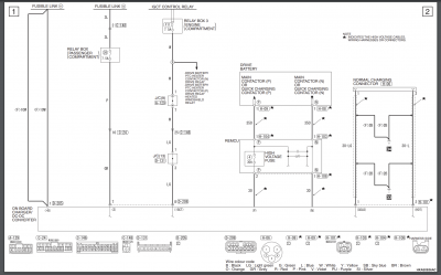

Re: Mitsubishi outlander charger and DC:DC
Help please,
I have an Outlander charger which I am using with a zombieverter and a GS450h. I am trying to communicate with the charger using an arduino Due. I have a moving car but my batteries are going to run down soon.
The charger was purchased a while ago before I knew that Damien was investigating VW chargers. I do not have the skills to get the Outlander charger to work. I do not want to use a leaf charger as it is to large to fit into my car. Also I am unsure as to how long the VW chargers will take to be functional.
I have read all of the info on the forum but I can't see a wiring diagram anywhere. I understand the DC/DC wiring but have not connected it in yet. I have tried to figure out the wiring from the wiki and from Arber333's github code.
I am assuming that the pins mentioned in the code are the Due pin numbers but that is as far as I can get.
Any help would be greatly appreciated.

- aot93
- Posts: 213
- Location: UK, West Sussex
- Has thanked: 8 times
- Been thanked: 49 times
What sort of wiring diagram are you looking for?
I've posted the OEM wiring diagrams only a few posts up.
The Wiki page also has all the relevant info.
If you want to see an example of how I installed the charger in my conversion my diagrams are here:
https://oshwlab.com/aot93/mini-e-wiring
this is the relevant part:
- Posts: 3795
- Has thanked: 166 times
- Been thanked: 411 times
I am sure you are capable enough to make it start. Considering you already put your car together...dadiowe wrote: ↑Sat Nov 26, 2022 10:09 am Help please,
Outlander wiring diagram is on this thread, second post or maybe this one https://openinverter.org/forum/viewtopi ... 8566#p8566
Well the thing is DCDC and charger are one unit. They use single CAN control unit both. Also you need to connect 12V battery to DCDC for more comfortable experiments. Your 12V GND needs to be connected to charger case!
Also have HV connected to charger. I think the lower limit is 200Vdc, the upper is 400Vdc.
1. connect pin10 to GND
2. You supply wire on pin7 to 12V battery positive terminal to sense DCDC output.
3. Connect pin4 to 12V to start DCDC
This makes DCDC to turn on. No need for CAN bus
To get charger to work you need a combination of specific CAN telegrams
4. connect Pin8 to 12V to start charger logic
5. Provide a CP signal - 1kHz PWM at 25% duty - to Pin9. Normaly you just connect EVSE CP line here.

Thank you guys for your help. I now have a basic charge system working.
Having re-read my post I can see that I did not make it clear that the pin connections I was unsure of were to the Arduino Due Shield
