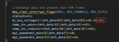

Bigpie wrote: Sun Jun 30, 2024 2:05 pm Is that spreadsheet using my data?
That seems to be working mostly, the bus voltage is about x2 what it should be
Yes that's your data.
Bus voltage gets divided by 2

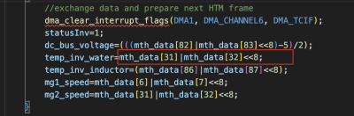

To test if the speed is coming into the ZombieVerter correctly, try and write it to the temperature

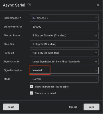

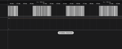

Re: GS450h RPM feedback always 0
Hi Jamie
The data seems to be corrupted.
With my cheap logic analyser, it only worked properly if I capture one channel at a time. MTH example below
Syncserial settings:

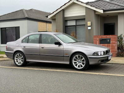

Re: [DRIVING] BMW e39 IS300h inverter GS450h Transmission
Zechy wrote: Tue Jun 04, 2024 11:14 am 1998 BMW 528i (pre CAN bus)
IS300h Inverter
GS450h Transmission
Outlander onboard charger
Outlander aircon compressor
Bespoke 20 kWh battery
This is what it used to look like before the 6 series wheels and clear turn signal lenses

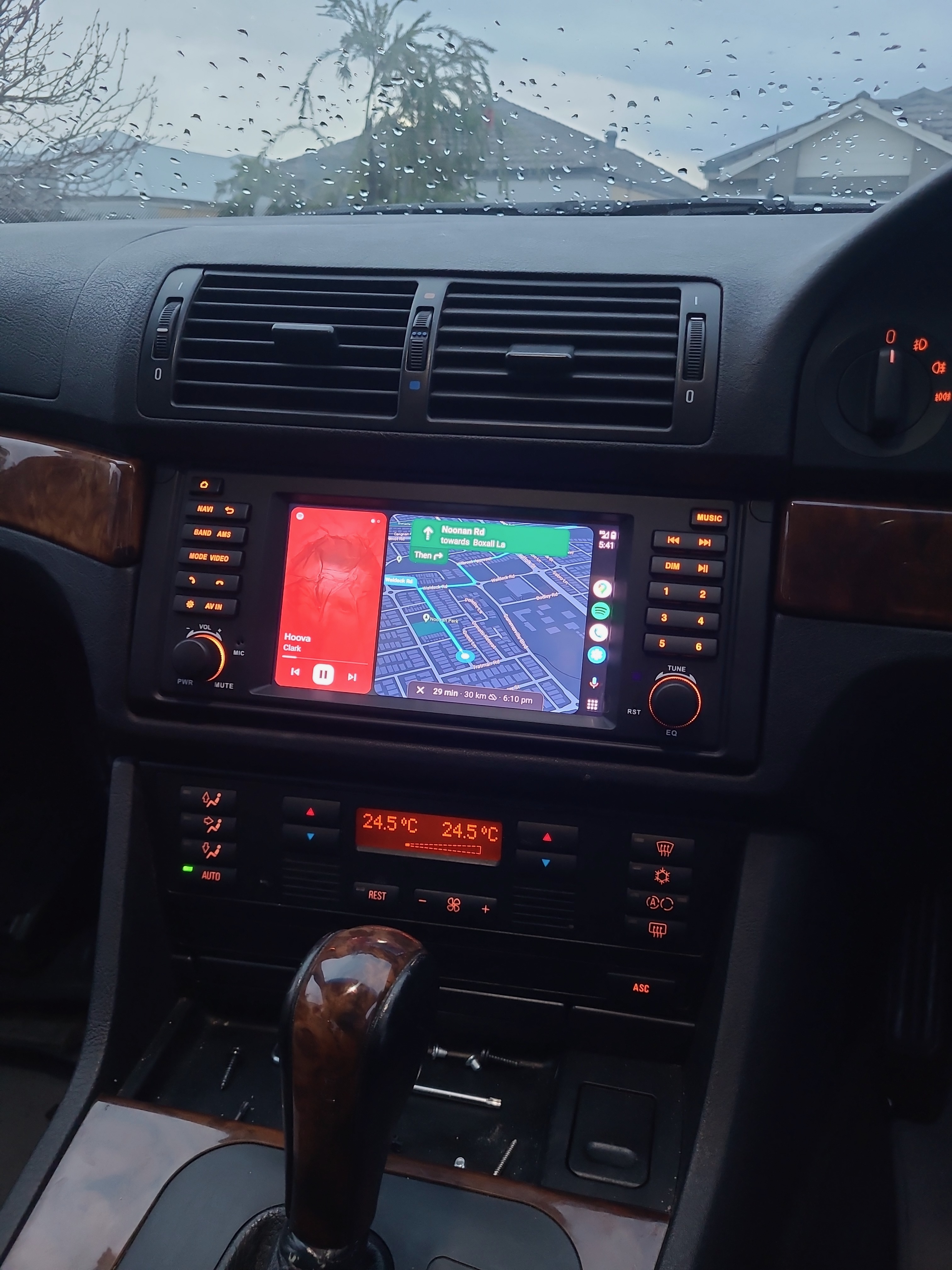

Wireless Android Auto and CarPlay. Eonon head unit with reversing camera. The radio controls on the steering wheel even works.

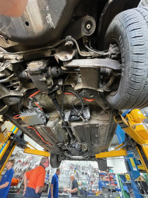

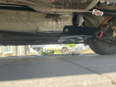

The Outlander charger lives where the left fuel tank used to be.
On the right is the motorbike radiator and pump for cooling the charger.
The radiator now has a polycarbonate shield
