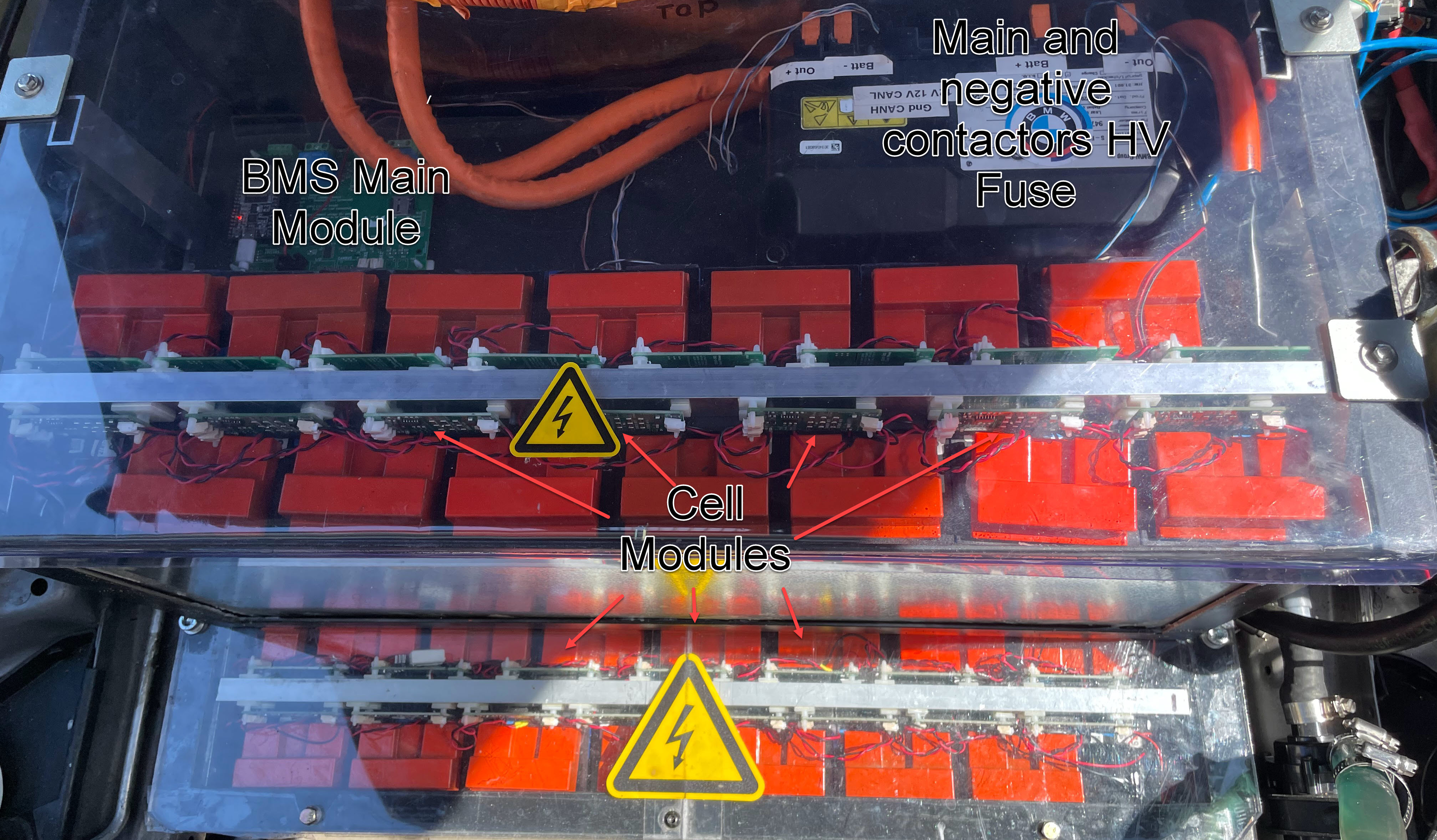

When I started building the car I couldn't find any BMW HV battery modules in Perth Australia
I decided to make my own battery pack.
I ended up with 85 x 65Ah NMC cells from Alibaba
For BMS I used DIYBMS the open source project by Stuart Pittaway.
This was by far the most difficult part of the process.
I still need to implement cooling. But for now, in town driving it's not problem.

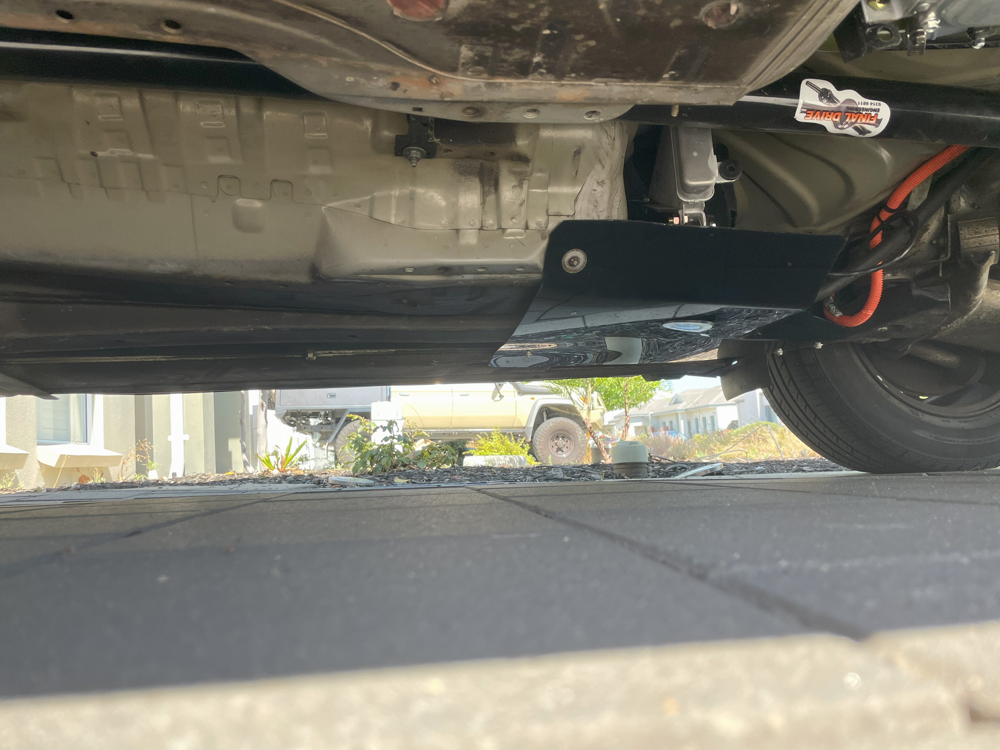

The Outlander charger lives where the left fuel tank used to be.
On the right is the motorbike radiator and pump for cooling the charger.
The radiator now has a polycarbonate shield
