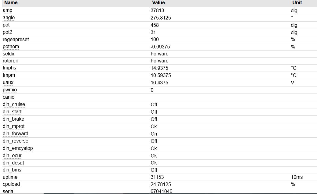

Re: Potnom not rising above 15%
I wonder if it gets caught on udcmin. It is set to 0 and udc is 2, quite close to the derating point. Can you try applying a small DC voltage, like 12V or so?
That appears to be the fix. I tried 12V, potnum now does range much better (but only up to 70%). I will experiment with potmax, it's ...

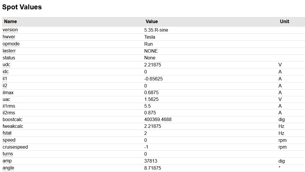

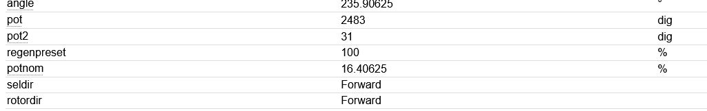

I get the same behaviour whether the direction is set to forward, reverse, or neutral (not sure if potnum should vary whilst in neutral). I post the spot values here (throttle not pressed):
and this snippet when throttle fully pressed:
Hi, I am bench testing an SDU drop in board. It is v9, running 5.35 R sine release.
I am using an i3 pedal, single channel mode. I can see 'pot' varying between about 450 and 2480, I have set potmin and potmax accordingly but potnum never gets over about 15%. I have no DC attached to the motor and ...
