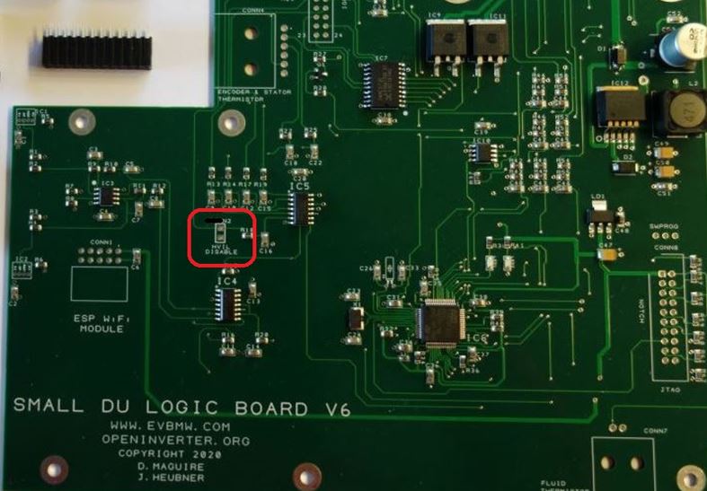

Try bridging the interlock (HVIL). Theres a jumper link provided on board

Hello Johannes, thanks for the tip. Unfortunately I didn’t fully understand it and couldn’t find any information about it. Do I need to take the SDU apart and remove a jumper on the board?
Been thanked: 1913 times
Re: SDU Board error message overcurrent
Yes you need to take it apart and ADD a jumper link where it says HVIL DISABLE.

Thanks, I found it. It’ll be some work, but I hope the engine runs again.

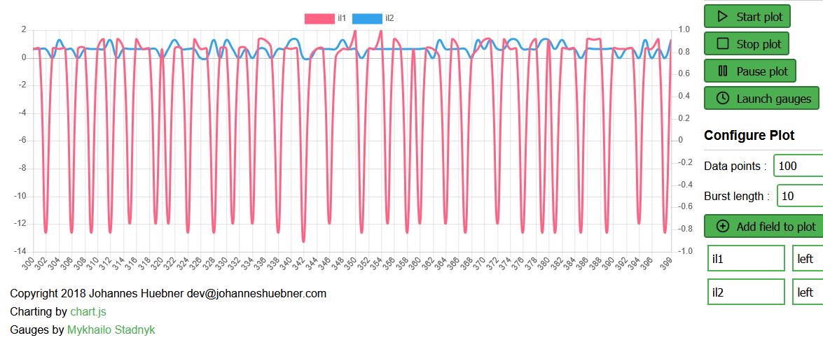

Hi, I am testing a v9 SDU board before installing it into the inverter itself. I tested basic funcs - so turning on with 12V, connecting via CAN to the ESP32 web interface and simple throttle pedal, but no current sensors soldered in or any HV. I used params as supplied. I had to set udcmin to 0 and cruisemode to off and then I was able to get opmode to RUN by doing ign start. Spot values were showing udc to be c. 196V even though no HV connected.
However, it went straight to OVERCURRENT.
I assumed that was because I had no current sensors so I soldered new Melexis ones and repeated but get same error. However I noticed this time that il1 was oscillating between 0 and 14A, and il2 between 0-2A (from memory). I reflowed the current sensors and tried again, and this time I had same behaviour but il1 oscillating beween 0 and minus 14, il2 the same. Screenshot and param file attached.
The behaviour of il1 and il2 being so different make me think there is something wrong but I wanted to check in case the above is normal?
params_20260104.json
(1.41 KiB) Downloaded 3 times
HV Interlock would also result in OVERC message. Bridge it with the jumper
il1 is a but shaky indeed, have you modified il1gain at some point?

So, I bridged the HVIL disable but am having the same issue with immediate OVERCURRENT and odd values from one current sensor. Board is not connected to any HV or the power stage of the inverter.
I did some measuring on the board, using the v6 schematic as a guide although the board is v9 and I don't know what the differences are.
both current sensors getting 4.93V and reading 2.46V at output.
IL1_21 at R10/C5 = 1.682
IL2_26 at R12/C8 = 1.682
IL1_IN at R1/R2 = 2.46V
IL2_IN at R3/R4 = 2.46V
on IC4, pins 5,7, 8 ,10 = 1.682,
pins 1,2,13,14 = 3.723
pins 4 and 6 = 0.206 ?OCURLIM_NEG_59
pins 11 and 9 = 3.1 ?OCURLIM_POS_61
on IC5, low on pins 1,2,4,5
pin 3 = 3.73
pin 6 = 4.9V
pin 8 = 4.9V
pins 11,12 4.9V
13/14 = 4.9V
The fault A, B, C are all low so the PWM_Inhibit is being set high, and maybe that turns into an overcurrent error in the software, but at this point I am guessing. The current sensors seem to be OK though so I don't understand why the IL1 and IL2 are so different. I am at a bit of a loss.
I can't seem to get the the commands to work in the web interface either - I wanted to check IL1 and 2 gains as those values are not exposed. Any help there too would be gratefully received.
