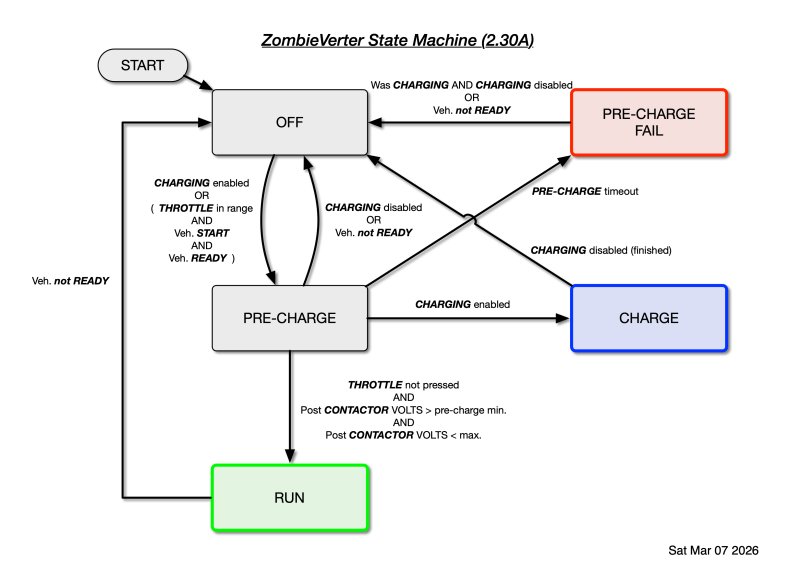

Operating Mode State Machine
The main vehicle operating mode is run from a 10ms timer (derived from the 1ms hardware timer). The vehicle states are:
  • MOD_OFF
  • MOD_PRECHARGE
  • MOD_PCHFAIL
  • MOD_CHARGE
  • MOD_RUN
The state transitions follow the state diagram overview shown below (this is an overview and not meant to describe some of the intricacies of the software flow).
ZombieVerter firmware Operating Mode state machine overview
