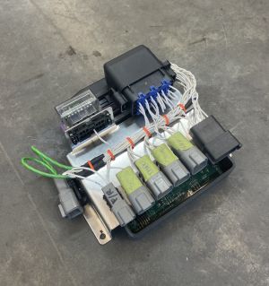

Pre-wired zombieverter interface
the core ev control system across different builds is majorly the same:
- throttle input
- start/fwd/rev input
- contactor control
- inverter control
- charger control
- bms interface
- gauges/displays/data
why build custom wiring harness when we can standardized the main system with a pre wired ev system interface for the zombiverter vcu
hence the "pre wired zombie interface"
consolidating the zombieverter VCU, ev 12v power distribution(fuse, relays, grounds), CAN BUS lines, along with the fundamental inputs and outputs
hardware:
- metal tray acts as a base for everything to mount to
- zombieverter VCU is enclosed in a custom 3d printed case
- OBD-ii port
- little fuse 18pin pdm enclosure with Metri-Pack 280 pins
- deutsch connectors
The little fuse pdm enclosure houses 2 relays and 5 fuses:
- switch 12v ign relay + fuse
- generic output relay + fuse
- zombieverter 12v supply fuse
- inverter 12v supply fuse
- charger/bms 12v supply fuse
the OBD-ii port is on the zombieverters transmits data only:
- CANBUS 2
- 12v+
- GND -
