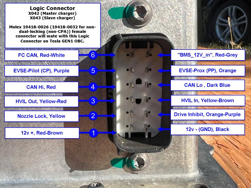

Tesla Model S GEN1 OBC logic connector, 12-pin.
current17:30, 1 March 2023Thumbnail for version as of 17:30, 1 March 20231,600 × 1,200 (532 KB)Asavage (talk | contribs)Added pin labels, functions, and OEM wire colors for 2012 Tesla Model S.
