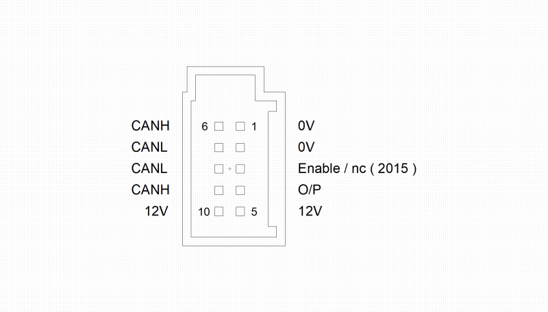

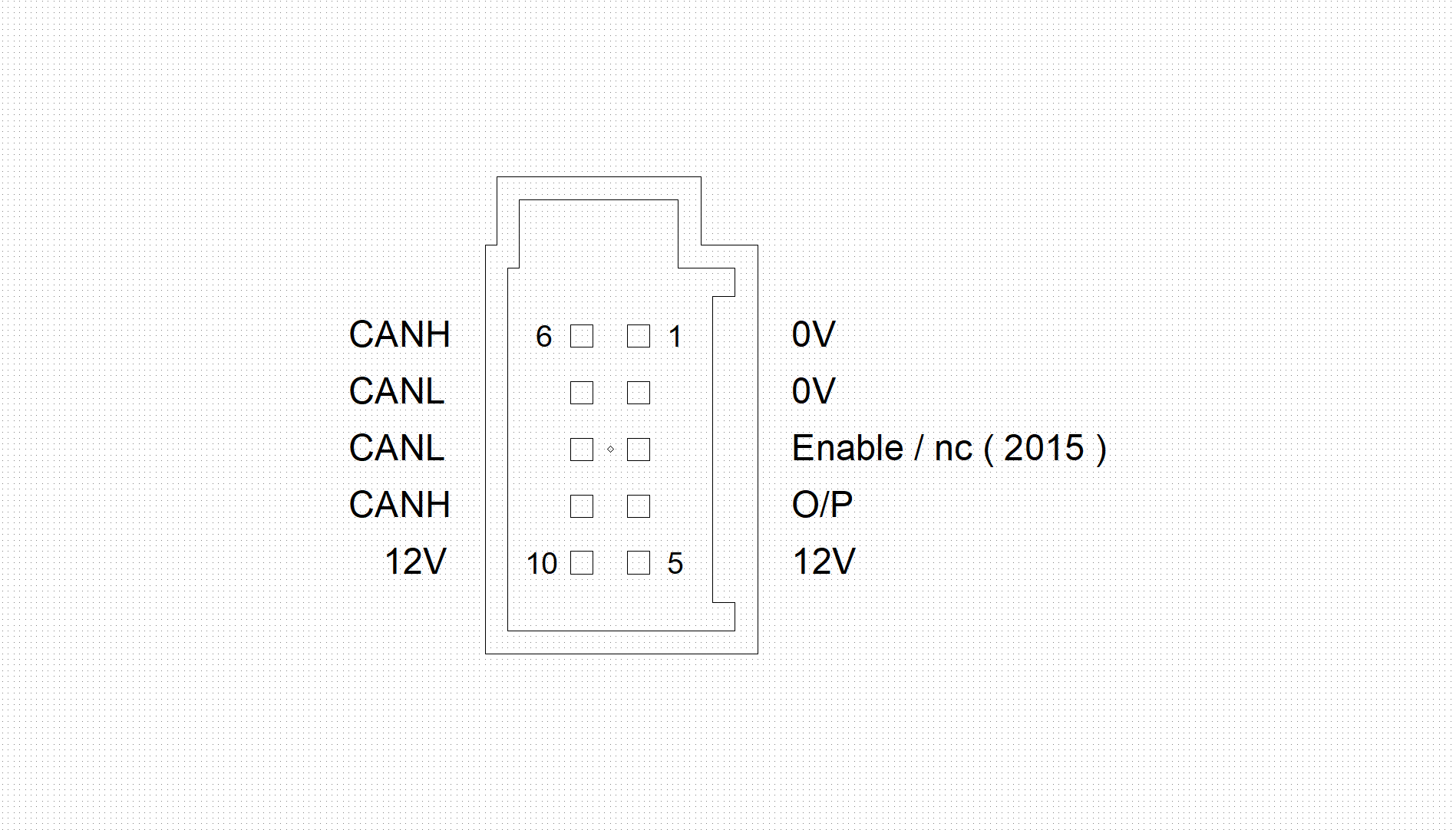

Connector pinout for VW GTE battery module. O/P on pin 4 is possibly an enable out. Multiple CAN and supply pins allow for daisy chaining battery modules.
