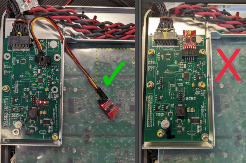

File:Esp8266 debugging help.png
Revision as of 12:28, 29 April 2022 by Janosch (talk | contribs)
Original file (1,398 × 928 pixels, file size: 675 KB, MIME type: image/png)
Try connecting the ESP8266 to the Tesla Logic Board with DuPont cables to rule out dodgy plug & connector combo
