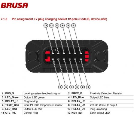

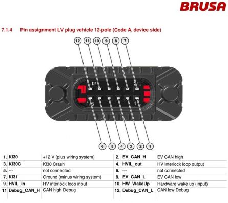

There are two LV data connectors are two 12 pin connectors. Based on data from the Brusa technical manual, one if for power and comms with the vehicle, and the other has connections to the charging port. Not all pins may be used on every Mercedes OBC model.
Mercedes Brusa LV Pinout A
Mercedes Brusa LV Pinout B
