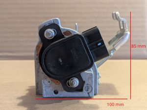

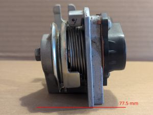

A better image would be nice, but this is what the sensor looks like
The original cable is shielded to avoid interference from other sources and resulting unwanted acceleration or deceleration.

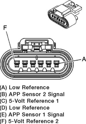

Honda accelerator pedal sensor connector pinout[1]

UK spec versions have different pinout.
When connected correctly sensor 1 is half the scale of sensor 2, fully pressed yielded max values of 1432 for Pot1 and 2980 for Pot2 on a v3 mini mainboard.
Pinout of UK Spec Accord / CRV APP (P/N TBC)
Connector Pin A B C D E F
Function 5V REF 1 GND 1 SIG 1 SIG 2 5V REF 2 GND 2
(In OEM application pins E and F are swapped, giving SIG 2 an inverted output, this isn't compatible with open inverter so a pin swap is needed)

Side view, P/N 37971-RCA-A01 (Honda Element)

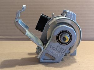

Side view 2, P/N 37971-RCA-A01 (Honda Element)

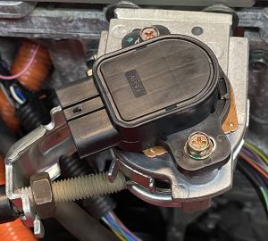

Rear view, P/N 37971-RCA-A01 (Honda Element)
Underside, P/N 37971-RCA-A01 (Honda Element)

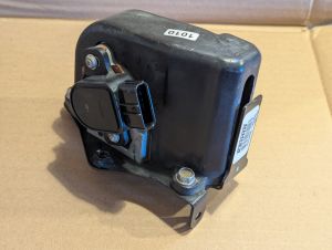

With cover and bracket, P/N 37971-RCA-A01 (Honda Element)

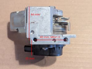

3D scan of bracket, sensor, and cover
CAD model
