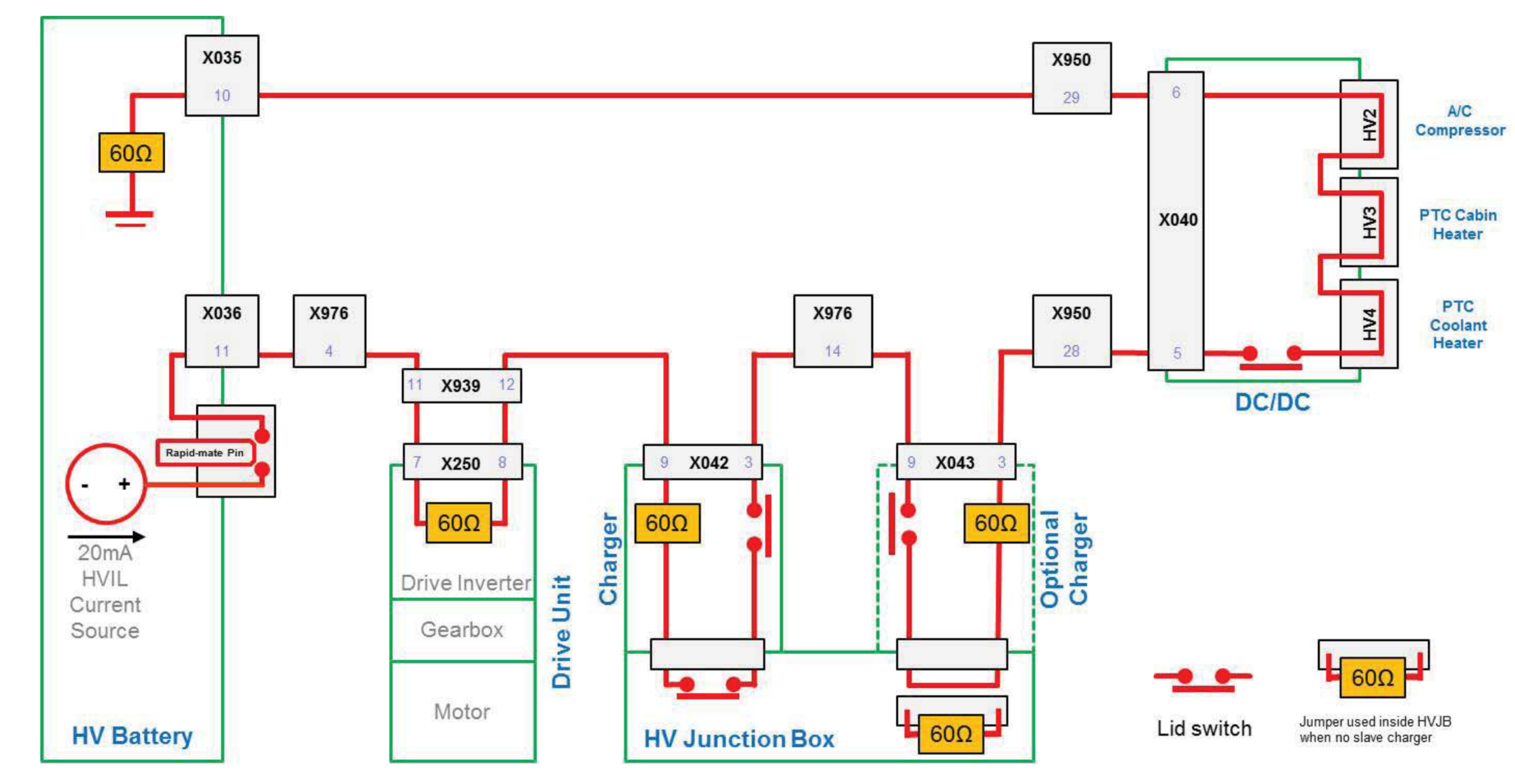

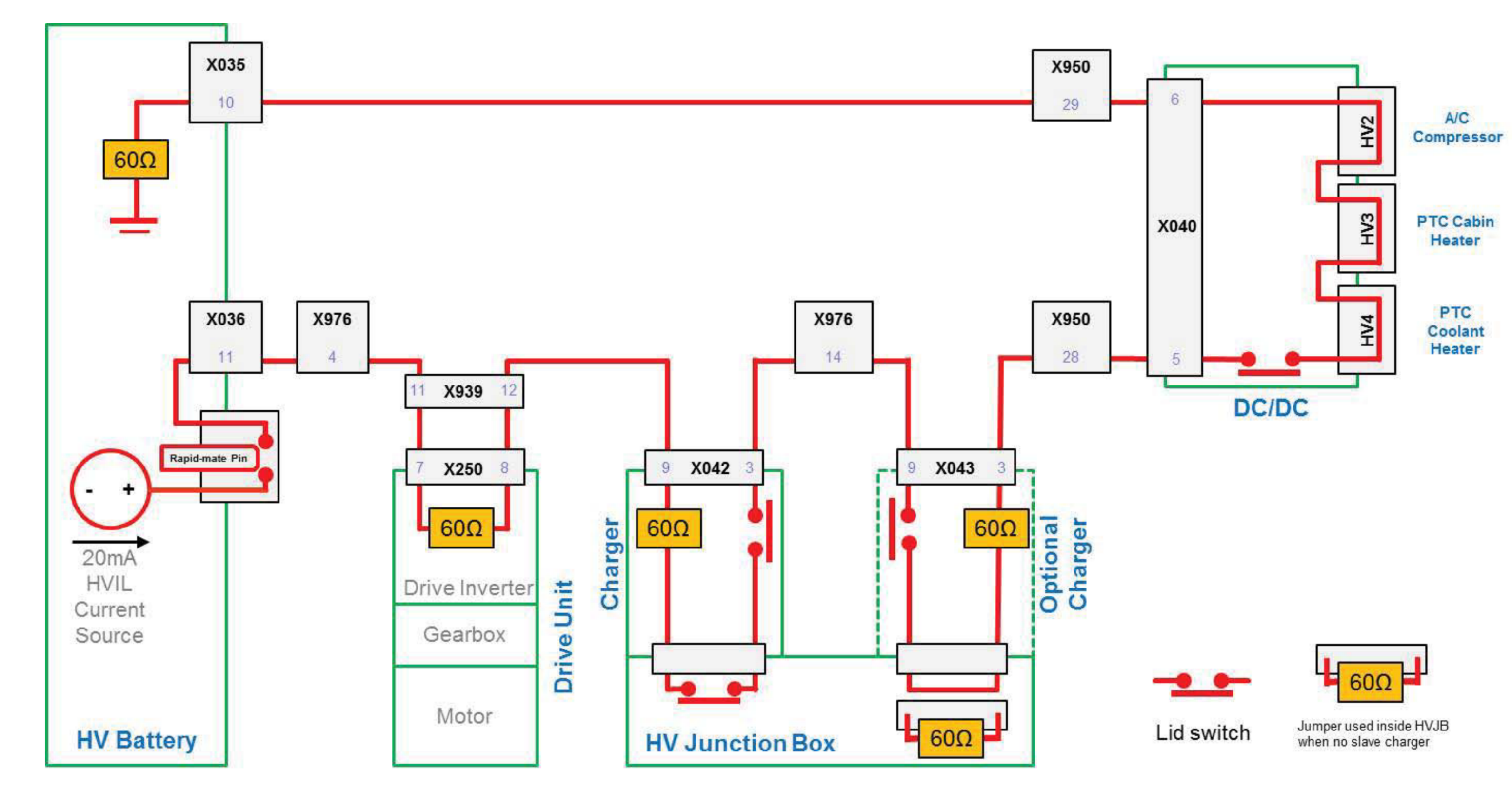

Tesla Model S GEN1 HVIL circuit overview, from Tesla Service Bulletin SB-10052449-4313, pg. 10.
