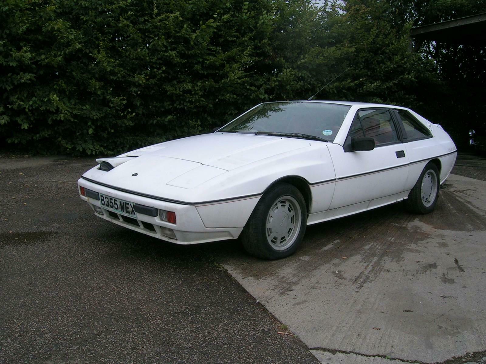

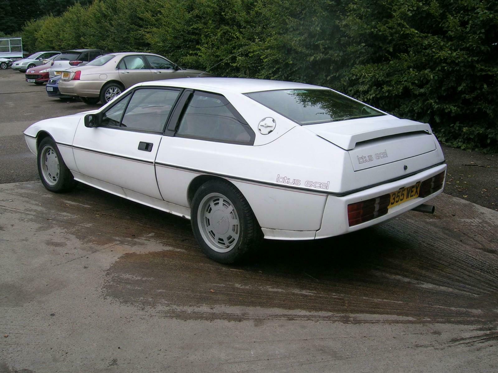

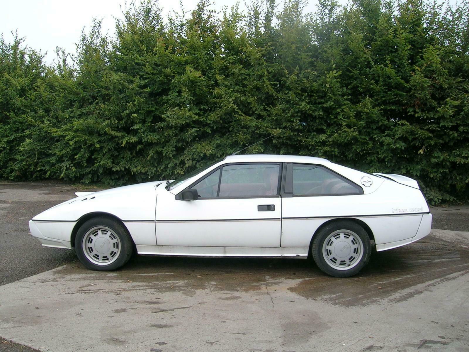

Delivered today, yet another project. Lots of work needed!
Thinking GS300H gearbox as the 450H is probably too big to fit into the backbone.

The 1985 Excel is actually lighter than the same year Esprit and has also four seats, rather than two. It's also a lot cheaper, so although I would have liked to do an Esprit, I think the Excel may be a better choice.
I'm now leaning more towards a Leaf motor onto the original gearbox. The Lotus's 4.1 rear diff poses gearing problems compared to the 2.764 of the 300h and drop in alternatives ratios are limited. It's a Toyota Supra derived unit with a uniquely Lotus mounting arrangement.

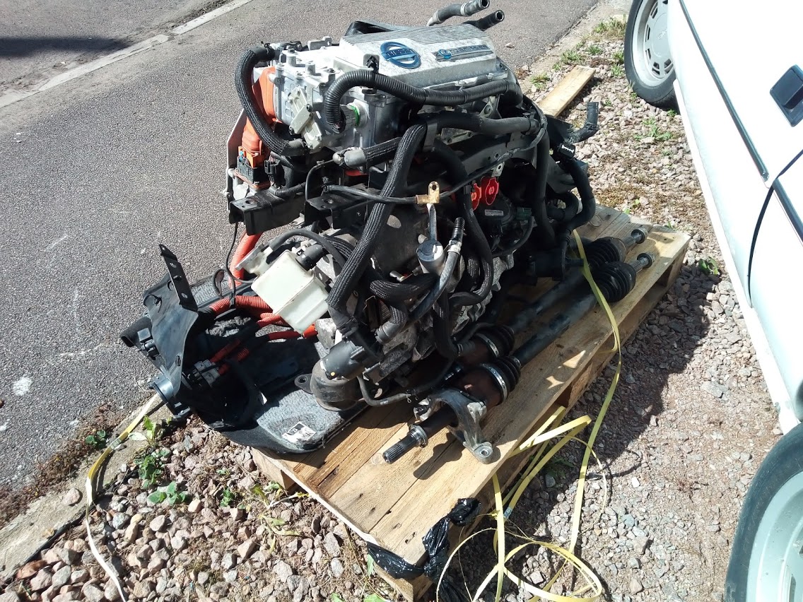

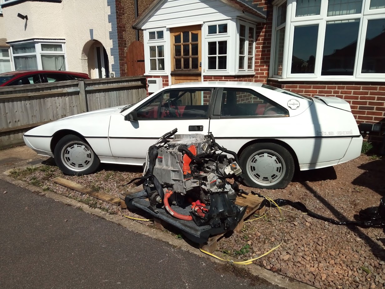

Leaf meets Lotus.

Re: Lotus Excel
Really nice conversion.
With a small weight of that car and power/torque of the Leaf motor i think you better install some wings on that car.
I do think the suspension is really good so this will have some great cornering capability.

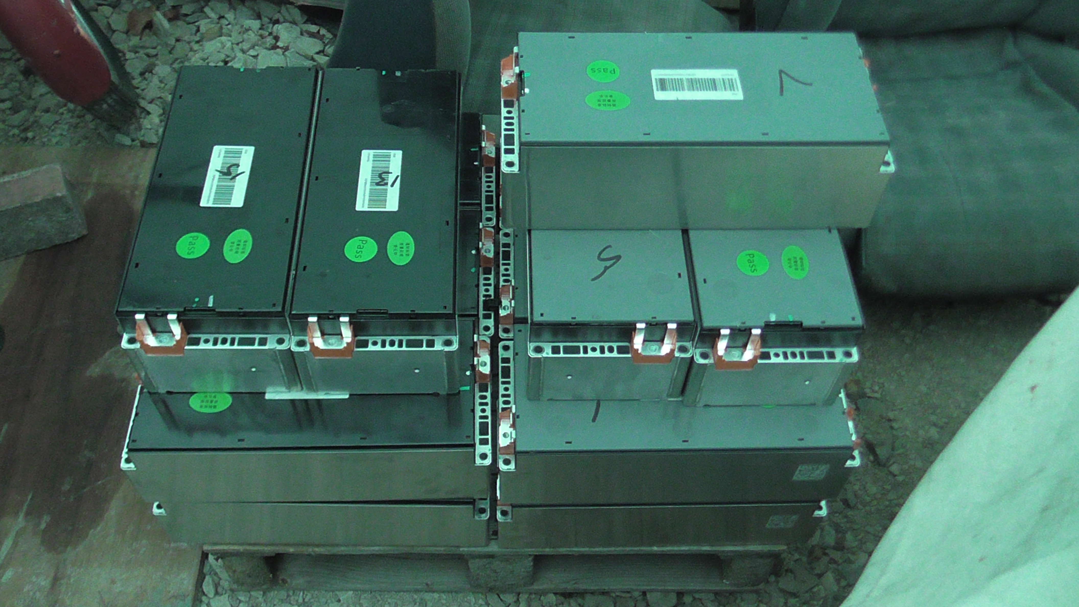

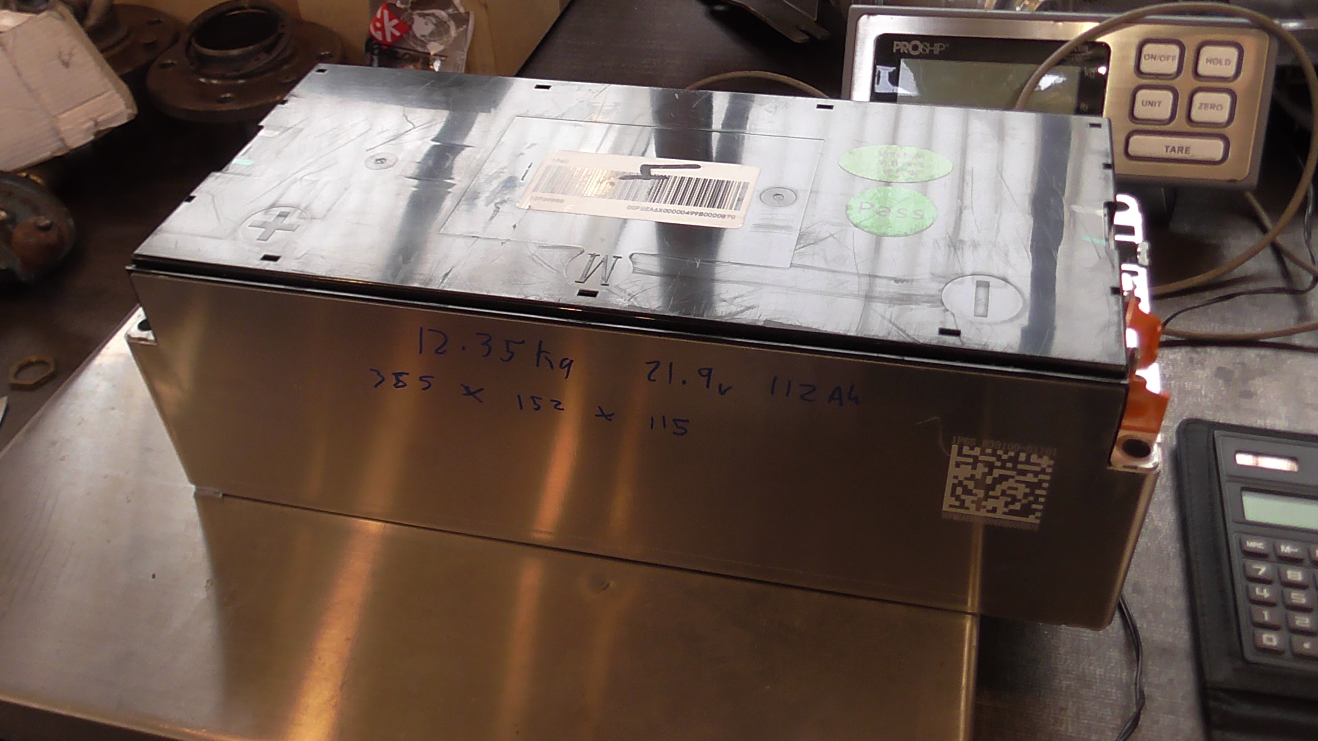

OK, time for a battery upgrade.
But you haven't started on this one yet!
I know, but I couldn't resist.
18 off CALB modules, 6S1P, ~112Ah, 12.35Kg 355mm long, 152mm wide, 115mm tall.

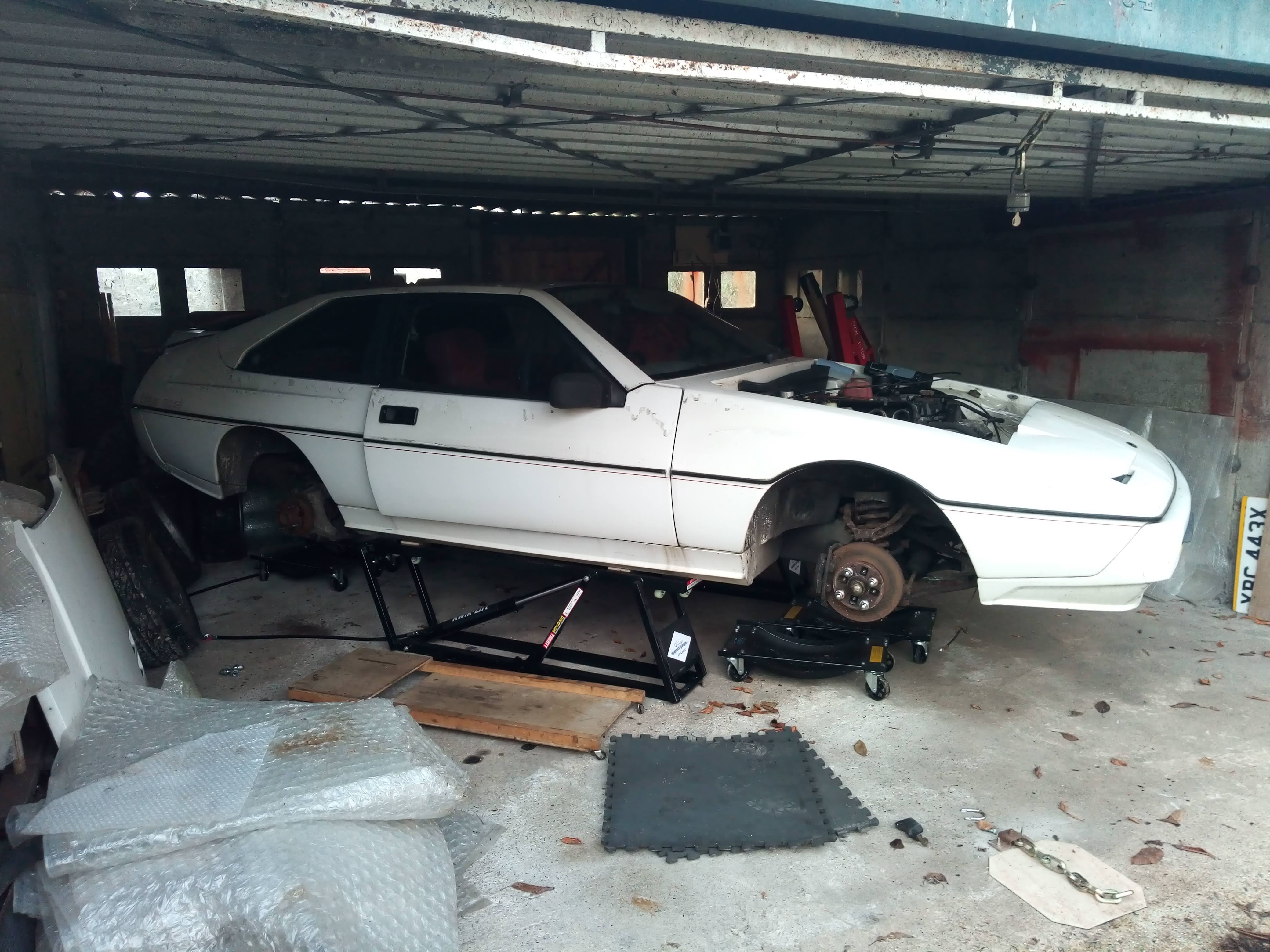

The Excel finally got some attention. It's up on my portable vehicle lift and I've started the suspension/brake rebuild.
Although it's a galvanised chassis, it stood in someone's garden since 2006 and some (unplated) suspension components are beyond use. I had always planned to take the body off the chassis, but many people had tried to discourage me from doing so, "It will be fine, they never rust". Whilst I don't think there are any areas actually rusted through, I've seen enough areas of concern that I am going to split the body and chassis, so that it can be cleaned up at the rust pprotection renewed.
