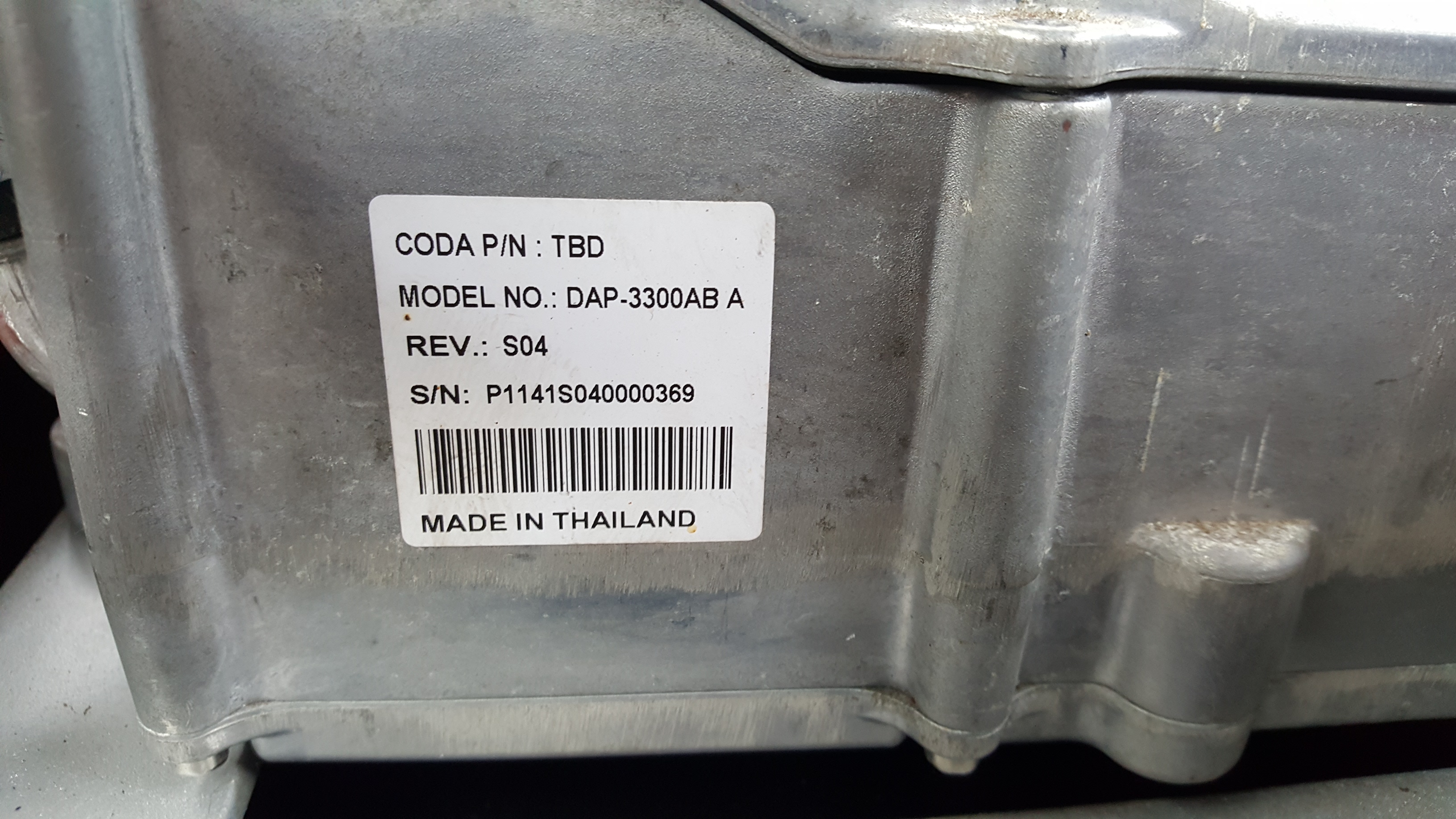

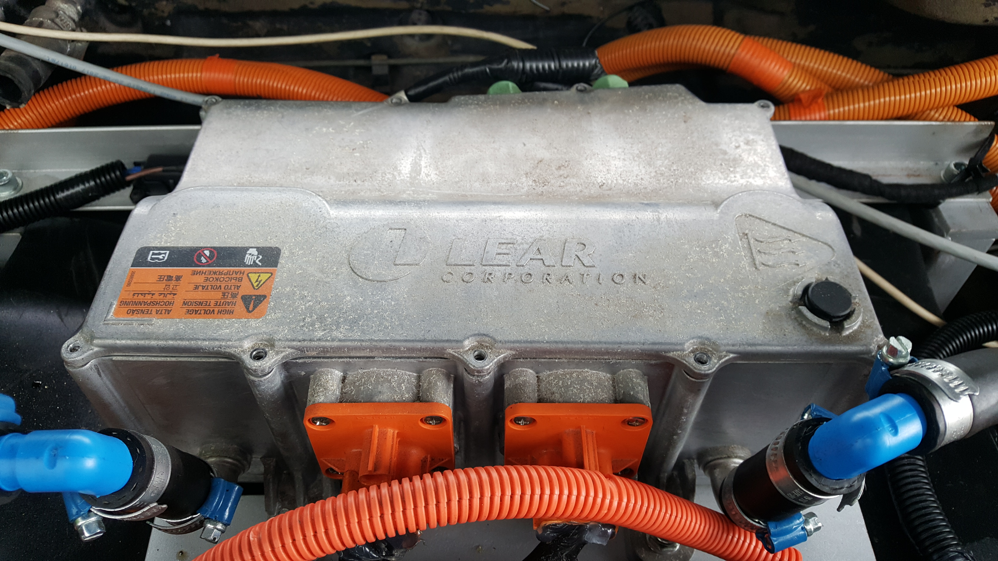

Folks, anyone have any info or experience in running the Lear charger from a coda? Seems the one I have in the deranged rover is a coda variant and seems to not like Arber's CAN messaging. Any help much appreciated as its the last piece of the deranged rover puzzle:)
Using this data :
https://leafdriveblog.wordpress.com/201 ... a-charger/
Attached a few can captures.
Is there any sequence required like ac on , dc on then send can etc?

Tom added code to simpbs for the volt version..take a look at that. Messages and such are way different.
https://github.com/tomdebree/AmperaBatt ... .ino#L3578
-Matt

Shit you beat me to it. Yes I have added the coding and this is verified by one user, so it should be right for the CODA lear charger.

Thanks guys will give that a shot. What frequency does that message have to go at?

Yeah... Coda version uses totally different CAN IDs. I remember i saw EVTV had some info on them...
Yup! See files attached. I never tried one since i havent got the charger though...

Up and running. Thanks for the help guys.
