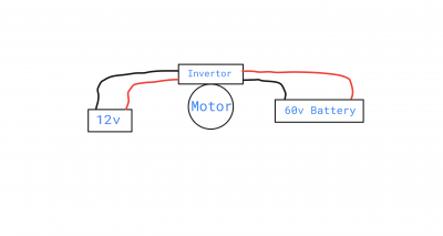

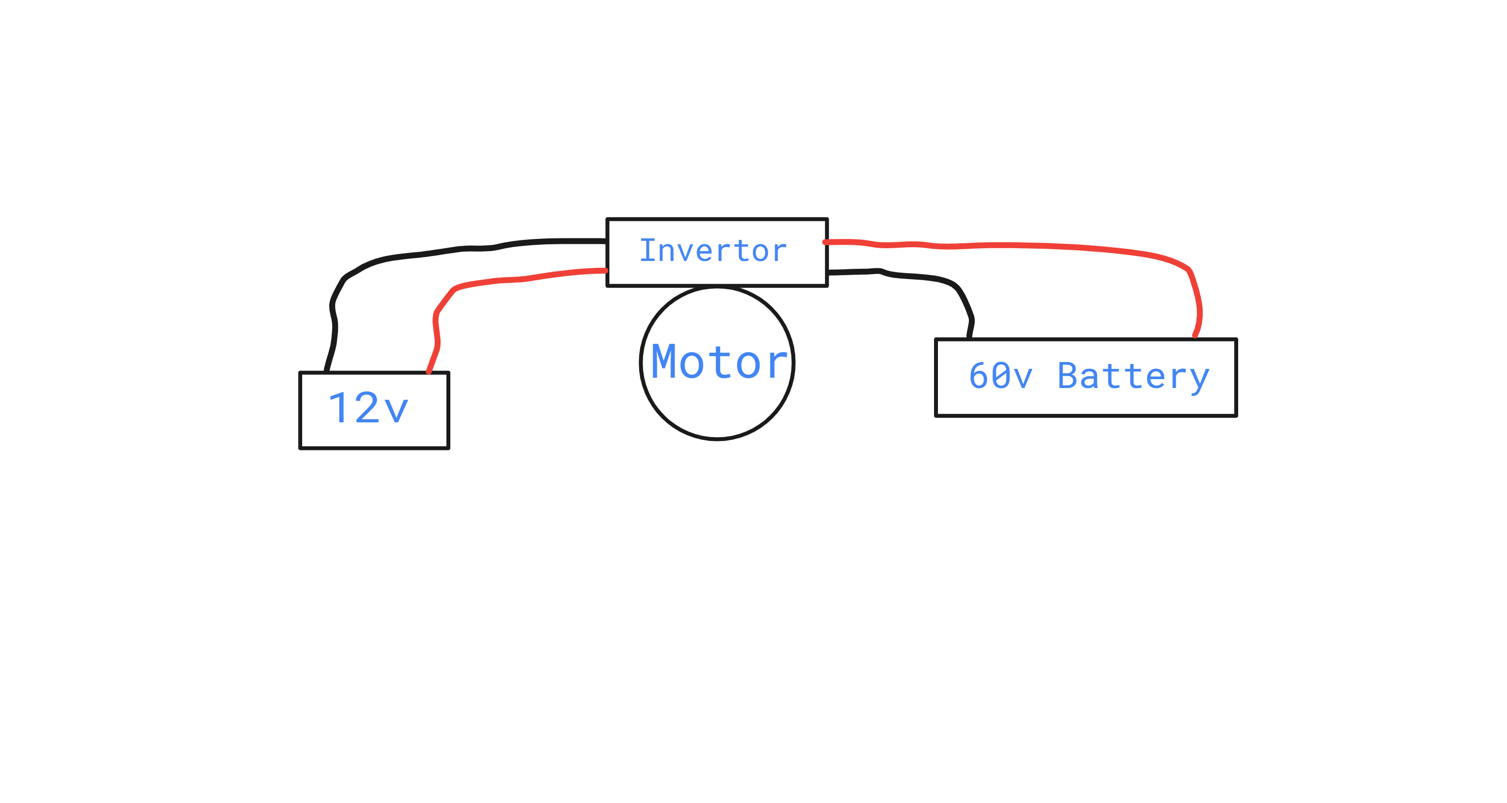

Im trying setup my board to run the motor,
I have done the connection:
12v to power board
12v to start
12v to forward
60v battery voltage
using leaf config settings
start invertor in manual from web interface
I am using 5x 12v 17ah sealed batteries
ok, am I reading the instructions correctly, leave syncofs=0 then just keep adding increments of 5 to manualid till motor runs
I setup with 6mm cables originally which melted after about 10 secs on start up
I then made up 16mm cables although they didn't melt one batteries did decided to split and blow all the caps the top.
you can imagine i don't feel happy or safe
what am I doing wrong ?
can I lower any config settings?
Any help would be appreciated

ok, first step is to give us a drawing of your wiring and details of the motor, inverter, contactors, etc.
Given you had problems with the 6mm cable overheating can I assume you had no current limiting device on initial power up?

just a basic setup, just want to set the motor up. runing the invertor in manual mode

You need to investigate why the inverter is taking so much current (6mm cable would have been fine for bench testing) because if you're destroying batteries then it sounds like you have a dead short. Are you sure you have the positive and negative connected correctly at the inverter?
You should limit the HV current and precharge the inverter capacitors during initial test. If you don't understand how to do this then i'd strongly suggest you consider Johanne's support services because you can easily damage the inverter;

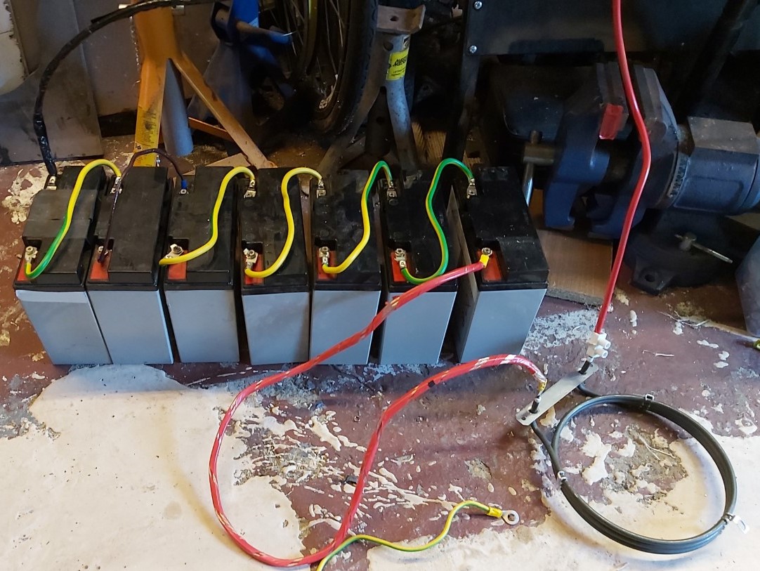

Found in anther thread when Kevin mentioned about using a element in series,went ahead bought a cooker element from amazon (£8). wired it in series with hv battery,, doubles up as a precharge resister and current limiter as I haven't used contactors for setup with 80v and the cables did not hot. Strongly recommend that this setup be used for initial setup. the brown wire is a 1.5mm fuse-able link as the rest is in 16mm cable
so Took manualid upto 300 with sycofs=0 still not turning,just keep getting a double click from the motor ( element was getting very hot by now) so tired a different approach took manualid back to 5, then started incrementing syncofs by 1000 till motor was spinning, then worked backwards till the motor stopped, so I suppose I have found my angle offset.
Went ahead and setup a throttle pedal, removed the element out of the circuit,
Motor spins up silky smooth and very fast on throttle control, only problem is it spinning anti-clockwise as you are looking face on at the splined shaft.
went ahead and added 32768 to my syncof value, the motor spins clockwise now but at a reduced speed you can hear the motor tapering the spin down. tried switching the motor phase wire but made the motor jerky.
the web interface is showing the motor is in forward direction
which is the correct spin rotation as you looking at the motor face on.
If it needs to be clockwise what setting do I need to change in the interface ?

Thanks for sharing the update and great to hear you're making progress
