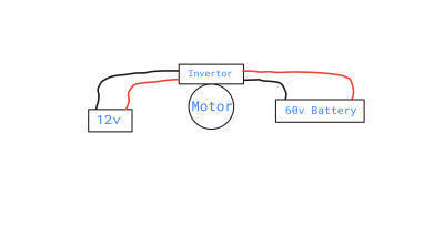

ok, first step is to give us a drawing of your wiring and details of the motor, inverter, contactors, etc.

Post by zippy500 »
just a basic setup, just want to set the motor up. runing the invertor in manual mode
The original config file for the leaf setup must ready for a 360v setup.

zippy500 wrote: Sat May 30, 2020 6:28 pm just a basic setup, just want to set the motor up. runing the invertor in manual mode
You need to investigate why the inverter is taking so much current (6mm cable would have been fine for bench testing) because if you're destroying batteries then it sounds like you have a dead short. Are you sure you have the positive and negative connected correctly at the inverter?
You should limit the HV current and precharge the inverter capacitors during initial test. If you don't understand how to do this then i'd strongly suggest you consider Johanne's support services because you can easily damage the inverter;
https://openinverter.org/shop/index.php ... duct_id=61

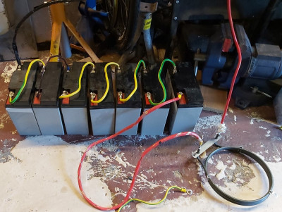

Found in anther thread when Kevin mentioned about using a element in series,went ahead bought a cooker element from amazon (£8). wired it in series with hv battery,, doubles up as a precharge resister and current limiter as I haven't used contactors for setup with 80v and the cables did not hot. Strongly recommend that this setup be used for initial setup.
the brown wire is a 1.5mm fuse-able link as the rest is in 16mm cable
so Took manualid upto 300 with sycofs=0 still not turning,just keep getting a double click from the motor ( element was getting very hot by now) so tired a different approach took manualid back to 5, then started incrementing syncofs by 1000 till motor was spinning, then worked backwards till the motor stopped, so I suppose I have found my angle offset.
