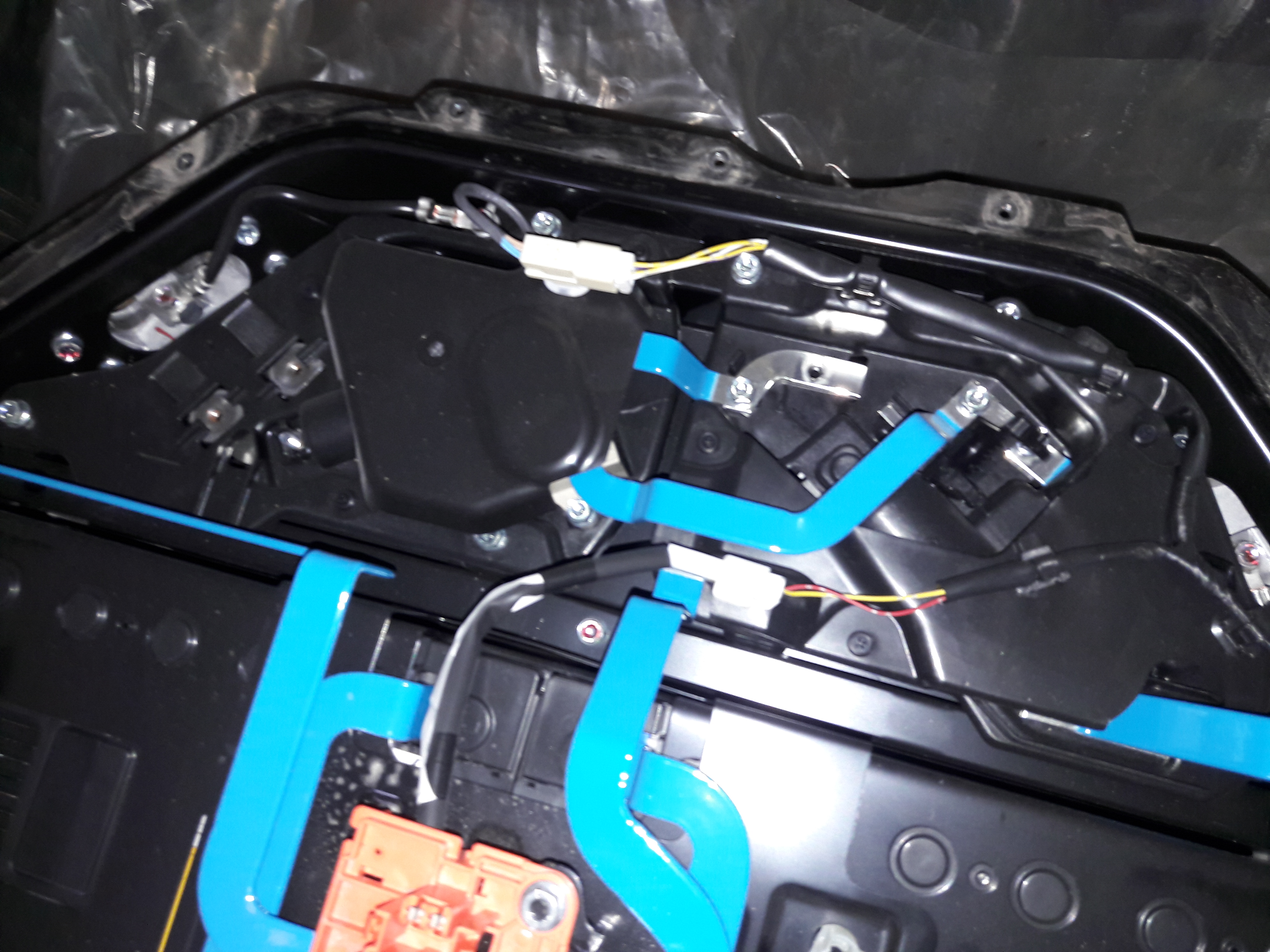

I have bought such a (lithium ion) battery pack recently. To my surprise, all cells in the pack held a voltage below 0.5 Volts, so they are probably unsaveable.
The car part shop was very nice to have me exchange the battery pack for another one, which is in a good state, so I was lucky. They mentioned that the Outlander battery pack was removed from a functioning car. It is unclear to me what exactly the reason of the self-discharge could have been, but I just want to caution anyone planning on buying such a pack to be aware that there exists the risk of being unlucky, even though I am aware such risks are always present when buying any second hand item. Also, I might be just very unlucky with this pack being in storage for years and years.

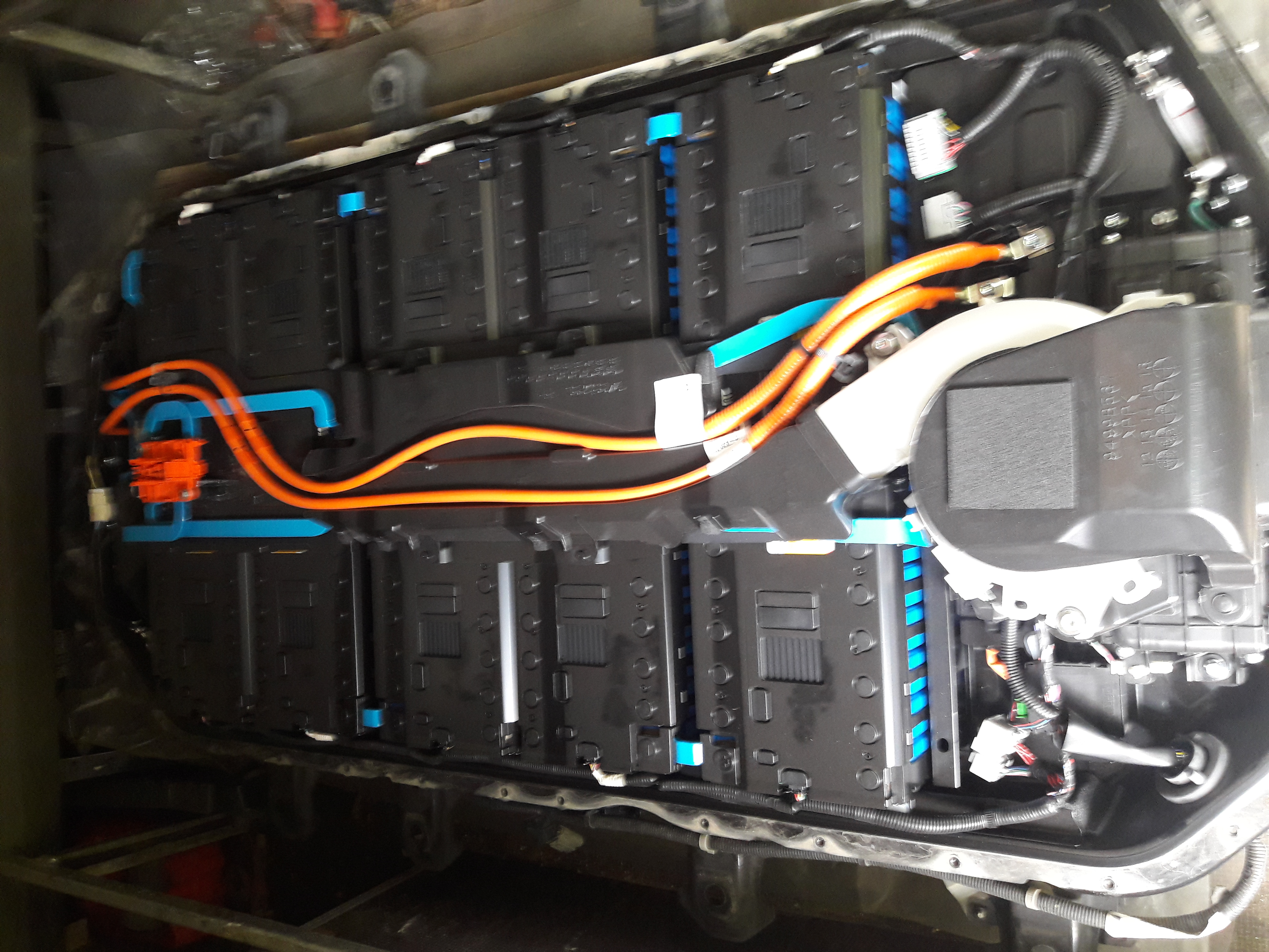

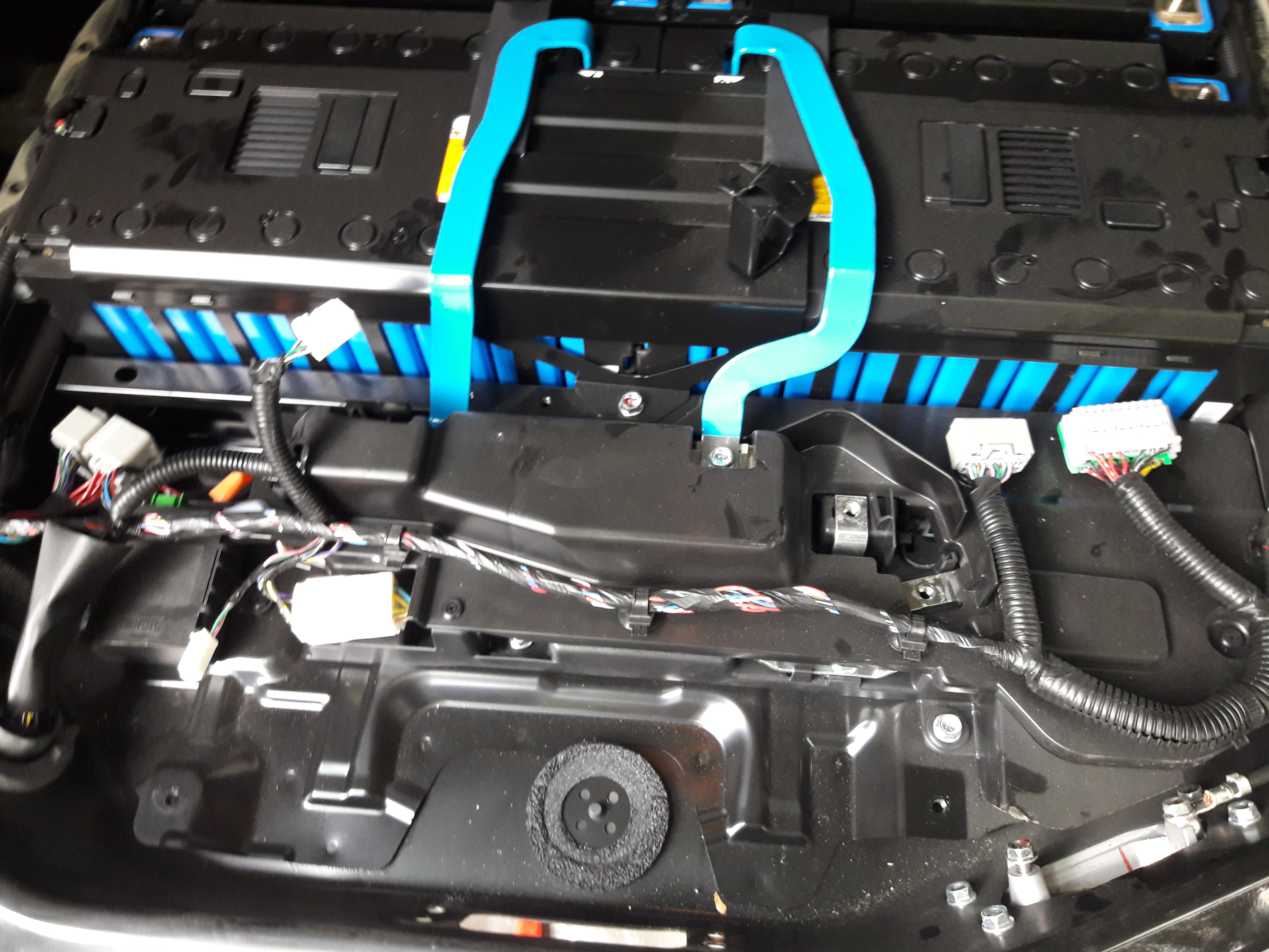

Below also some pictures of the pack. They are configured 1p80s (packed in packs of 10), and it includes contactors and air cooling from a small water-air radiator inside.
The entire pack with the lid off (sorry for bad quality)

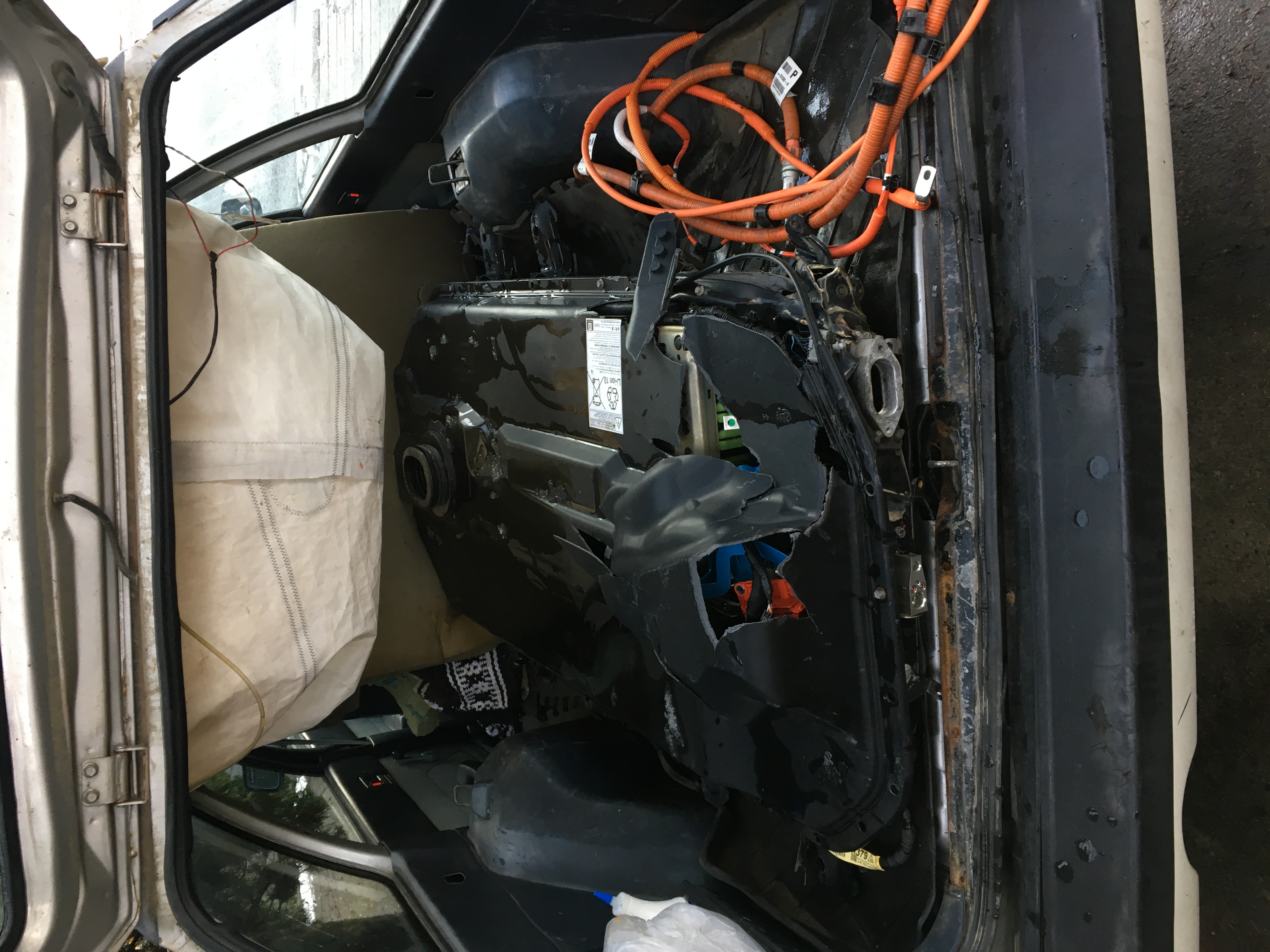

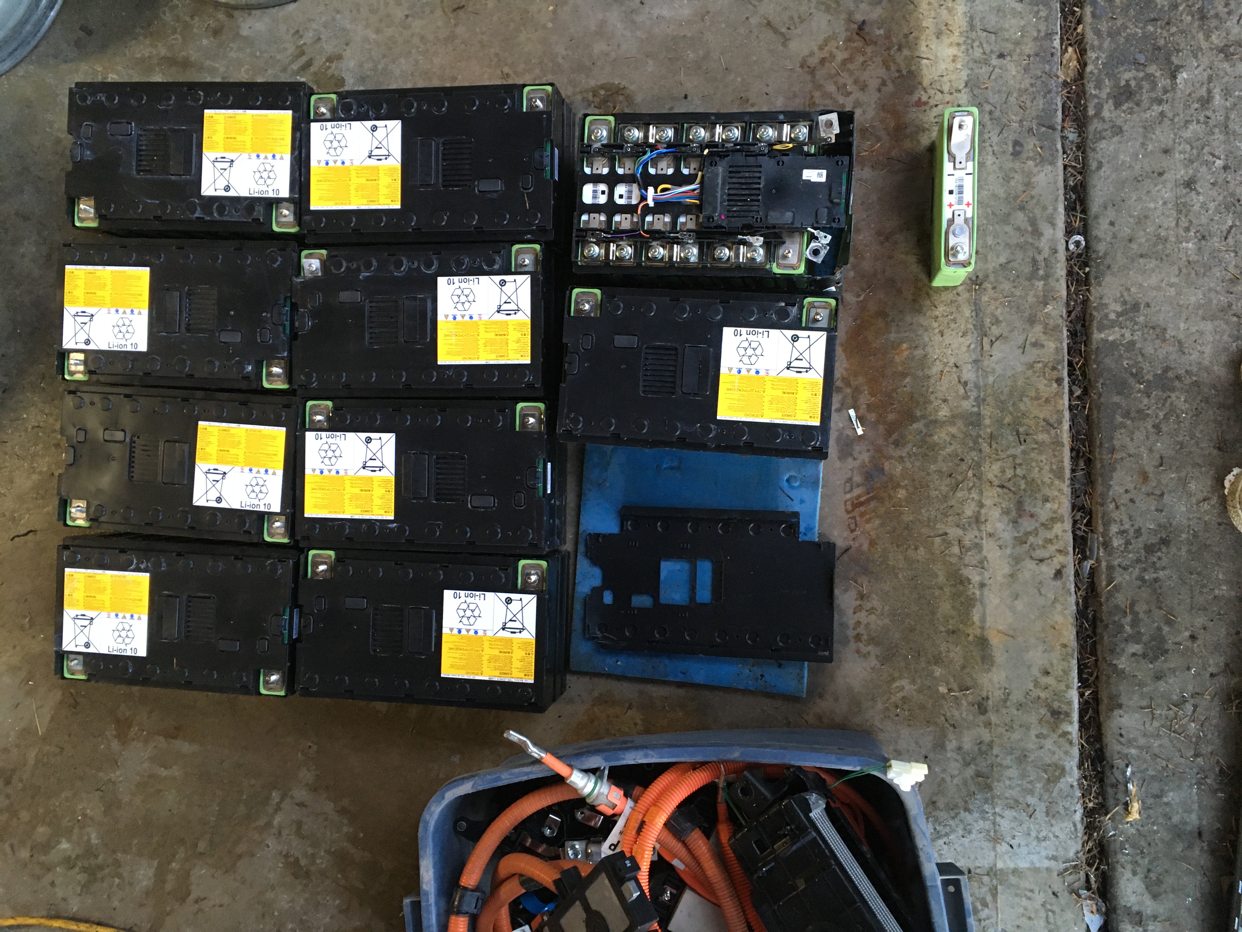

a completely totalled 2020 model just showed up at a local yard. Battery cover was cracked, and one cell was hit, but the rest look fine, all floating around 29-30v per module !
Got the pack for 300$ Canadian + some random HV cables 🤑
There was one Punctured cell. Removed it carefully, but it was still holding a charge. Crazy!
pack was left out in the snow, so had to do some tear/whips Downs. But everything seams happy.

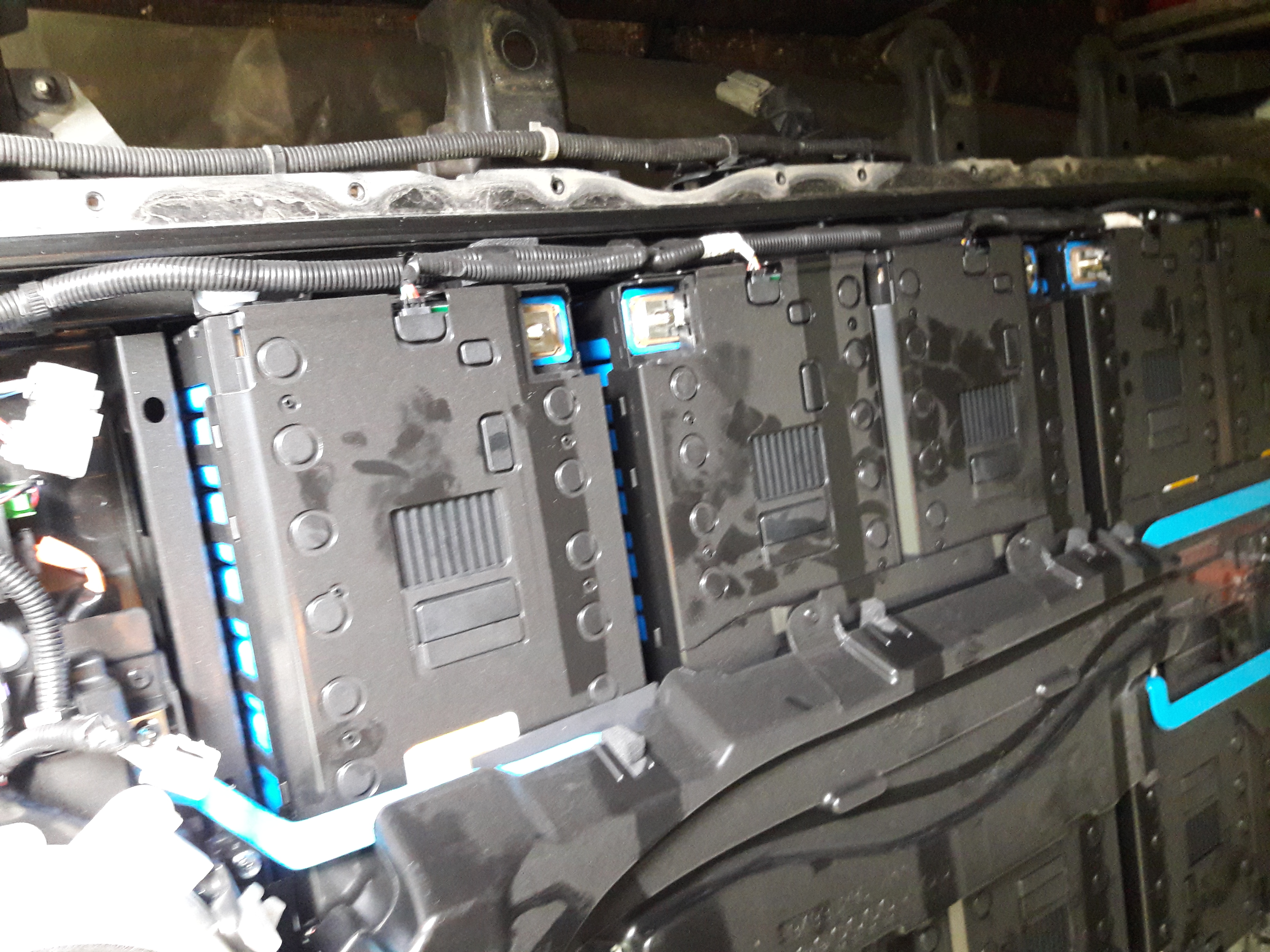

Not entirely sure why but there appears to be some sort of self destruct in the cmu boards but it requires a 12v supply. I was messing sending different commands to them than the standard balance command and there is one that makes them discharge all cells regardless of their voltage. I tried with some scrap 18650s and it did practically discharge them to below 1v! However the process would take several weeks on the full size pack.

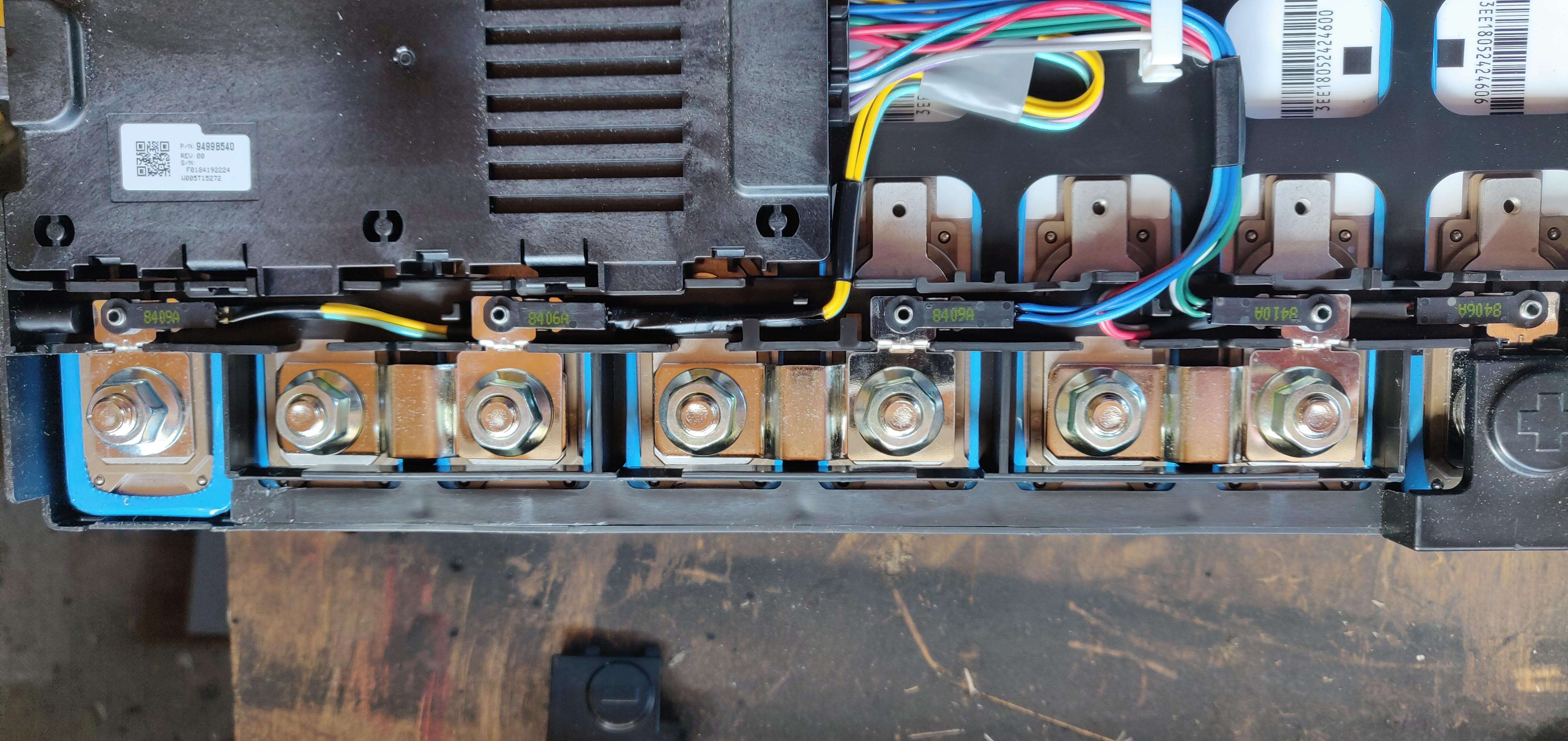

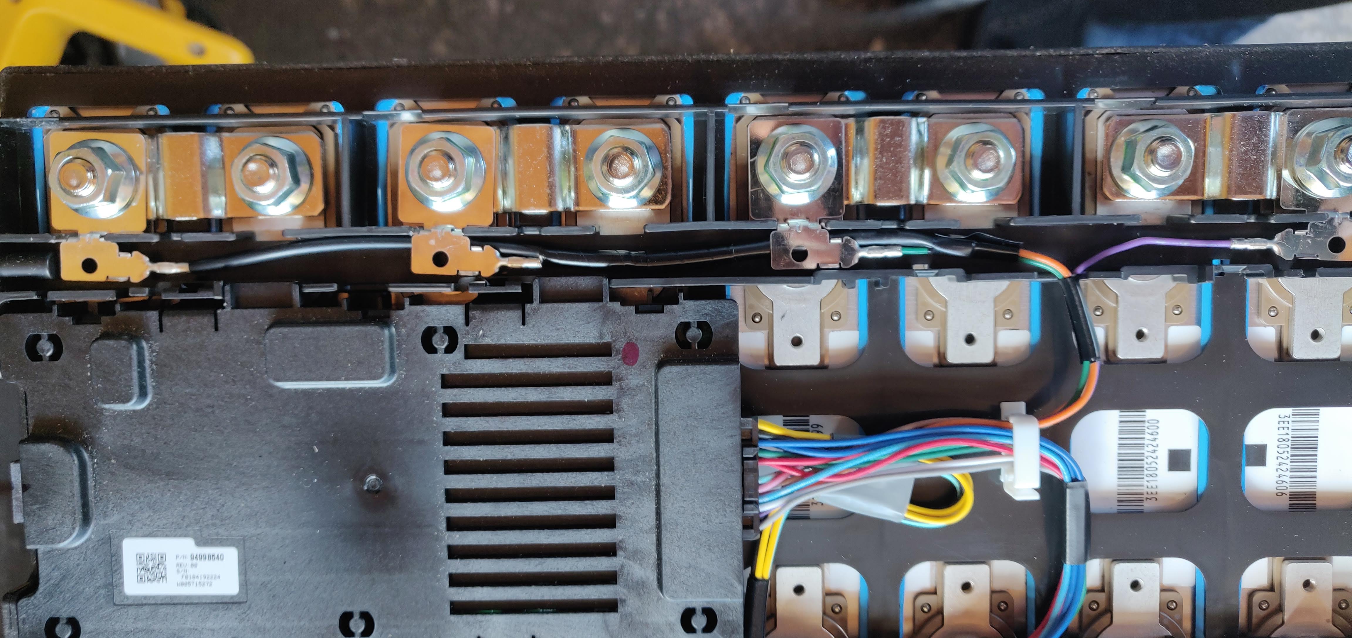

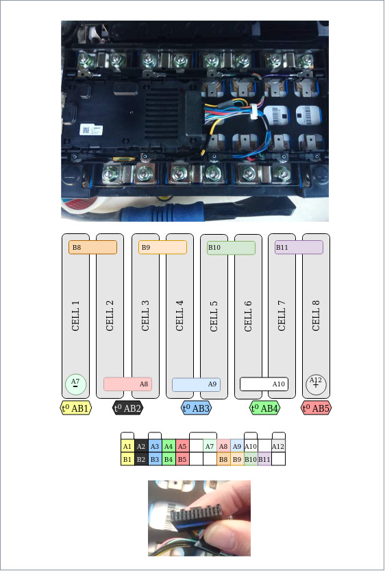

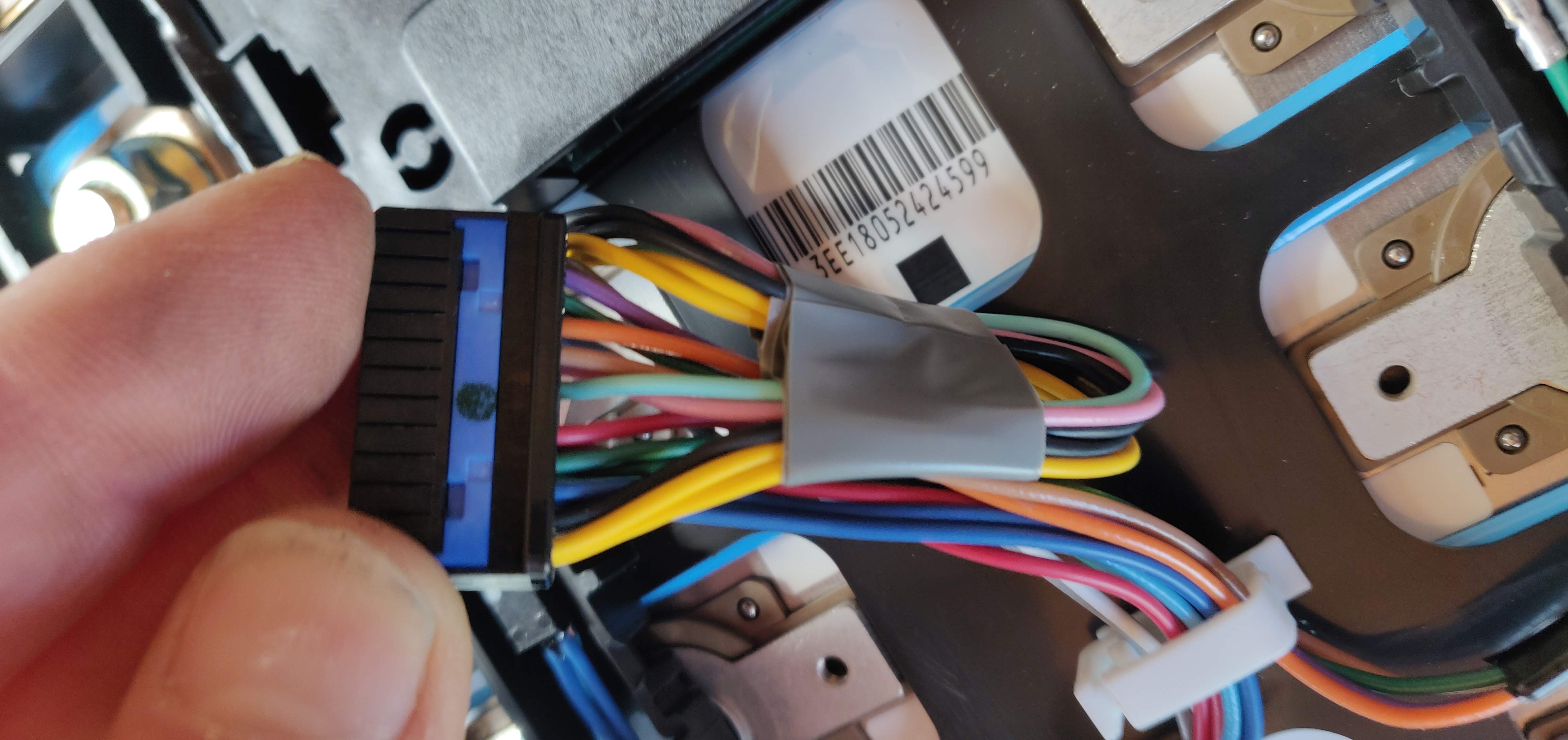

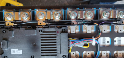

Could you help me find or somehow draw a diagram of the connection of colored wires from the cells and it's temperature sensors to the CMU connector (connector pin-out)? I have looked through a ton of video, forumsand service manuals but nowhere is it. And it is very difficult to determine this from the overview video, because the wires cover each other.
I'll be very thankful!

aot93 wrote: Mon Apr 19, 2021 10:01 pm I'll try grab some photos when I'm back in in the garage.
I was planning on keeping the modules complete and the plastic clips look a little fragile so I may give up..
Great, thanks.
I think it is possible just to paint the diagram on paper if you can look closely at the wires and track them from plug to the cells and temperature sensors.

Post by aot93 »

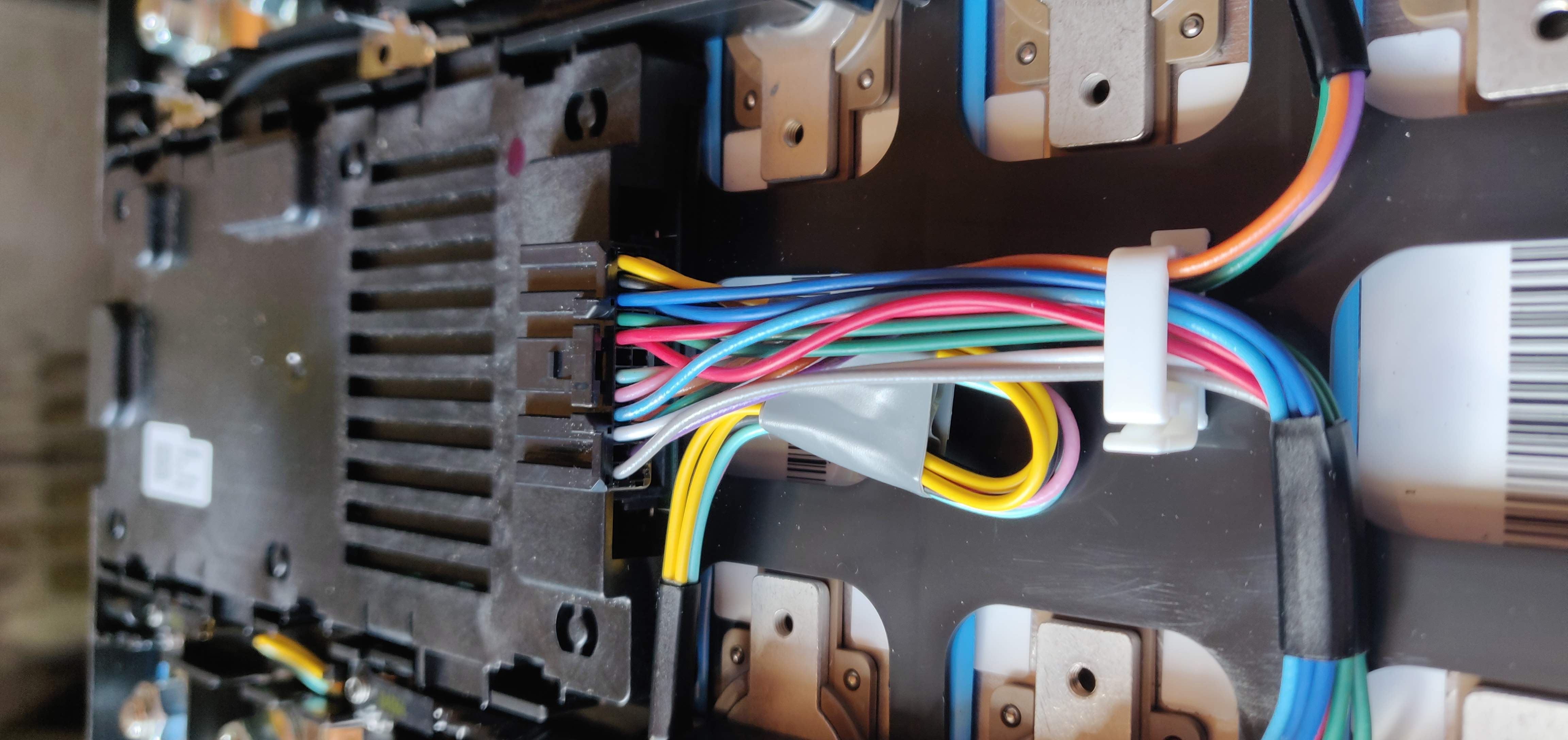

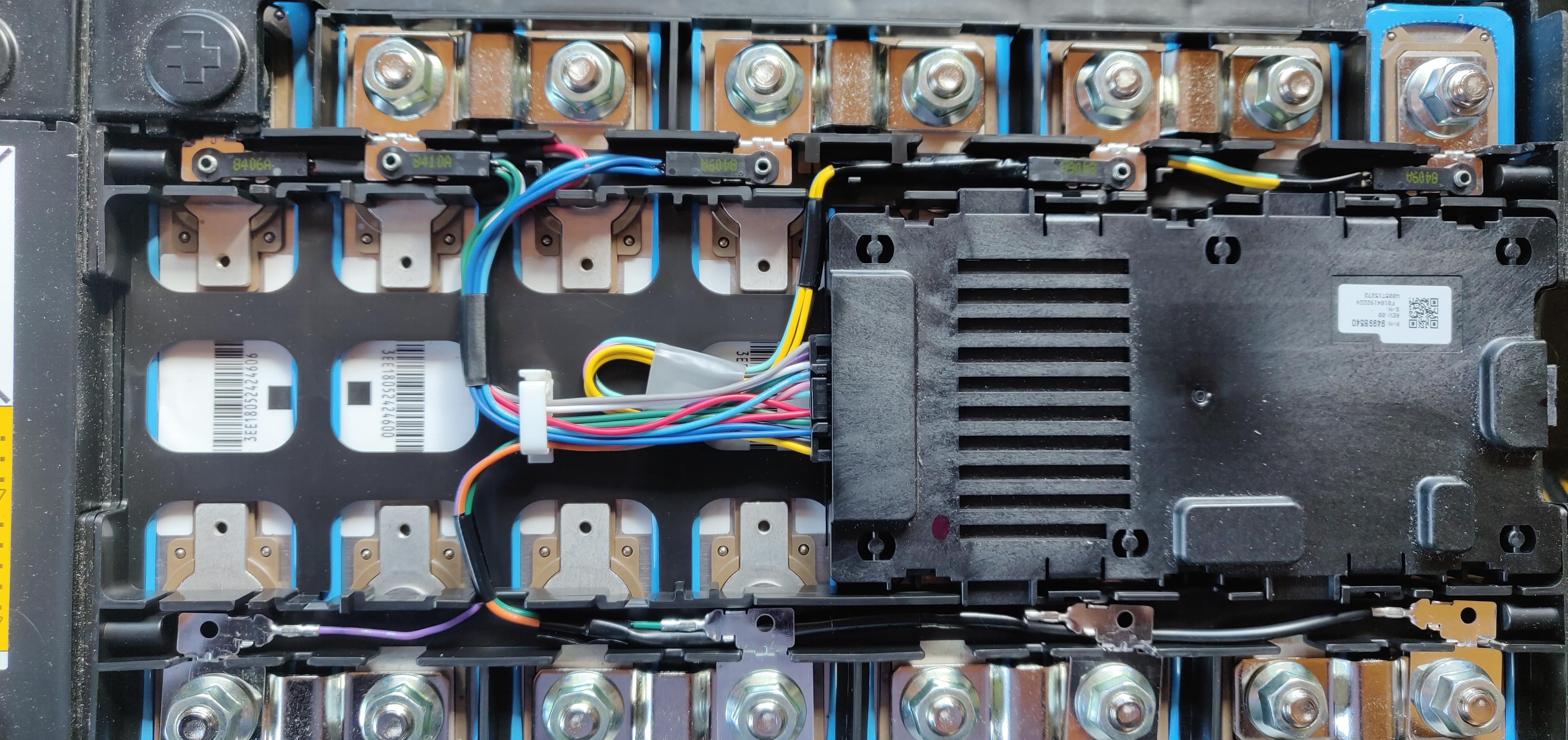

Here are some pics of the CMU wiring.

Post by chuuux »
aot93 wrote: Sun Apr 25, 2021 10:03 am Here are some pics of the CMU wiring.
Thanks!
I draw the diagram.
