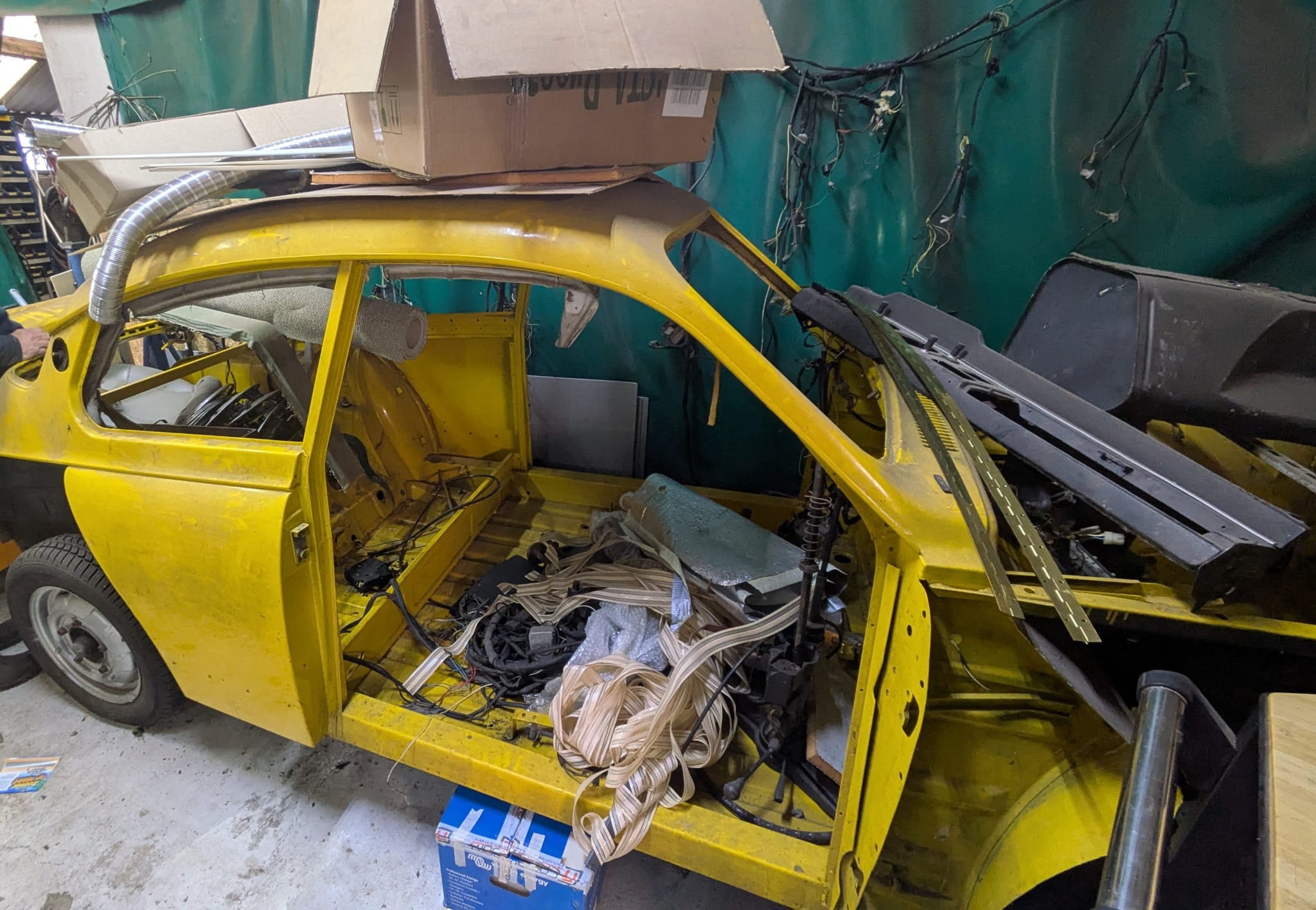

The Saab in its current status:

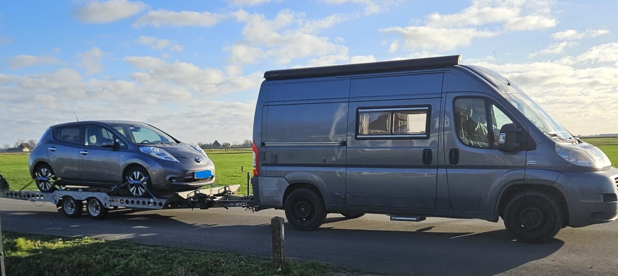

Donor Leaf picked up:
