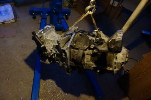

The obvious first step is to remove the combustion engine. There are various tutorials for that, I will only go into the specifics on EV conversion.
- Unplug the engine harness from the ECU - this allows you to leave most connectors on the engine in place and just remove it with the complete harness - good for resale
- Consider keeping the ECU to place your own logic inside its enclosure
- Do not use force! You will reuse many connectors so don't destroy them
- The only thing you can safely cut is the fuel pipes :)
- Have someone empty the A/C - it's a vary unpleasant spray if you don't. It is also a potent climate gas, releasing it causes the same warming as driving 1000 km on petrol.

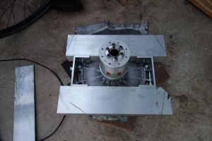

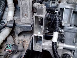

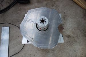

Transmission coupling plate

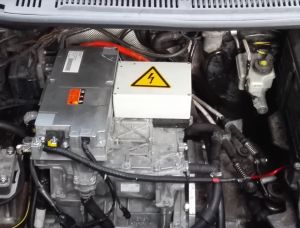

The Inverter mount collides with the transmission bell so I had to cover quite some distance to avoid it. To save on material I used box section profiles 4mm walls, 80x40mm. Bolted them together with a 100x50x40 U-profile and bolted all that to the motor. I had to make a little cutout for the drive shaft.
The bell housing plate started life as a 350x350mm 15mm plate that we cut to shape with a jigsaw. Afterwards it turned out I should have gone for 20mm as the whole assembly was shorter than the shaft coupler - forcing me to add another 5mm aluminium in between.
Shaft coupler
While the coupling plate is rather ham fisted the shaft coupler is not - because I wasn't in charge ;) At its core is a KTR Rotex GS38 jaw coupling. On one side is an assembly that embraces the spline extracted from the VW clutch on the other side it bolts onto a Nissan spline that used to be sold by New Electric but the stopped making it.
I didn't put much effort into aligning, just put the transmission on top of the motor, drew the hole marks as accurately as possible, drilled, tapped. Even took the whole thing apart inside the engine bay. Lets hope there is no backlash.

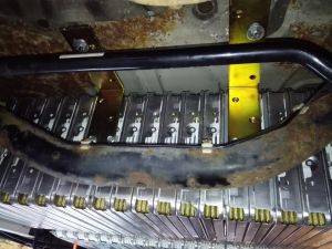

As opposed to the original plans I currently only mounted one full Nissan Leaf pack in the fuel tank space. I used the existing 5 M8 holes that used to hold the fuel tank and part of the exhaust. In addition I drilled 3 holes into the seat carrying structure that exit exactly between the two battery bricks. Another 3 M10 screws fix the two bricks to the chassis there. So 8 bolts fix the mounting angles to the chassis.
The mounting angles are screwed into the battery brick with 2 M6 bolts each. There are 11 mounting angles, so 22 M6 screws fix the batteries to the mounting angles.
Positive and negative exit on the cars driver side. Positive passes through Nissans service disconnect jumper that also contains a 225A fuse. Next up the 2 poles connect to Nissans original DC switch gear in the exhaust tunnel and connect to the inverter using Nissans original DC cable.
I reused the original spaghetti wires and Nissans BMS (they call it LBC). It lives on top of the front battery brick. Its current sensor is bolted onto the positive DC switch in the exhaust tunnel. It also still monitors the safety disconnect. Its power supply and communication wires run to the fuel tank service hole under the rear seats. From here it connects to the motor CAN bus. It also runs at 500kbit/s and has no mutual object ids.

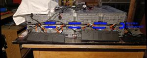

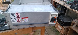

Battery Upgrade to 55 kW ID.3 modules
To further increase long range ability of the Touran I have fitted a new battery in the beginning of 2024. Coincidentally 8 modules easily fit into the former fuel tank space. While the Nissan module occupied about every millimeter the MEB pack still clears the subframe by 40mm.
The bolting points are the same as for the Nissan pack but I added a forth hole because the 3 holes from before were off-center. So the pack is now held on with 4 M10 bolts and 5 M8 bolts.
The MEB BMS modules are being reused and live outside the actual battery box in a separate BMS box that I bolted to the front. I was again lucky that there are no mutual CAN Ids between the BMS and the rest of the car. There is more bus traffic now as all battery voltages are transmitted in 100 ms intervals. This does not seem to cause issues.
High level BMS functions such as SoC calculation and dynamic current limits must now be implemented in the VCU. I watched numerous Nyland videos to understand how VW runs this battery. Apparently the maximum temperature is 50°C and full 100 kW charge power is only available above around 25°C. I will probably limit charge power to 80 kW in general as I don't need to churn out marketing figures.
With the removal of the Nissan BMS I also loose the current sensor and I replaced it with an ISA shunt. This is actually a remarkable upgrade as the shunt has much higher resolution and also measures the current draw of the 230V AC inverter correctly. It also integrates the current for Coulomb counting. Furthermore it has 3 voltage inputs that I will be using for charge port voltage sensing.
As opposed to the Nissan pack the new box is designed to be waterproof. This makes me feel much more comfortable when driving in heavy rain.
While the pack was liquid cooled in the ID.3 it is now not being cooled at all or convection cooled at most. Summer time will have to show whether this is practical. The voltage drop under load is much lower than that of the Nissan pack so I expect much less heat. Since I usually drive very economical I don't expect much heat buildup during driving. It's the charging that will heat the pack up.
Update: a few road trips have shown that cooling is inadequate. On hot summer days even the first charge session will end up derating because the modules reach 50°C. In winter you get one flawless session and the next one will overheat. As before it might be helpful to not drive the pack to empty but recharge well above 40%. Internal resistance and current draw rises as the battery empties, driving temperature even higher. I am now experimenting with air cooling to improve this.

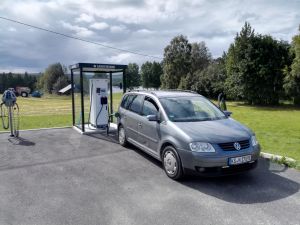

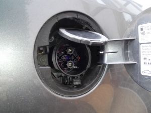

CCS charge port upgrade
Europe's charging network is growing rapidly but only if you have the right charge inlet. Unfortunately the complicated CCS standard has won the port battle. So I bought the CCS port from an MG ZS EV. Its power cables exit sideways which is very convenient in the confined wheel arch. I had to mirror the outlet direction because originally they exited towards the tail light. Fortunately inlet pins and power cables can be separated to allow for swapping them around.
The PE is solidly bolted to the chassis right next to the port. Unfortunately the port locking mechanism did not fit.
One advantage of CCS is the reduced number of signal wires. Only PP and CP need to be routed to the charge controller. In addition I also routed both charge pin temperature sensors resulting in 4 wires total. That said, with the charge port lock (that sits on the EVSE side for CHAdeMO) we'd be back at 8 wires.
For controlling the charging session I use the Fully_Open_CCS_Charge_Controller_(FOCCCI). It sits on top of the battery pack and is accessible via the fuel pump service opening just as the CHAdeMO controller was formerly. Internally it still uses the CHAdeMO CAN protocol to communicate with the VCU.
