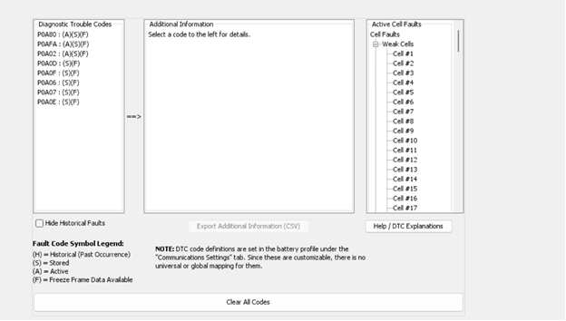

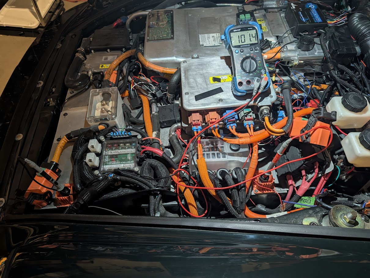

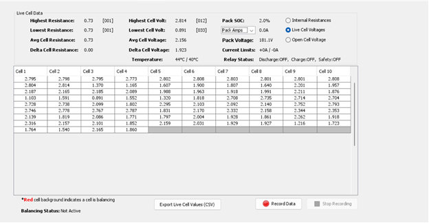

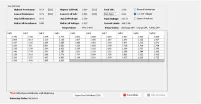

Hello! I know it has been a while since I have needed any assistance, but I had an emergent issue come up yesterday.
I was driving home in Nashville on a hot day and my battery was down to 10 % and I was close to home but it dropped precipitously towards zero and below 200V by the time I got into the garage and now the car will not charge and the battery voltages are all screwy and I hope I have not lost these batteries. I have the ORION 2 BMS and I am attaching screenshots. When I plug in the charger it does not engage and no AMPS show up on Orion cell data. Orion was set up with all of the discharge limits and fail safes using the ZERO EV pre-sets to prevent the batteries from dropping below certain numbers, so I am confused how this happened. I have been driving for a couple of years now with no issues, but the battery has never dropped out like this before.
I hope you have some advice or help for me. I am dreading the responses that my batteries are toast ☹

Uhhmm, they are dead. Look at how low those voltages have dropped. Cells below 2.8V are irreversibly damaged. You have some way lower too.
I do not know how your build has been wired up to stop driving if the pack is empty.

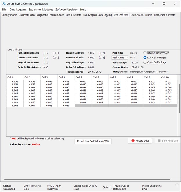

Thanks guys. Johan, thanks for pulling my old parameter file, which is still in place. I assume the car should have cut off before this number, but it did not, so I am wondering what happened here. If I am going to invest in new batteries, I want to b sure this does not ever happen again.
Also, is there any chance the ORION is giving incorrect cell voltage readings?

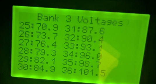

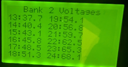

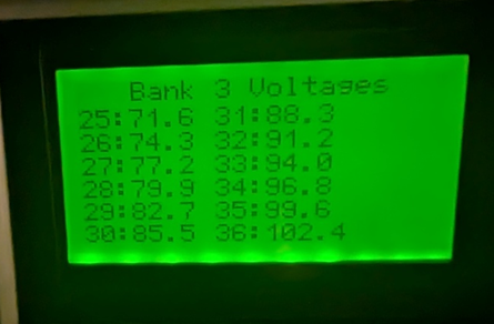

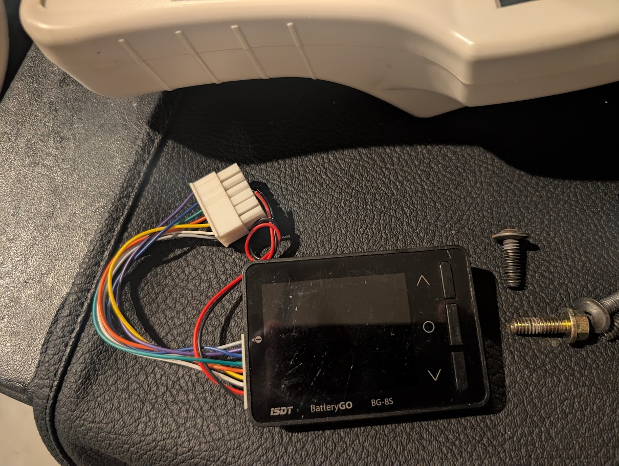

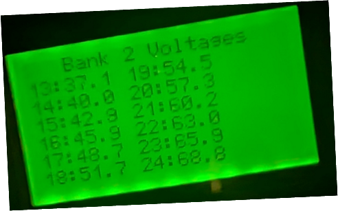

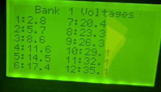

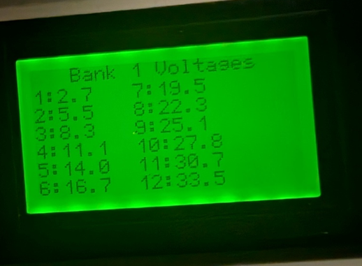

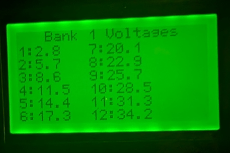

Also, I took out the ORION Cell Tap Validation tool from my box of tools and checked each bank of 84 cells the voltage seems to show a different story, so now I am wondering if the ORION readings were wrong and my batteries are ok. Man this is confusing.

I took the multimeter to the front batter box (36 cells) and it also read out as 101.4.

So you need to figure out why the orion is no longer reading the right voltages then. Try plugging it all back in to see what it reads now after a power cycle.

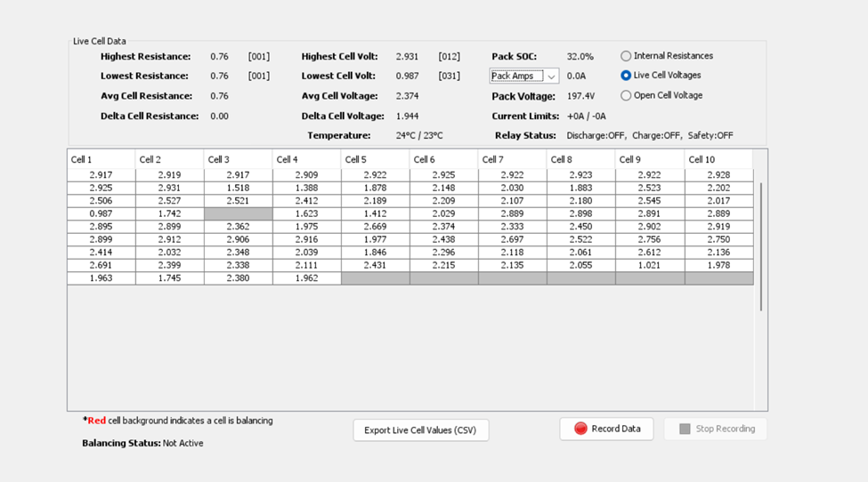

When I power cycled the front battery box, the ORION readings went nutty. SOC went to 50% and then to 30% and then 5% and then settled on 10.5% and pack voltage went up to 200V and the individual cells changed again. I have not done any charging, but they went up. I am about to jettison 20k worth of batteries, so I kind of want to be sure they are screwed. Any other thoughts to bypass ORION and find out? When I left my office to head home I was at 20% and traveled only 10 miles on surface streets under 40 mph and it bottomed out before I got home. This never happened and I have never let the car get down below 10% so I have nothing to compare this to. Thanks again for any thoughts.

As you say the celltap tester and orion do not show the same voltages.
Did you fully unplug the Orion, all connectors including the 12. Then leave it for a bit, then power it all back on and see if anything changes.

SOC is not important. it is the cell readings, none of it makes sense. So there is a major issue hardware wire as there is a discrepancy between Orion and the celltap. As you say you orion swap would be a good test.
I would ask you to put all the celltap readings into a spreadsheet so you can quickly work out the voltages. Possibly all around 2.8V and could be recoverable.

If I were selling Orion, I would also suspect the problem lies elsewhere. You can measure the individual cell voltages at the Orion connector with a multimeter, right? If the BMS then displays something different, the error is there, regardless of settings and SOC calculations.

Very much agree with this. Its a PITA, but using a multimeter to figure out what the real cell voltages are should tell you if the Orion is correct or not. Components fail, even trusted ones.muehlpower wrote: ↑Fri Aug 15, 2025 10:08 am If I were selling Orion, I would also suspect the problem lies elsewhere. You can measure the individual cell voltages at the Orion connector with a multimeter, right? If the BMS then displays something different, the error is there, regardless of settings and SOC calculations.

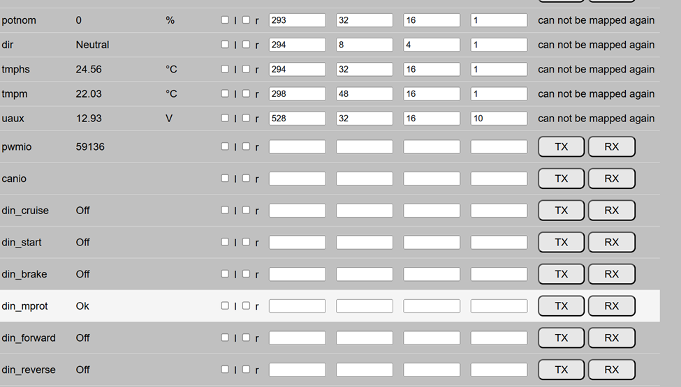

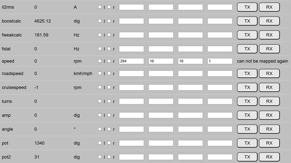

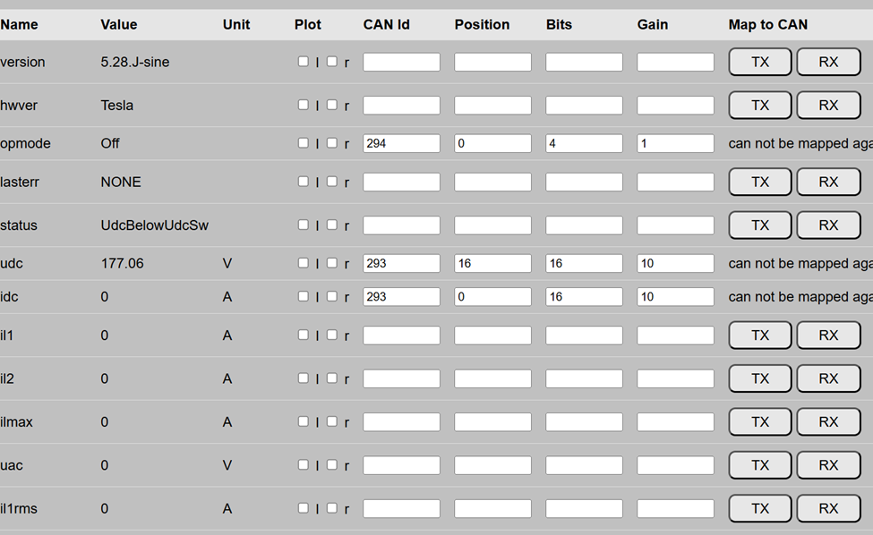

As to the 170V, the voltage keeps jumping around and settled back at 200V at some point after I took these screenshots, but yes the HV was open when I took these screenshots. Again, the front box of 6 batteries is giving me 101V (now 95) and the rear box of 6 batteries is at 101V. I need to check the two under the seat, but I suspect they will get me to a combined number of at least 220, but I will see. This is why I am baffled. Also, for the last 2 years whenever I charged the car the batteries were balanced and within just .01 of each other and these numbers are so out of whack that I am trying to understand how and when it fell apart.
Below is an OLD screenshot from the ORION from October of 23.
As to the udcmin number, that is embarrasing, but what was it supposed to be? 200? If so, that's a shitty thing to have missed
Thanks for the info about the ORION pulling the gear signal. I will talk to Chris about this and see if that is something I did or did not do and if I should consider that going forward.

Re: Tesla Batteries @ 2% w/ ORION BMS
I am looking at these params and I am just flummoxed. The one that Johan sent through must have been before these were uploaded and his are how I always had it, so this one is totally whack and makes me wonder if I uploaded the wrong file at some point, but I am kicking myself pretty hard.
"udcmin": 20,
"udcmax": 520,
I would never pick these numbers on a car with a battery range of 270-350V
"udcmin": 20,
"udcmax": 520,
