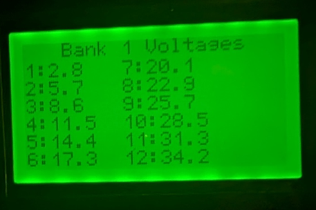

Hello! I know it has been a while since I have needed any assistance, but I had an emergent issue come up yesterday.
I was driving home in Nashville on a hot day and my battery was down to 10 % and I was close to home but it dropped precipitously towards zero and below 200V by the time I got into the garage and now the car will not charge and the battery voltages are all screwy and I hope I have not lost these batteries. I have the ORION 2 BMS and I am attaching screenshots. When I plug in the charger it does not engage and no AMPS show up on Orion cell data. Orion was set up with all of the discharge limits and fail safes using the ZERO EV pre-sets to prevent the batteries from dropping below certain numbers, so I am confused how this happened. I have been driving for a couple of years now with no issues, but the battery has never dropped out like this before.
I hope you have some advice or help for me. I am dreading the responses that my batteries are toast ☹

Uhhmm, they are dead. Look at how low those voltages have dropped. Cells below 2.8V are irreversibly damaged. You have some way lower too.
I do not know how your build has been wired up to stop driving if the pack is empty.

jsimonkeller wrote: Wed Aug 13, 2025 2:42 pm is there any chance the ORION is giving incorrect cell voltage readings?
Yes, but unlikely since they are all reading so low. I would suggest you measure the pack voltage another way and do simple math.

Also, I took out the ORION Cell Tap Validation tool from my box of tools and checked each bank of 84 cells the voltage seems to show a different story, so now I am wondering if the ORION readings were wrong and my batteries are ok. Man this is confusing.

So you need to figure out why the orion is no longer reading the right voltages then. Try plugging it all back in to see what it reads now after a power cycle.

SOC is not important. it is the cell readings, none of it makes sense. So there is a major issue hardware wire as there is a discrepancy between Orion and the celltap. As you say you orion swap would be a good test.
I would ask you to put all the celltap readings into a spreadsheet so you can quickly work out the voltages. Possibly all around 2.8V and could be recoverable.
