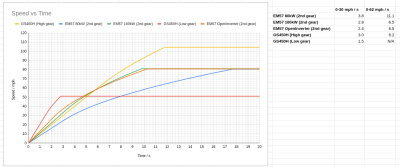

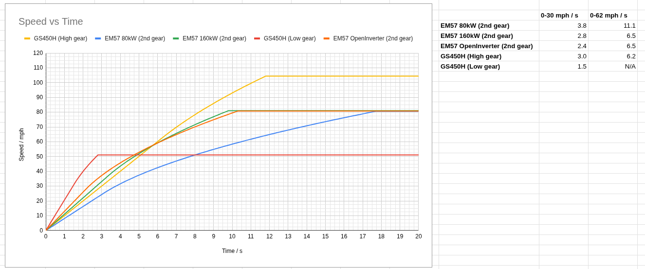

In the meantime I've been trying to get an idea of the performance difference between the leaf motor and a GS450h transmission, trying to convince myself that I'm making the right decision.
I would be amazed if these numbers turn out accurate given all the assumptions and guesswork that went into it but even so it gives me some confidence that the leaf motor will still have plenty of power. Based on this I'll definitely want to upgrade to a 160kW inverter or install the replacement logic board for ~140kW but I think I'll get the car running on the 80kW one first before I splash out.
My whole spreadsheet is here btw if anyone wants to critique it haha: https://docs.google.com/spreadsheets/d/ ... TvPRqJKADw

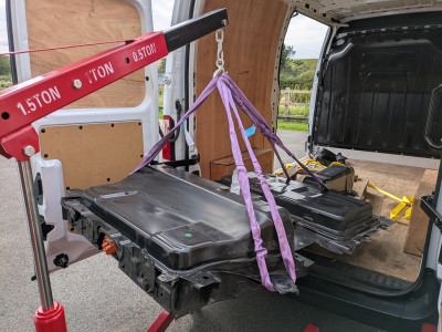

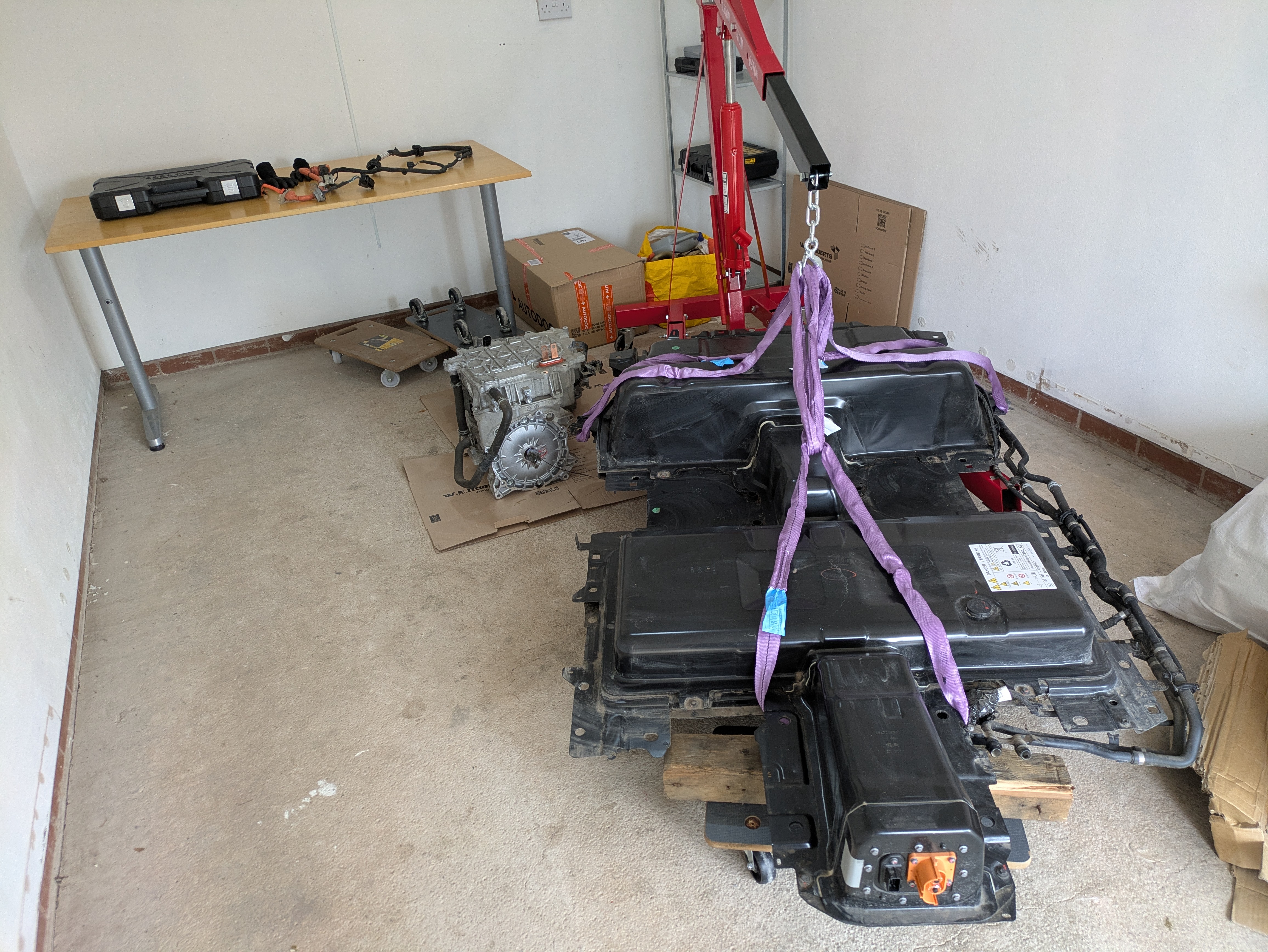

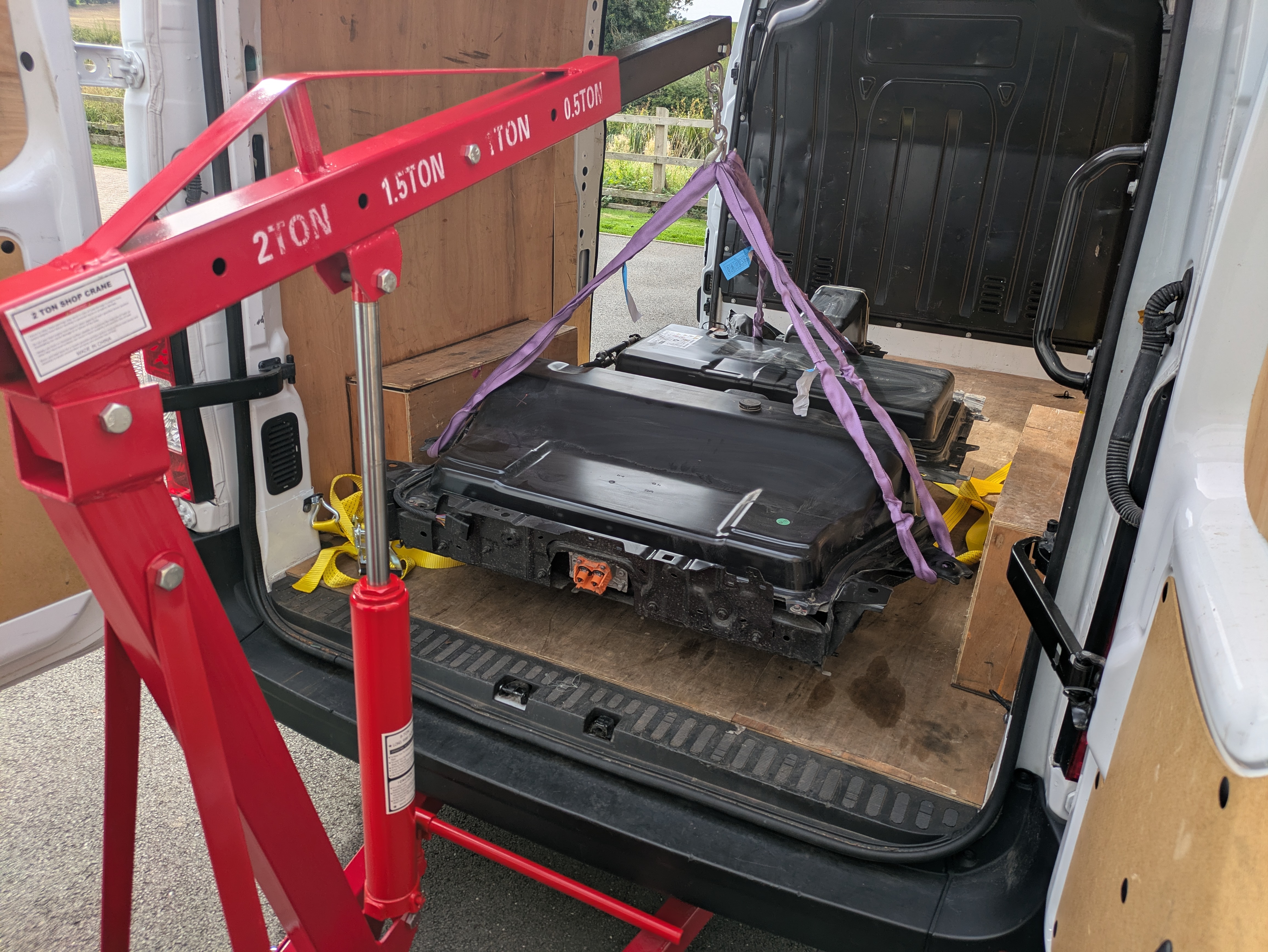

I collected my battery pack over the weekend, and it went remarkably un-sketchy haha.
This is a 50kWh 108S pack found in a variety of Stellantis vehicles, mine is from a 2022 Vauxhall Corsa-e.
All that lovely empty space in my garage is disappearing rather quickly though so I want to get the battery pack taken apart pronto, I made a start but the way it's glued together is proving to be quite a pain.
I've also made good progress on my master BMS for these modules, but that will get its own dedicated topic once it's a bit further along.

EdAtki wrote: Mon Jul 14, 2025 8:11 pm In the meantime I've been trying to get an idea of the performance difference between the leaf motor and a GS450h transmission, trying to convince myself that I'm making the right decision.
The Gen1 Leaf Motor with the standard 80kW inverter feels pretty much the same as the old diesel engine in my Freelander so around 110hp. It's more torquey but about the same power.
If you upgrade to 160hp make sure your cables and connections can cope.

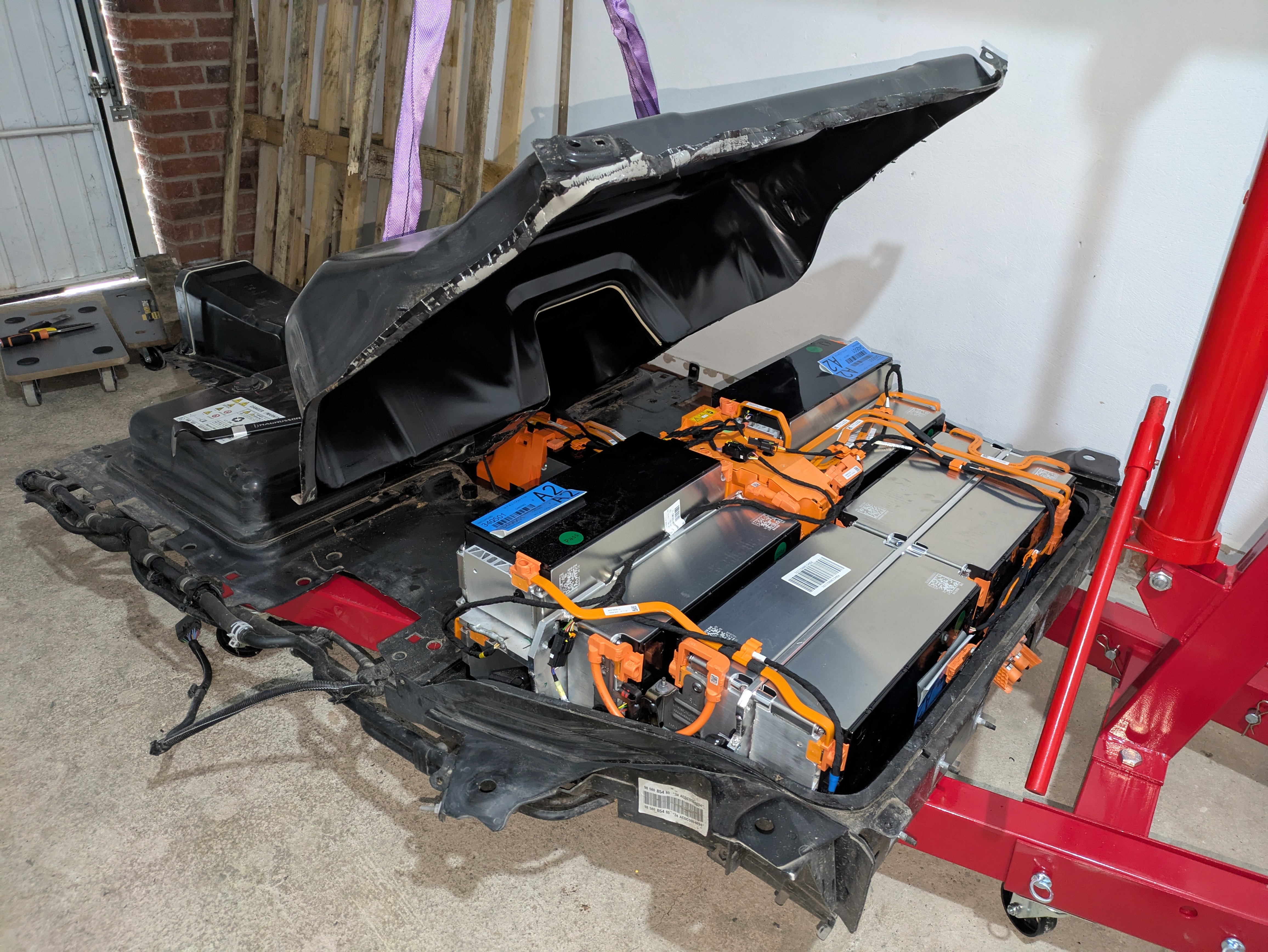

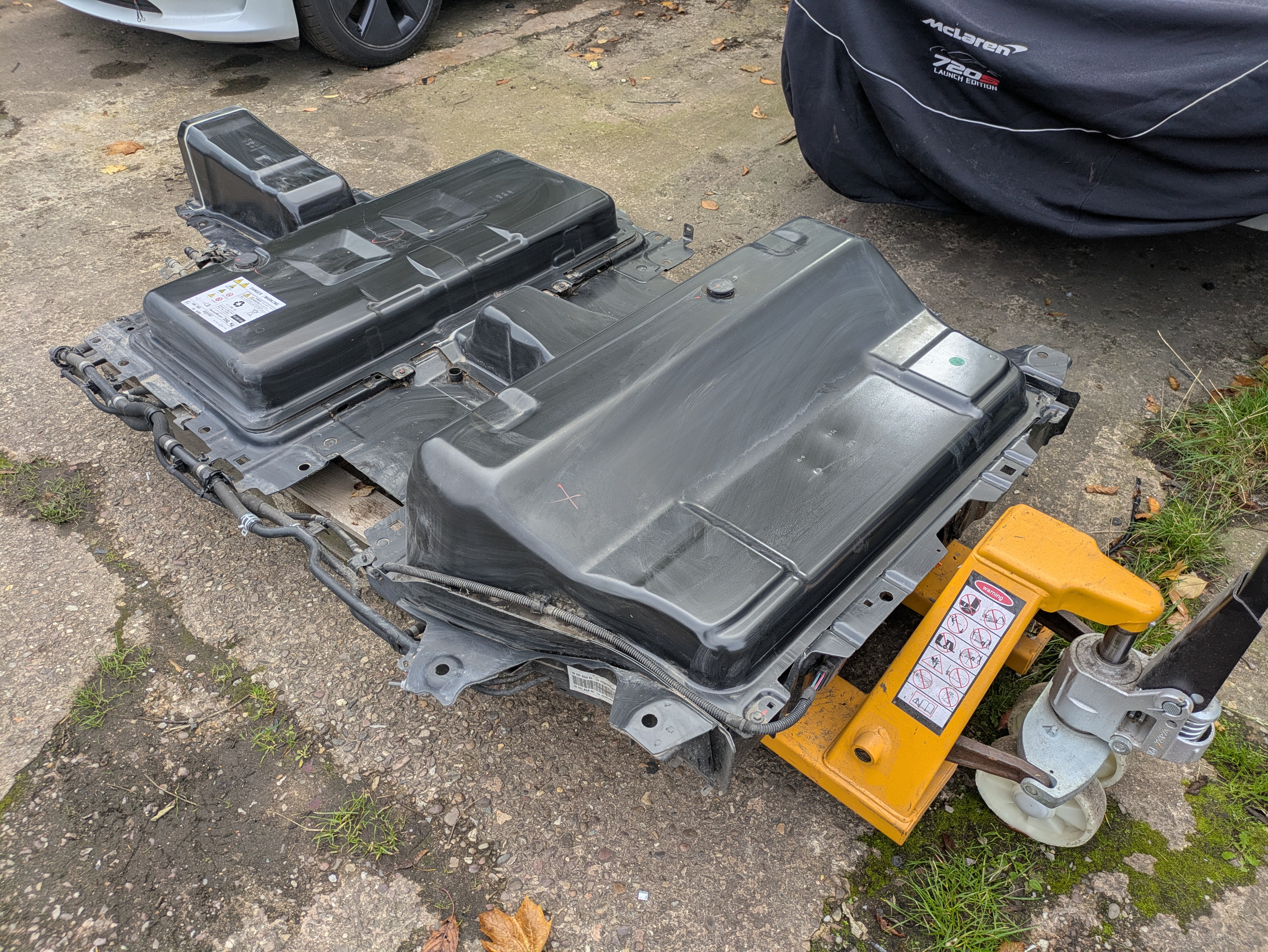

Does anyone have any advice for taking this pack apart? I've got all the bolts out but the glue just will not let go no matter how much I go at it with a heat gun and a crowbar

Hammer and chisel

To open the VW packs I used a short knife to cut the glue and hammered in wooden wedges in as I went. The wedges put pressure on the glue helping force the shell apart and the knife blade was too short to hit the batteries or cables.
Just take your time and be careful not to go too deep.

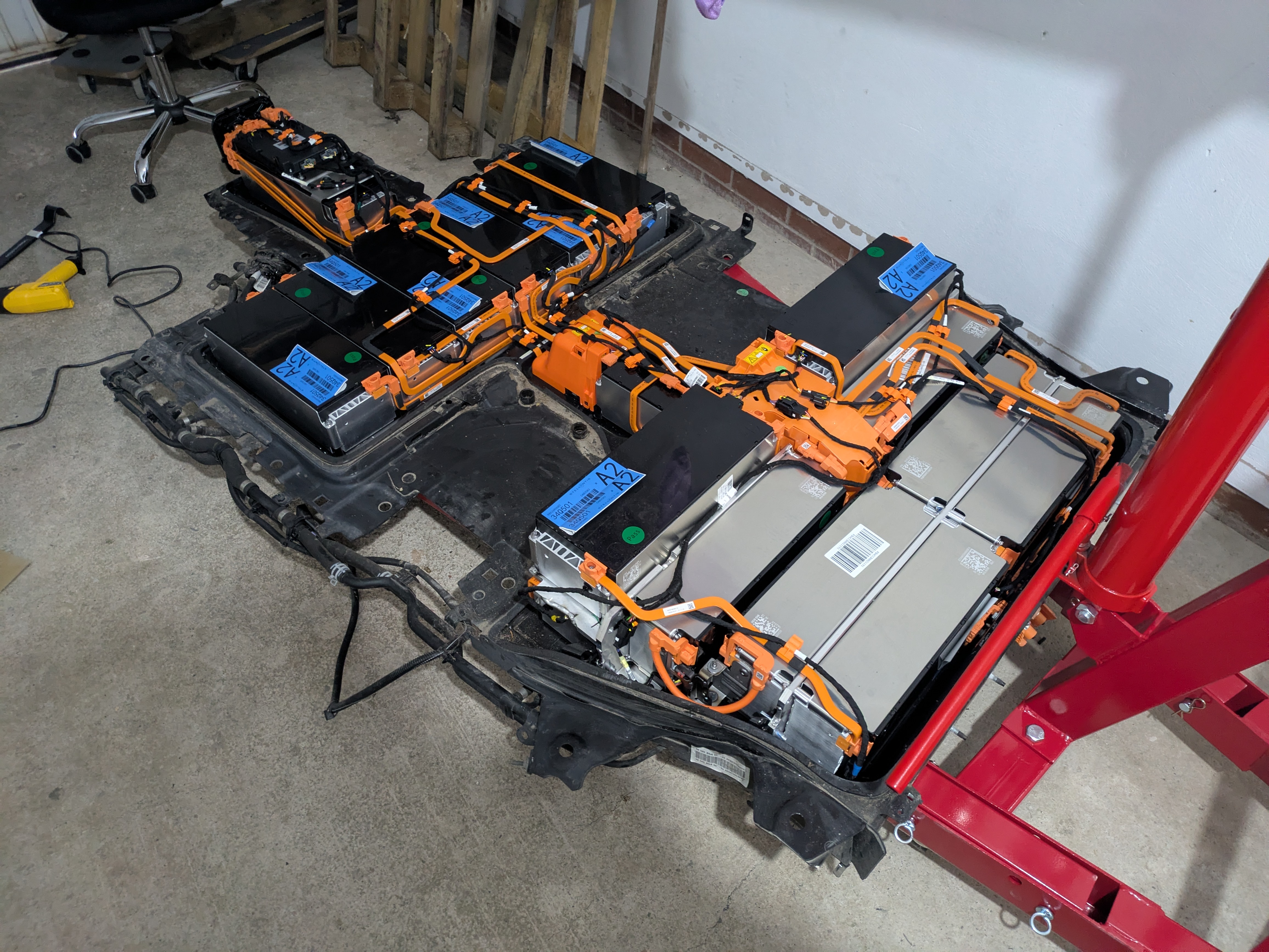

It's open!
I tried both the knife and chisel approaches but both made very slow progress, in the end what worked best was connecting the engine hoist to the bolt tabs on the top half and lifting so that the weight of the pack provided a constant force pulling the halves apart, then I just heated around where the glue is and the pack slowly peeled itself open with only some slight percussive encouragement.
I've measured the voltage of all the modules I could easily get my multi-meter on and each reads 23.7V which works out to 3.95V per cell so all seems healthy so far.
Next up is to remove the modules. I intend to reuse the cooling plates and bus bars if possible so going to try to remove them still in their current groupings.

It looks remarkably like the VW pack, the bussbars are identical.
Good luck with this.

Battery pack disassembly is complete, unfortunately I don't think I'll be able to reuse many of the cooling plates as the modules aren't grouped in the way I first thought.

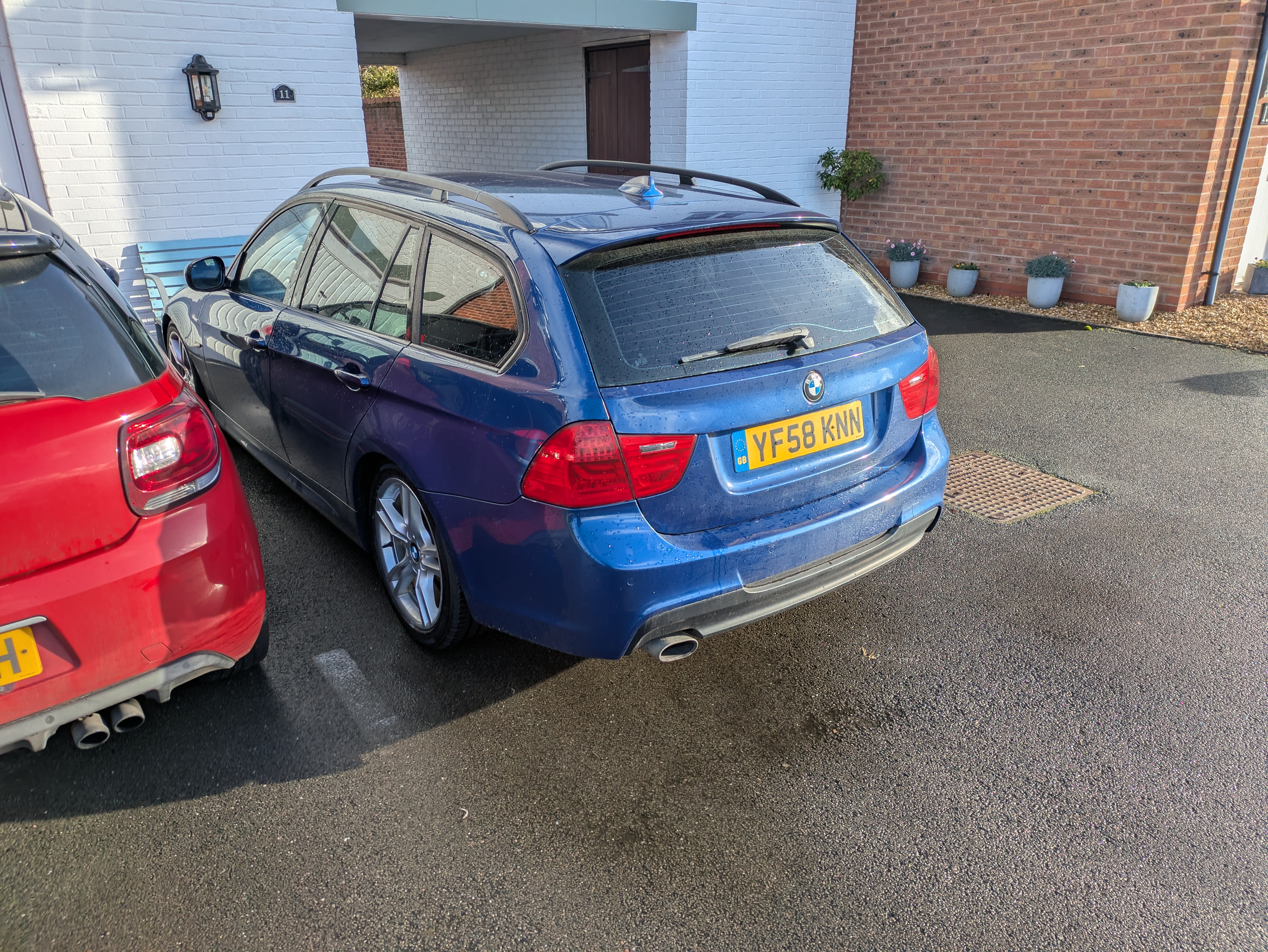

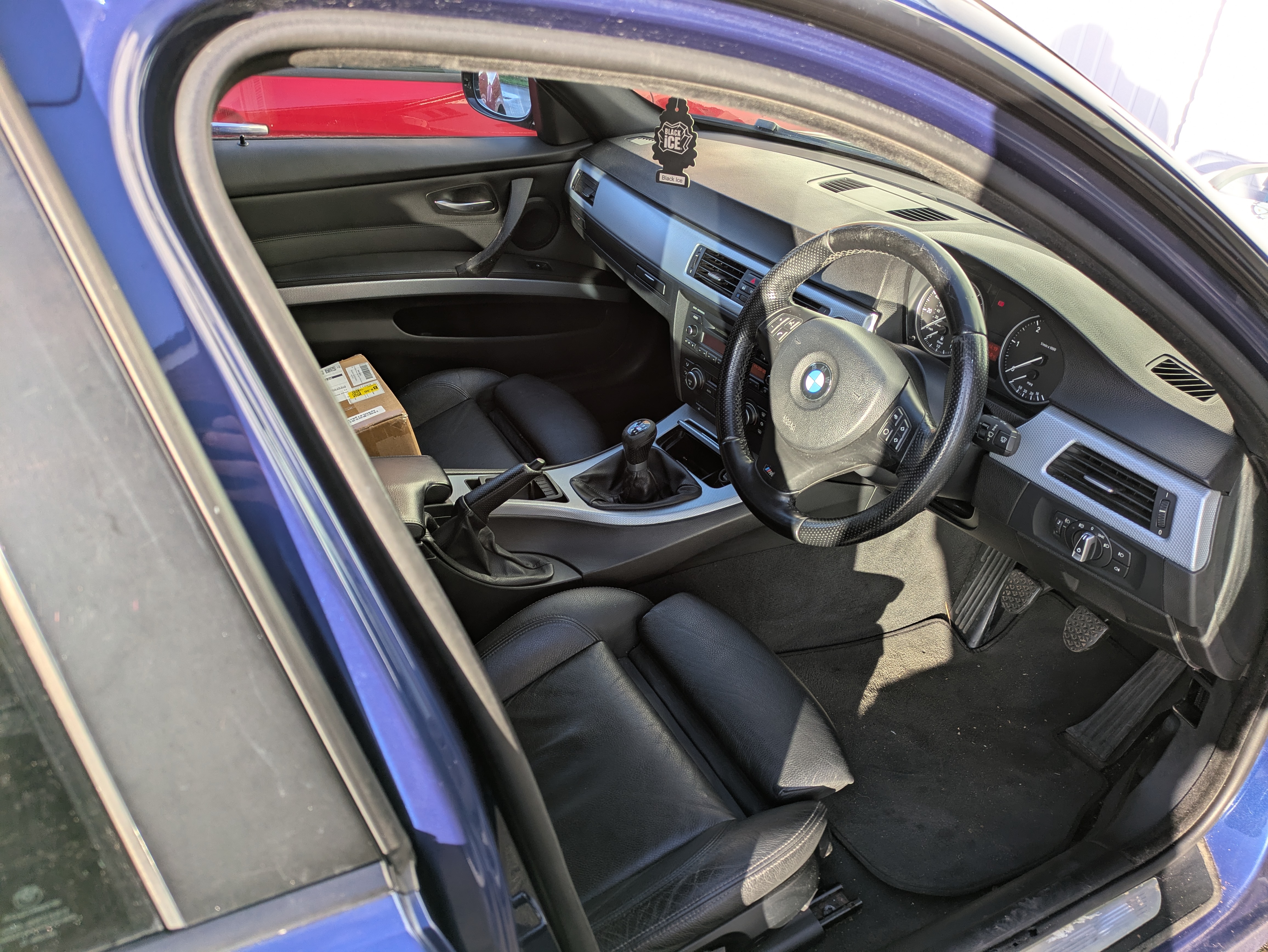

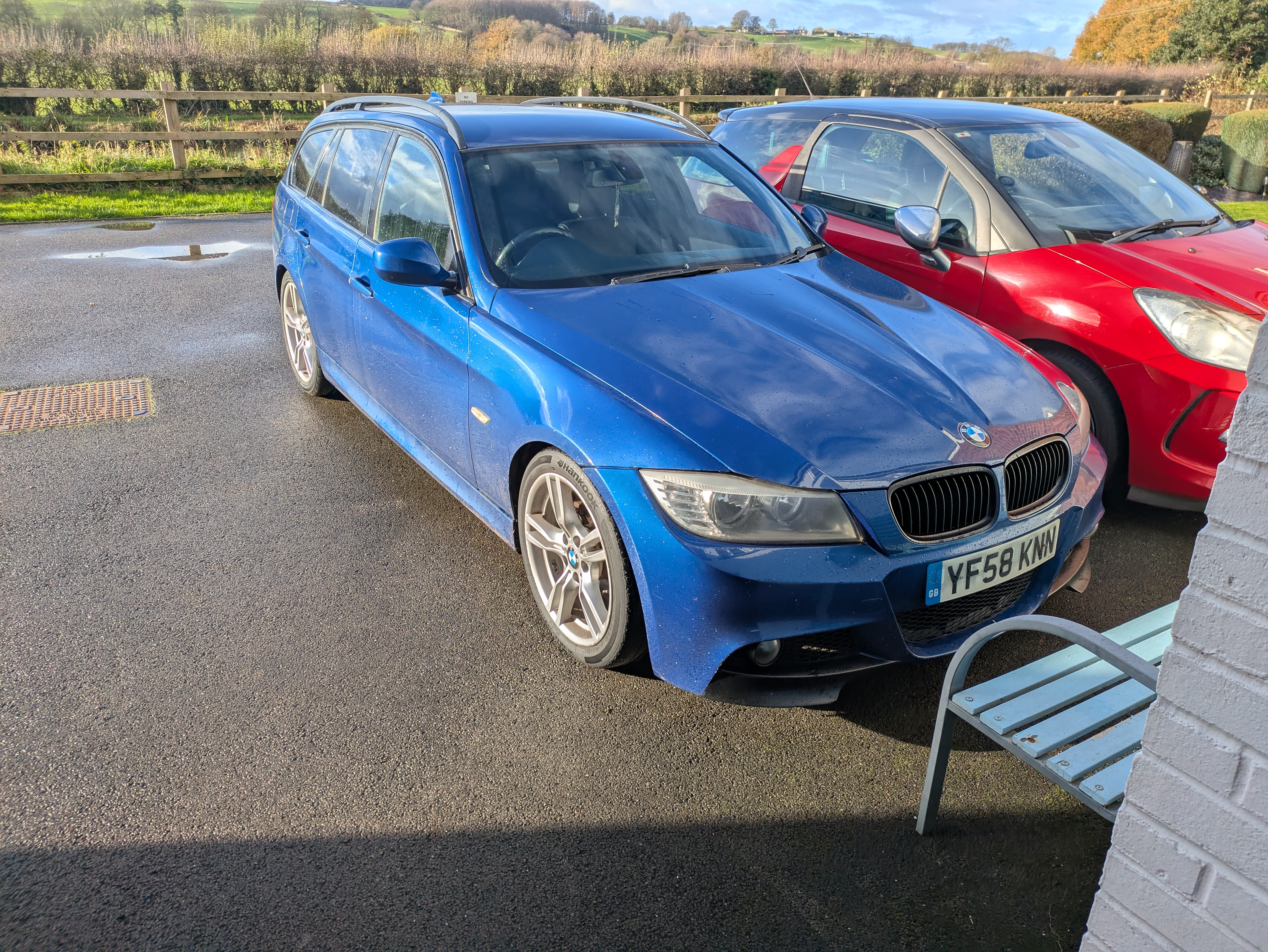

Also I bought the car!
It's a nicer example than I was planning to buy tbh, I was looking at really rough ones with engine failures but then this one popped up near me for a very good price in much nicer condition and higher trim. Not so nice that I'll feel guilty converting it though haha, it was previously written off and has its fair share of issues but nothing too impactful for the conversion process.
Should be plenty of room in the engine bay once the engine is out and it already has electric power steering which is a bonus.
I plan to drive it about in ICE form for a while before I start taking it to pieces. For reference the insurance would have been £400 for the year, I only got temporary cover though as obviously it will be spending a significant amount of time off the road in the very near future.

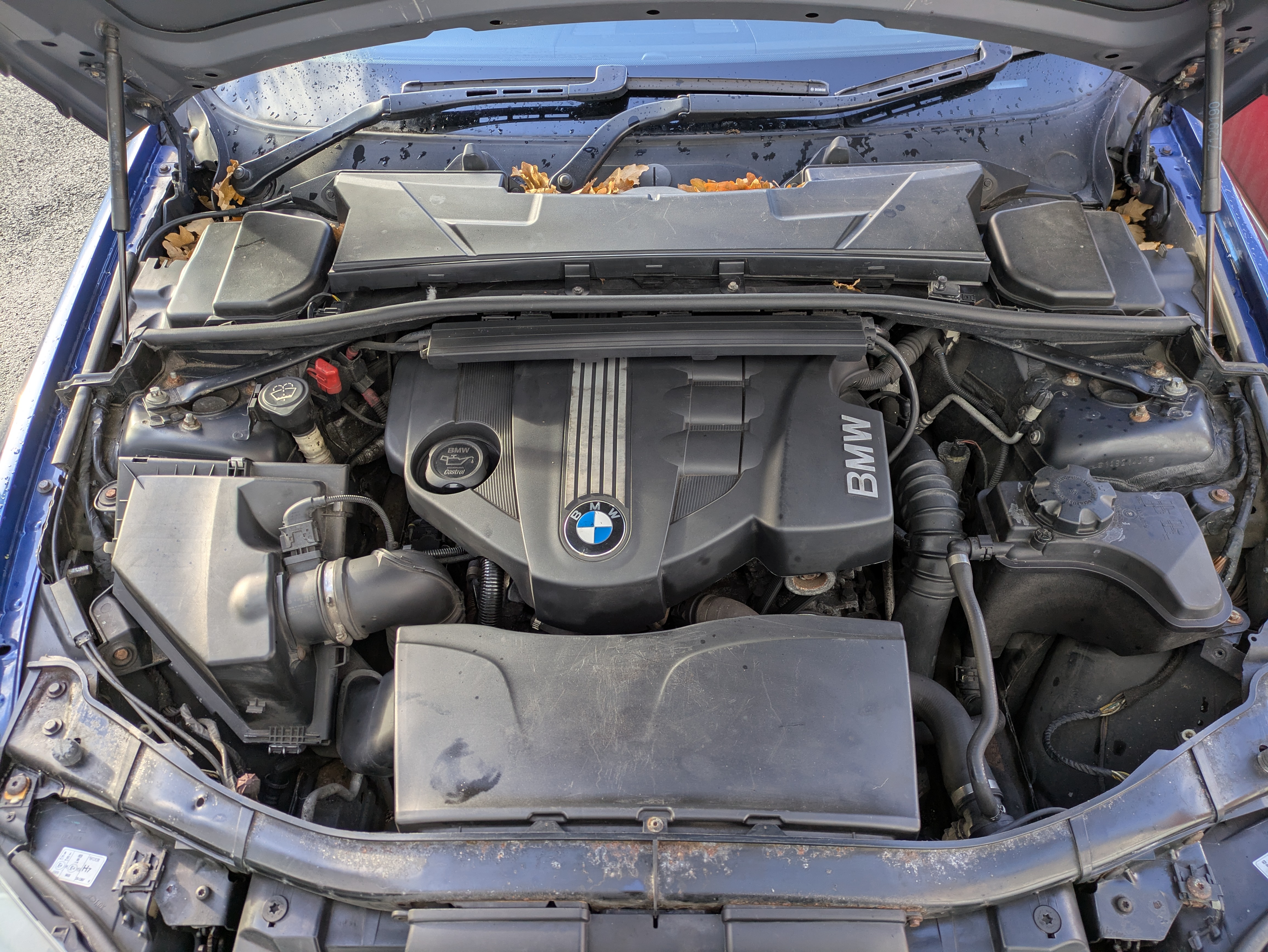

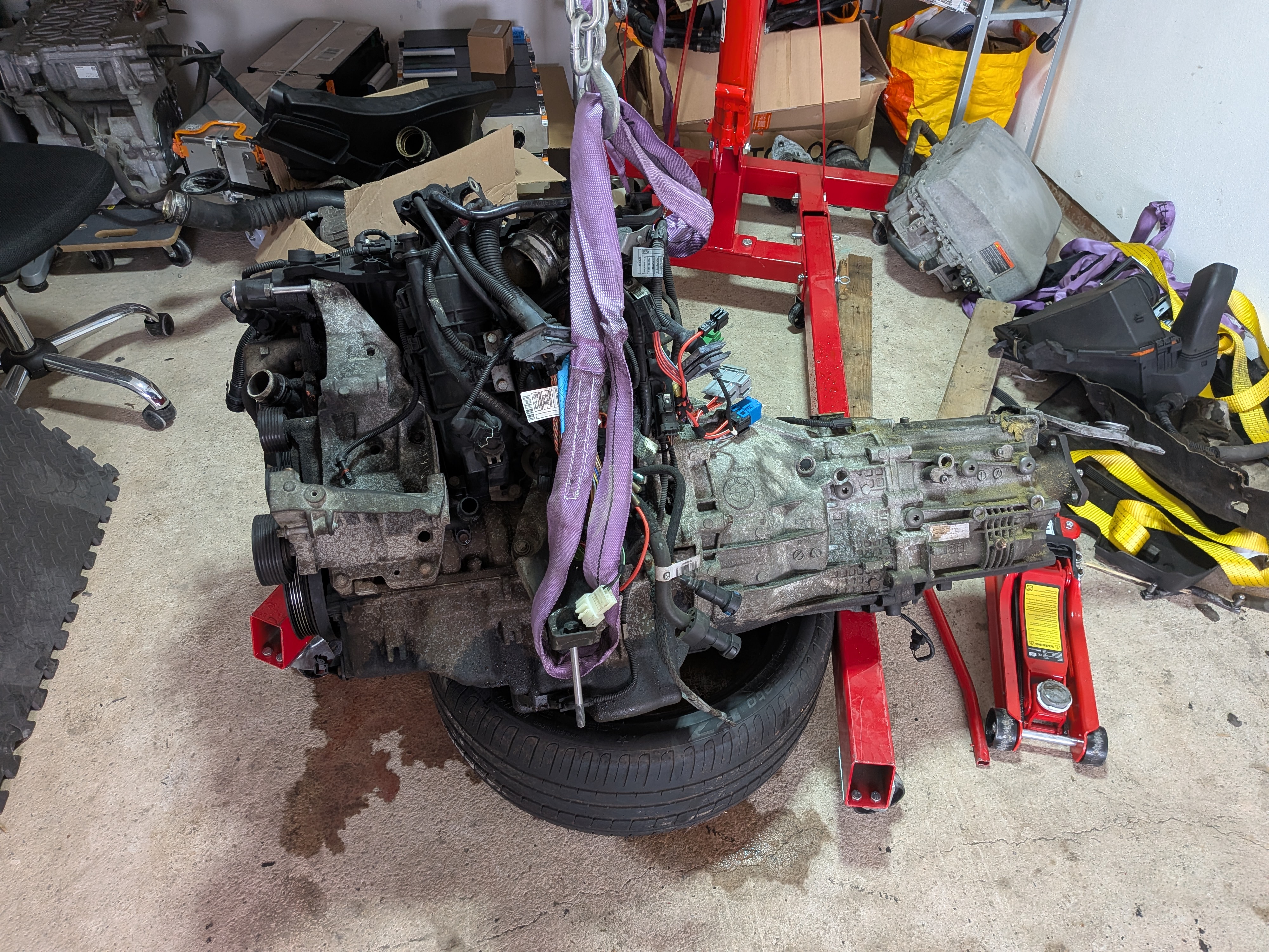

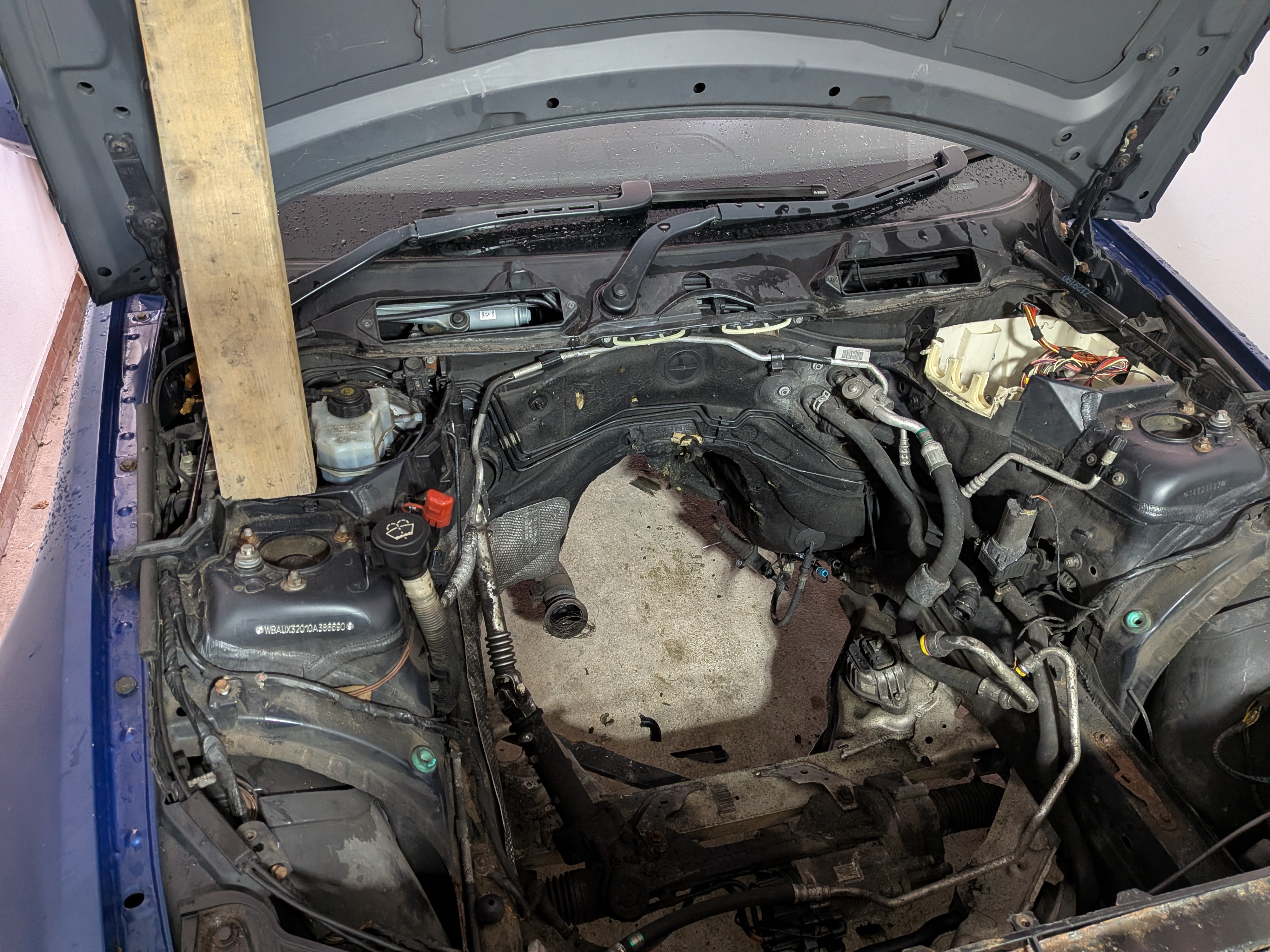

I've started working on the car now that the weather is getting slightly more tolerable. This was my first time removing an engine and it went far from perfect haha but at least it's done
I was so focused on making sure the engine and gearbox cleared everything on their way out that I somehow didn't notice the end of the engine hoist colliding with the bonnet until it was too late so theres a new dent in it which is shame :(
Plenty of space for motor and batteries now though :)
