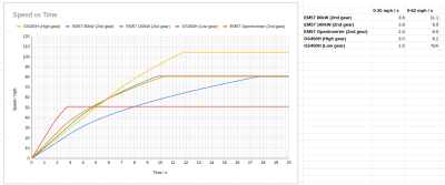

In the meantime I've been trying to get an idea of the performance difference between the leaf motor and a GS450h transmission, trying to convince myself that I'm making the right decision.
I would be amazed if these numbers turn out accurate given all the assumptions and guesswork that went into it but even so it gives me some confidence that the leaf motor will still have plenty of power. Based on this I'll definitely want to upgrade to a 160kW inverter or install the replacement logic board for ~140kW but I think I'll get the car running on the 80kW one first before I splash out.
My whole spreadsheet is here btw if anyone wants to critique it haha: https://docs.google.com/spreadsheets/d/ ... TvPRqJKADw

EdAtki wrote: Mon Jul 14, 2025 8:11 pm In the meantime I've been trying to get an idea of the performance difference between the leaf motor and a GS450h transmission, trying to convince myself that I'm making the right decision.
The Gen1 Leaf Motor with the standard 80kW inverter feels pretty much the same as the old diesel engine in my Freelander so around 110hp. It's more torquey but about the same power.
If you upgrade to 160hp make sure your cables and connections can cope.
