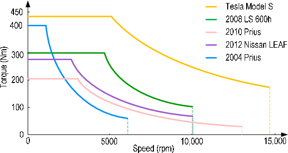

Making the measurements would need a LCR meter. This is the one that EV8 and Bigpie have used to take the same measurements viewtopic.php?p=47388#p47388 and this is how I took the measurements on mine viewtopic.php?p=47050#p47050
Got to say my feeling is that the gen3 will be disappointing in a larger vehicle but that does depend on what your performance expectations are and how heavy the estate is.
This is the plot I've seen which which indicates how the gen2 and gen3 compare with each other, and also with other motors. Found here https://www.semanticscholar.org/paper/S ... 5db9322241 - no idea how accurate it is.
If you're invested in the gen3 then it's probably worth taking the measurements to see what might be possible otherwise decide what performance you are looking for and then base the motor choice on that.
It's also worth noting that battery voltage will have an impact on motor performance so you need to know what you will be running and as Romale mentioned the Prius motors normally run at higher voltages (500-600V) so you are not going achieve the performance shown on the graph with a lower voltage pack.
Edit - Bigpie beat me to it
Edit2 - Just remembered this post viewtopic.php?p=46927#p46927 which suggests inductance values for the Gen3 that are the same as the ones Johannes is using on the gen2. That would suggest that there won't be an improvement moving from the gen2 to the gen3

It's designed for and rated to a higher RPM. Which is a way of getting more power out of the same package, by spinning it faster.
It runs on higher voltage.
The inverter is more powerful. I think roughly each generation is like, 15-20% more powerful than the previous.
But as someone else said, being designed for a higher voltage makes it less usable for a lower voltage.

Yes, but it also has twice the gearing ratio, so the extra rpm is "lost".MattsAwesomeStuff wrote: ↑Thu Nov 10, 2022 7:53 am It's designed for and rated to a higher RPM. Which is a way of getting more power out of the same package, by spinning it faster.
