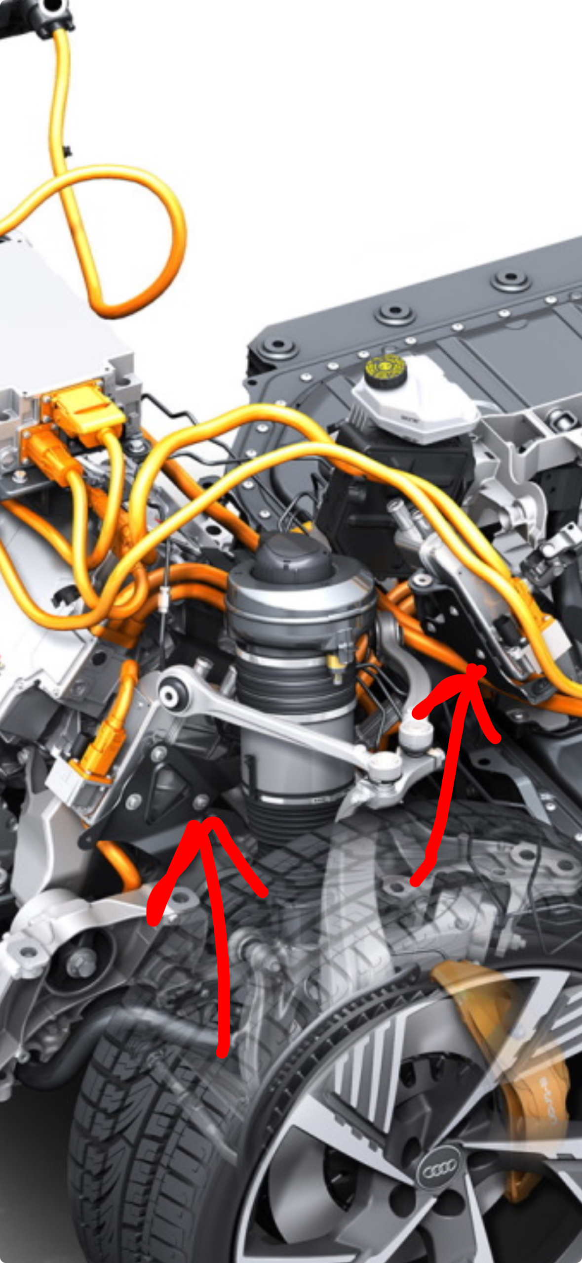

Should the coolant flow be reversed then too, to enter through the physically lower port and exit via the physically higher port? Or doesn’t matter?
Also, if this is the same heater as used in the audi etron this is how weirdly they mount them- one for battery heating, another for the cabin heating.

Its interesting that the Audi pic has the heaters at around 45 degrees although this would I assume ensure that no air is trapped around the heater elements. It certainly doesn't like being horizontal with the plugs at the top!alexbeatle wrote: ↑Thu May 01, 2025 1:35 pm Should the coolant flow be reversed then too, to enter through the physically lower port and exit via the physically higher port? Or doesn’t matter?
Normally you would ensure that coolant entered the lower port and exited the higher port. This would also ensure that any air is flushed out.
