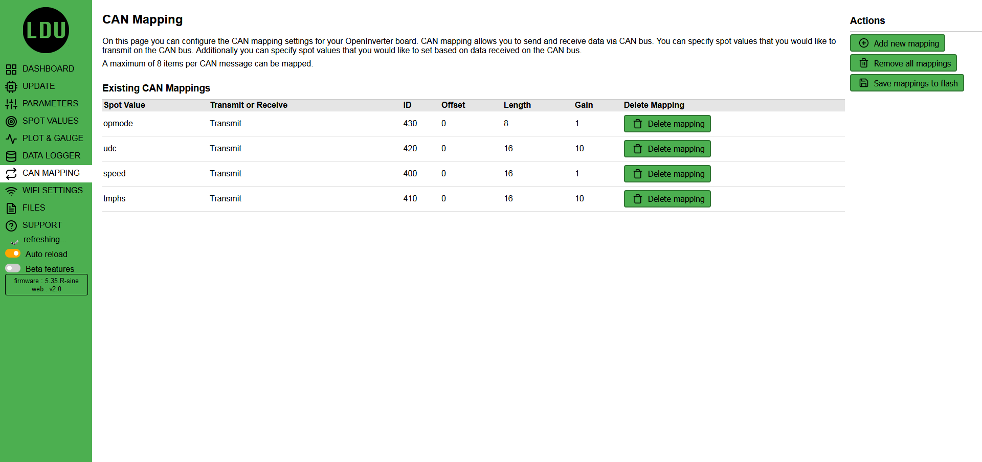

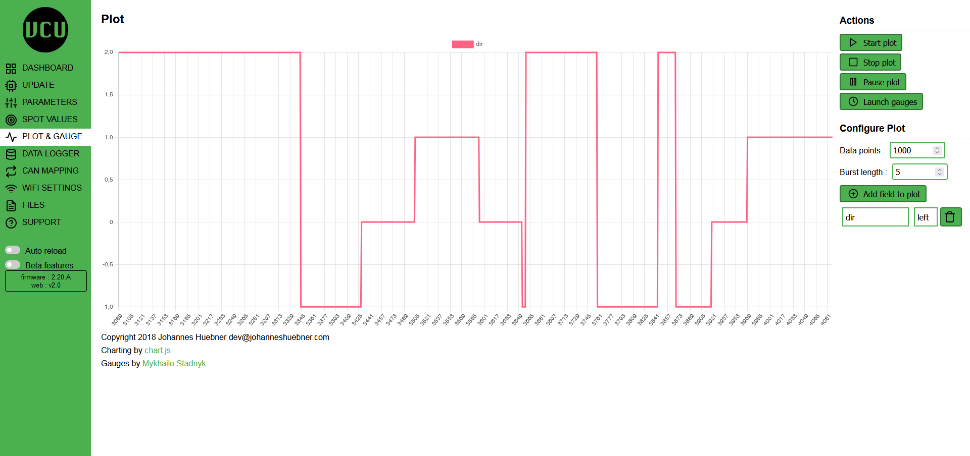

For testing I have the Land Rover Gear Lever, which also works wonderfully on the VCU, but VCU does not transmit the drive direction to LDU. Is there a reason for this or do I have to map it.

Yes you need to map it in the DU.
Info is in this thread: viewtopic.php?t=3609
It is on the list of being improved to an automatic configuration.

So, I've been trying for some time to transfer the gears from the zombieverter to the LDU, but I just don't understand the CAN mapping, I have also read the can communication on the wiki several times, but unfortunately I don't understand it, I know that you have to set the whole thing on the LDU, the CANIO to receiver, but I don't know how or what, a small example for better understanding would also help
The accelerator pedal values ​​are transferred from the VCU to the LDU side without changing anything, just not the rest

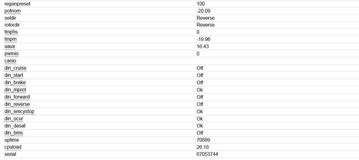

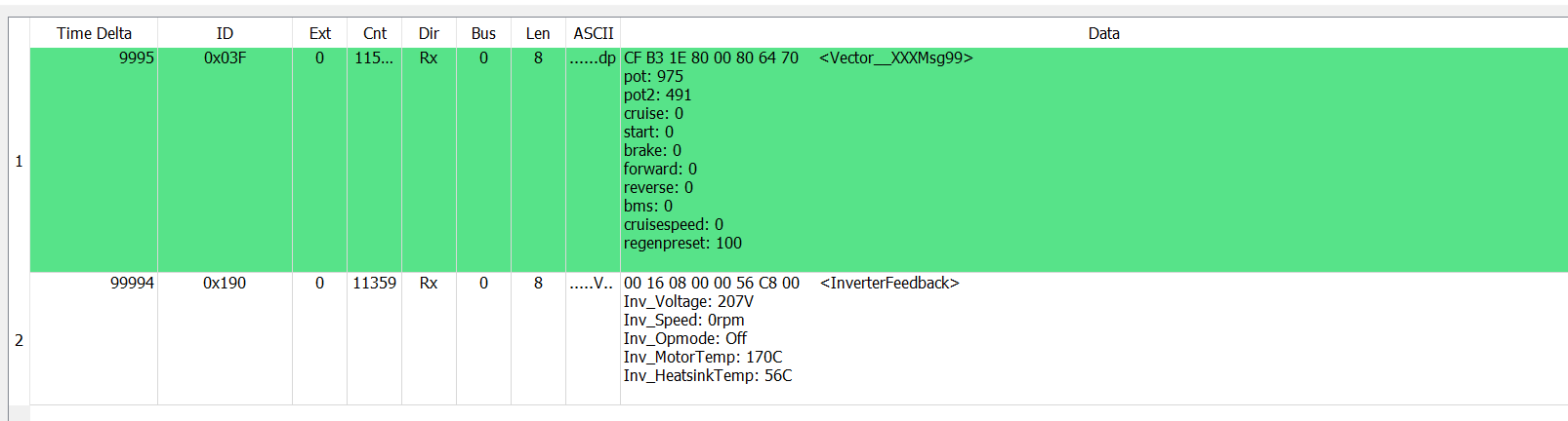

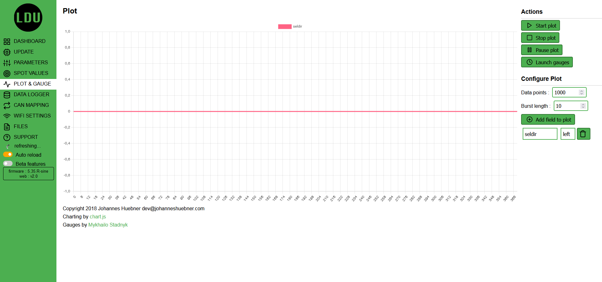

forward (din_forward) and reverse (din_reverse) works and is also displayed on the LDU Web, but if you go to park or neutral, the last drive direction is displayed, but din_forward and din_reverse are set to 0

medo wrote: Thu Feb 27, 2025 1:49 pm park or neutral, the last drive direction is displayed,
You need to change the type of dir switch used for the LDU to button.
Please keep in mind most of the OI Params in the LDU will still need to be set propperly.

Re: VCU does not transmit the drive direction to LDU
Post by medo »
it was already set to a button, I changed it to a switch, now it is also displayed, but the parking position is displayed as neutral, possibly this position is not implemented in the LDU
medo wrote: Thu Feb 27, 2025 2:30 pm possibly this position is not implemented in the LDU
No it is not. So it will show neutral.
