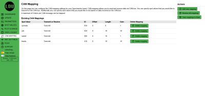

Re: VCU does not transmit the drive direction to LDU
So, I've been trying for some time to transfer the gears from the zombieverter to the LDU, but I just don't understand the CAN mapping, I have also read the can communication on the wiki several times, but unfortunately I don't understand it, I know that you have to set the whole thing on the LDU, the CANIO to receiver, but I don't know how or what, a small example for better understanding would also help
The accelerator pedal values are transferred from the VCU to the LDU side without changing anything, just not the rest
In version 5.32.R and up direction is no longer mappable but has a fixed mapping.

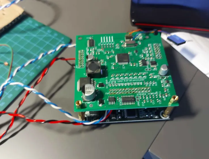

Update the testing branch after bench testing with my mini board running stm32_sine.
Updates can be found in the Vehicle Testing Branch. https://github.com/damienmaguire/Stm32- ... le_Testing
As always this is to be run at your own caution, please test that the spot values populate as they should before attempting any driving.

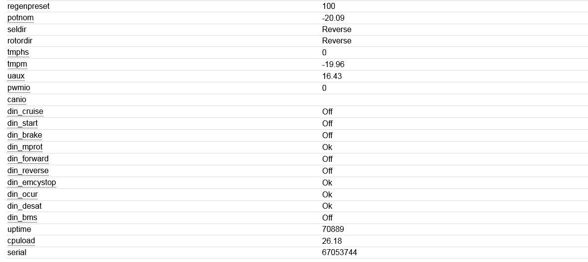

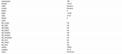

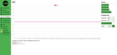

forward (din_forward) and reverse (din_reverse) works and is also displayed on the LDU Web, but if you go to park or neutral, the last drive direction is displayed, but din_forward and din_reverse are set to 0
- Posts: 2962
- Has thanked: 329 times
- Been thanked: 847 times
You need to change the type of dir switch used for the LDU to button.
Please keep in mind most of the OI Params in the LDU will still need to be set propperly.
- medo
- Posts: 207
- Joined: Thu Dec 07, 2023 9:32 pm
- Location: Kosova
- Has thanked: 21 times
- Been thanked: 4 times
it was already set to a button, I changed it to a switch, now it is also displayed, but the parking position is displayed as neutral, possibly this position is not implemented in the LDU
