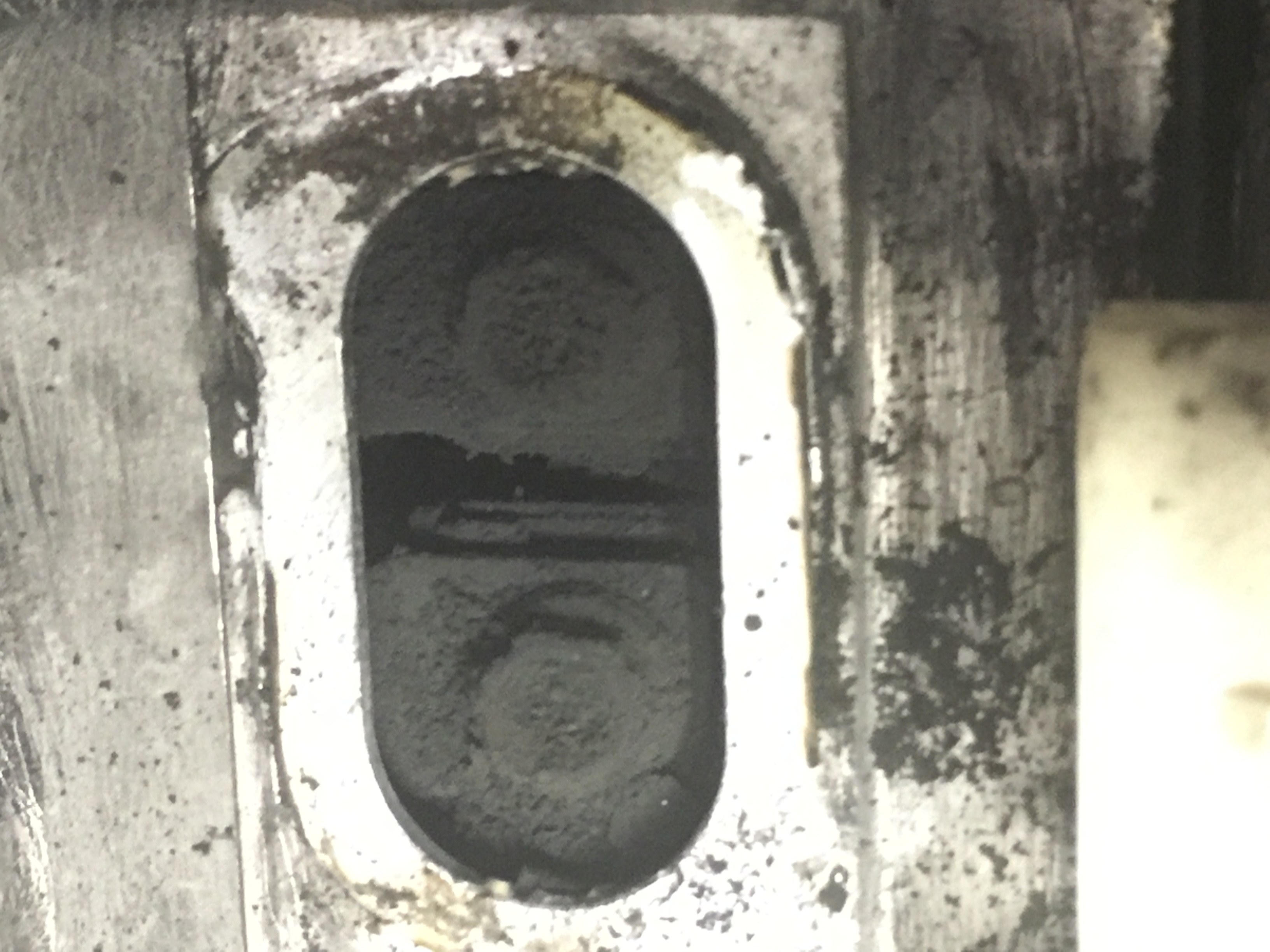

I finally got a donor Lexus GS450h home in the shed - the idea being to use as much of it as possible to convert a 1951 Hudson Pacemaker into a user-friendly EV. I have Damien's V1 controller board for the GS450h inverter but haven't tested it yet.
This GS450h was advertised as 'theft damaged' with no key. Thankfully I found a key under a pile of trim on the passenger seat. The 12v battery is missing, the NiMh traction battery is disconnected, and various looms are disconnected under the bonnet. What looks like the original (charred) inverter/converter was sitting in the trunk. There's a replacement inverter/converter installed under the bonnet, and a replacement ABS ECU appears to have been fitted. Lots of pages of tech data was inside the cabin as though the workshop had tried valiantly to get the car fixed but failed, hence it was written off by the insurance company. Basically a mystery for me to solve!
Firstly the charred inverter/converter - how it got so charred - something shorted, maybe. Better find some high voltage gloves before I go much further ... The Lexus and the Hudson:

Not sure how internal damage to the inverter can create charring on the outside. I'd open that thing up and have a look inside. If you're lucky, you may have another working inverter.
I've seen a "blown" GS450h inverter before, it was pretty spectacular inside.

Looks like the charring on the outside came from the vent hole under the black cover - here's what the DC bus/cap connectors (?) look like! Seems there's very little magic smoke left inside this thing
all I can smell is entrails ...

Now I see what a GS450h inverter looks like inside. Seems to have experienced a thermal event of some kind ... still got me mystified as to how 'theft damage' resulted in this much smoke escaping.

Re: Hudson GS450h Pacemaker
That looks like a high current, low voltage event rather than something on the HV. All the HV gear I have blown up goes bang and flies to bits without much smoke. Unless there was water in it, then fun stuff like that happens

They might tried to tow that vehicle while it was shut down and MG2/MG1 did its magic

yes Konstantin, that's exactly what I was thinking last night - either the thing was towed or rolled down a hill...konstantin8818 wrote: ↑Sun Mar 22, 2020 4:23 pmThey might tried to tow that vehicle while it was shut down and MG2/MG1 did its magic![]()
Dilbert - the main cap measures correct capacitance, and later this morning I'll check it for leakage on my old Sprague TO-5!
I'm wondering if the converter side of this box is still functional, or at least has some bits I can salvage...not exactly a priority now but just a thought.

Nah, the main cap measures perfect using my old 'capacitor analyzer'! The power stage went poof and I think the stator windings in both MG1 and MG2 are partially shorted.

Is this smoke trying to tell me something ...
