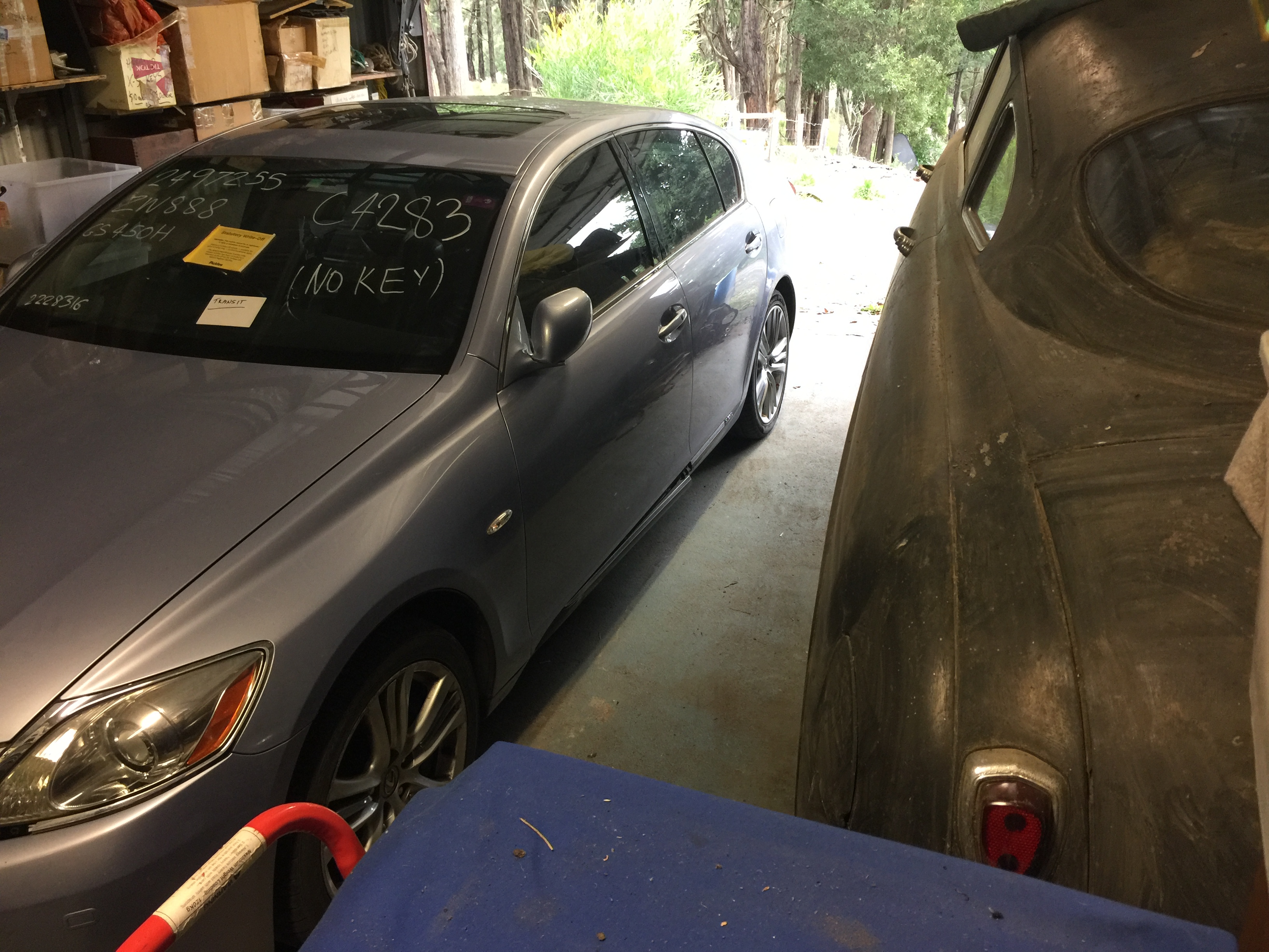

I finally got a donor Lexus GS450h home in the shed - the idea being to use as much of it as possible to convert a 1951 Hudson Pacemaker into a user-friendly EV. I have Damien's V1 controller board for the GS450h inverter but haven't tested it yet.
This GS450h was advertised as 'theft damaged' with no key. Thankfully I found a key under a pile of trim on the passenger seat. The 12v battery is missing, the NiMh traction battery is disconnected, and various looms are disconnected under the bonnet. What looks like the original (charred) inverter/converter was sitting in the trunk. There's a replacement inverter/converter installed under the bonnet, and a replacement ABS ECU appears to have been fitted. Lots of pages of tech data was inside the cabin as though the workshop had tried valiantly to get the car fixed but failed, hence it was written off by the insurance company. Basically a mystery for me to solve!

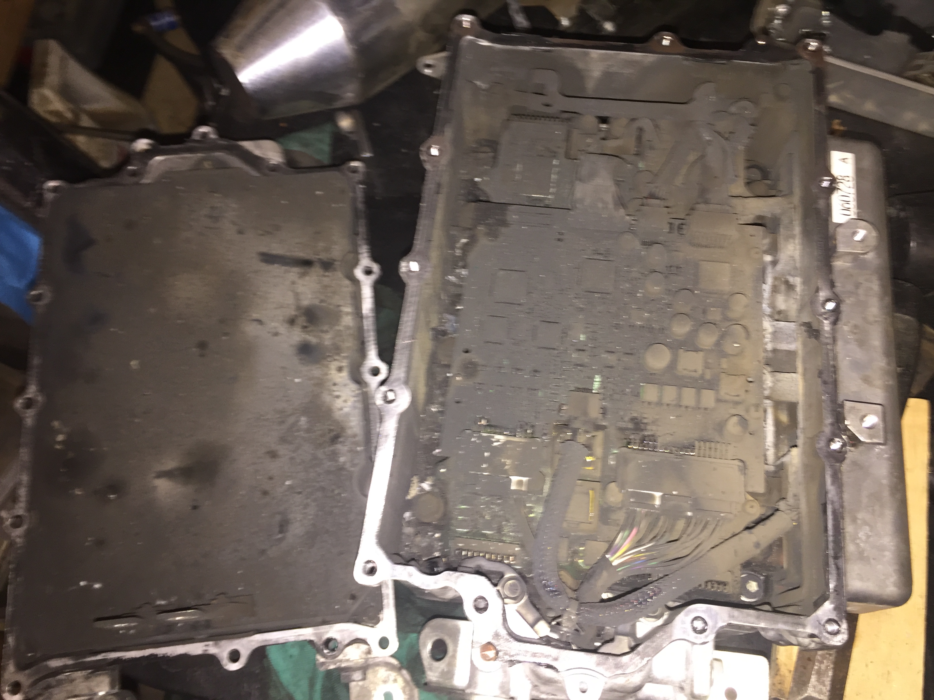

Firstly the charred inverter/converter - how it got so charred - something shorted, maybe. Better find some high voltage gloves before I go much further ...
The Lexus and the Hudson:

Not sure how internal damage to the inverter can create charring on the outside. I'd open that thing up and have a look inside. If you're lucky, you may have another working inverter.
I've seen a "blown" GS450h inverter before, it was pretty spectacular inside.

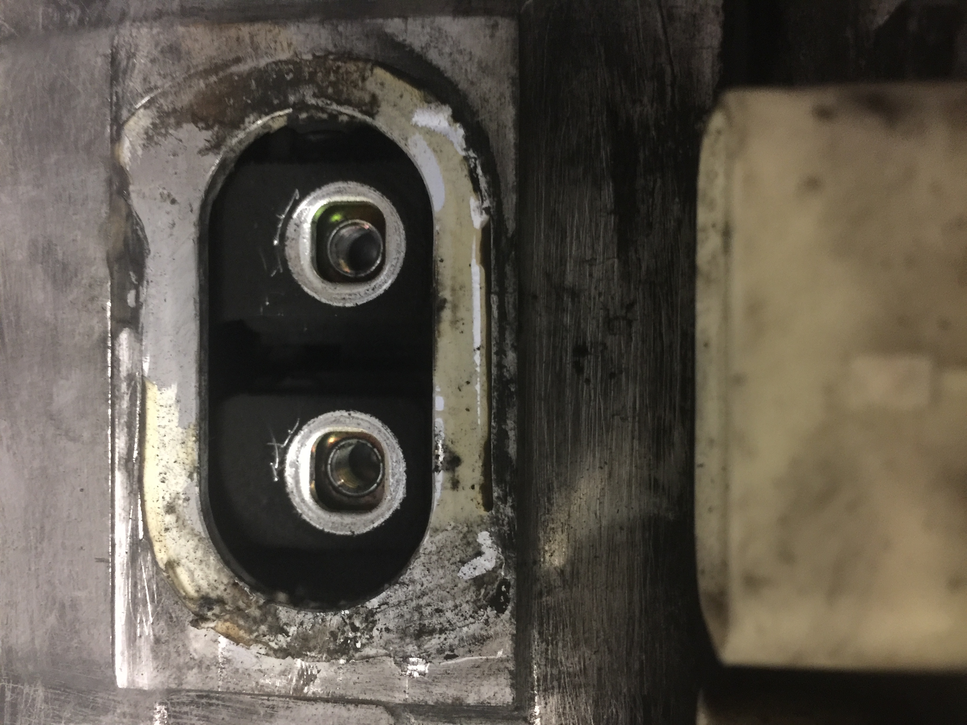

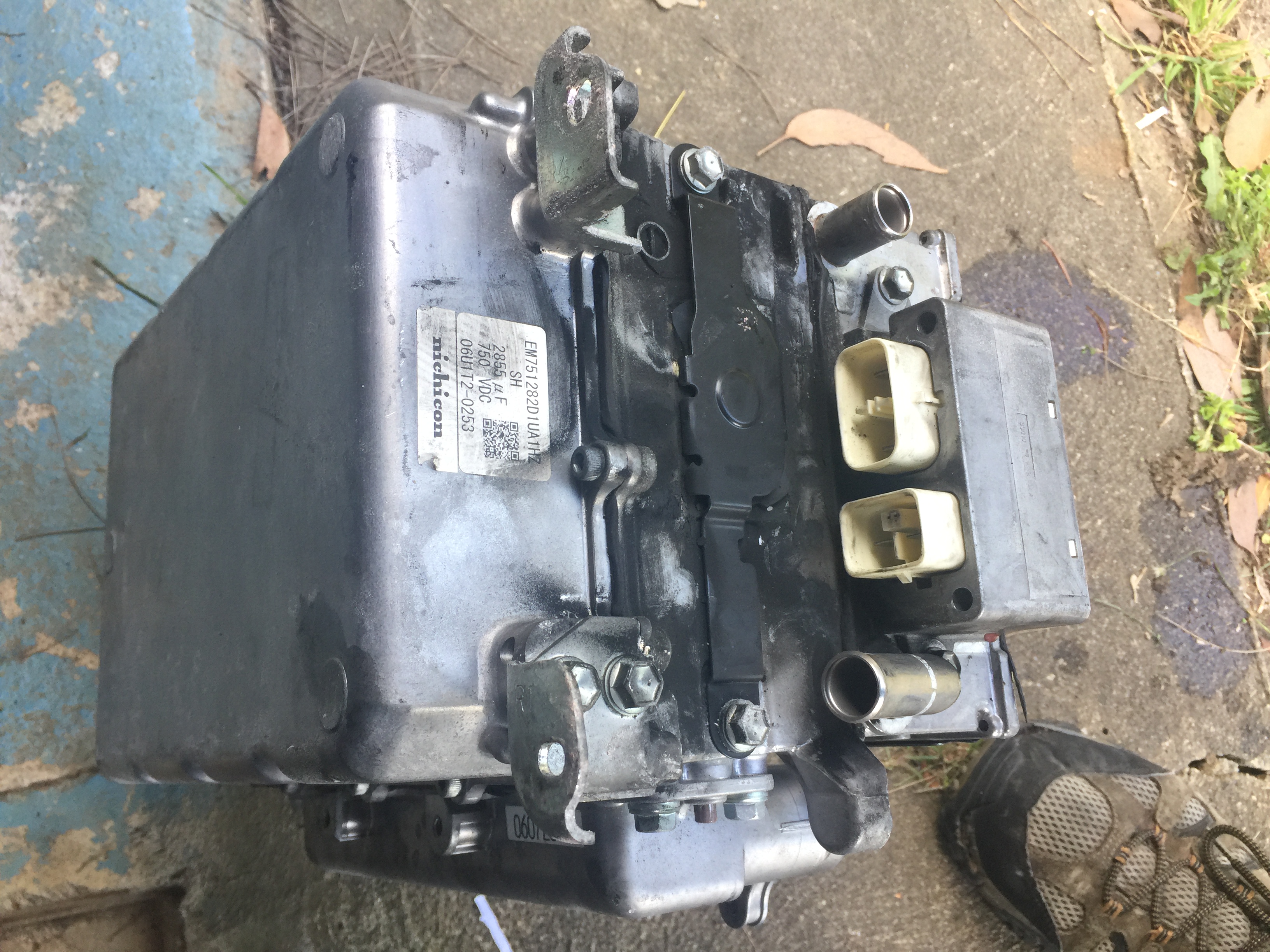

Looks like the charring on the outside came from the vent hole under the black cover - here's what the DC bus/cap connectors (?) look like! Seems there's very little magic smoke left inside this thing :shock: all I can smell is entrails ...

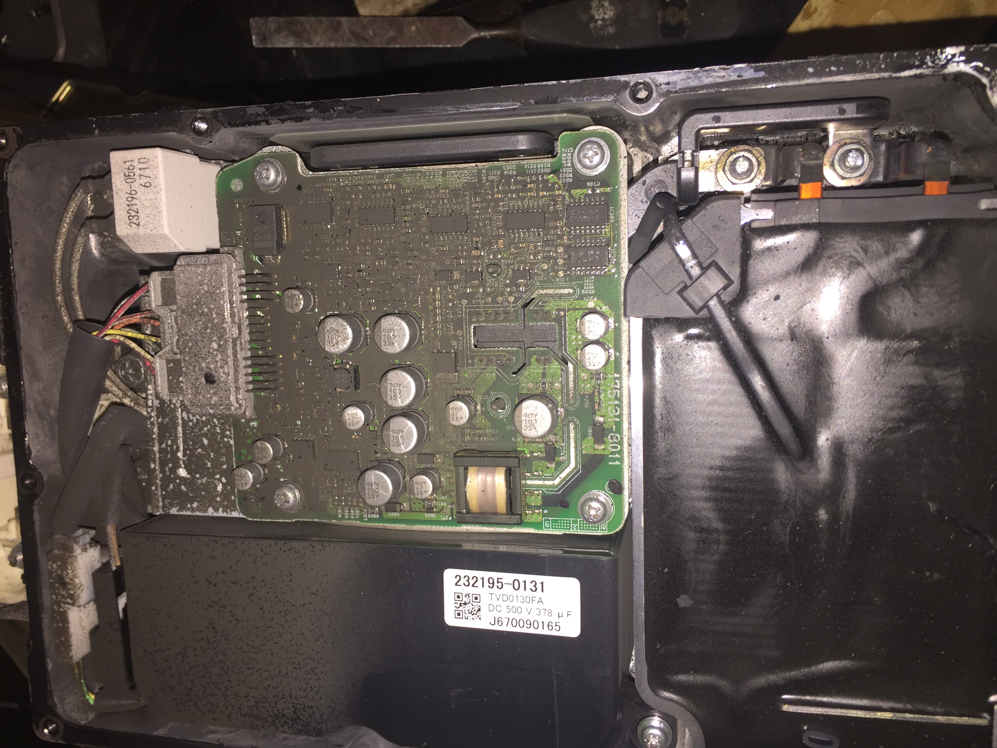

Now I see what a GS450h inverter looks like inside. Seems to have experienced a thermal event of some kind ... still got me mystified as to how 'theft damage' resulted in this much smoke escaping.

That looks like a high current, low voltage event rather than something on the HV. All the HV gear I have blown up goes bang and flies to bits without much smoke. Unless there was water in it, then fun stuff like that happens
Dilbert
Posts: 410
Location: Dublin, Ireland
Re: Hudson GS450h Pacemaker
Post by Dilbert »
Did the main cap let go, rather than the power stage?

Dilbert - the main cap measures correct capacitance, and later this morning I'll check it for leakage on my old Sprague TO-5!
I'm wondering if the converter side of this box is still functional, or at least has some bits I can salvage...not exactly a priority now but just a thought.

Dilbert wrote: Sun Mar 22, 2020 12:43 pm Did the main cap let go, rather than the power stage?
Nah, the main cap measures perfect using my old 'capacitor analyzer'! The power stage went poof and I think the stator windings in both MG1 and MG2 are partially shorted.

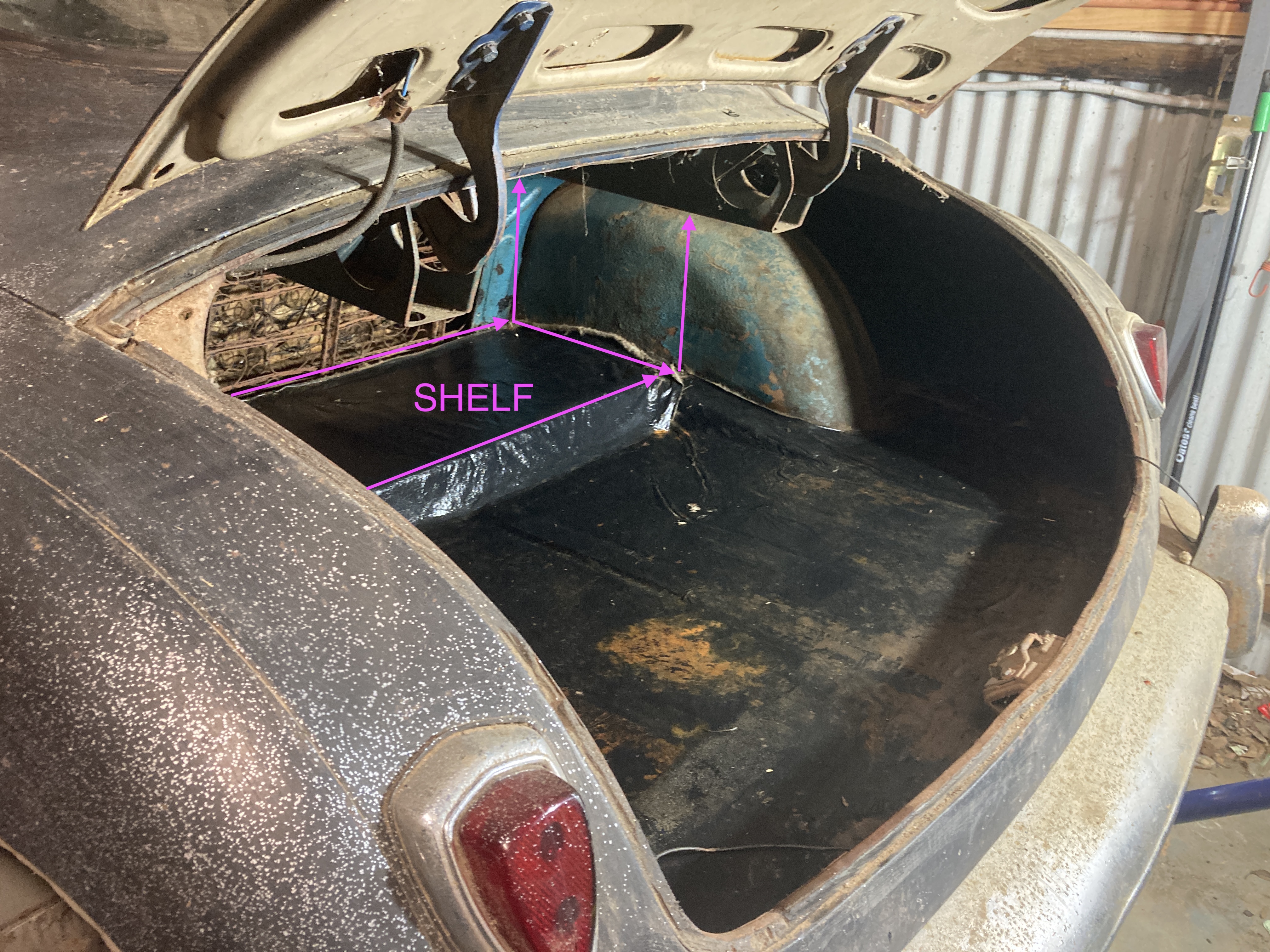

Planning for battery location/s -
I'm thinking to put a spare tyre under the boot (trunk) floor where the fuel tank previously resided. The Hudson boot is over 1.2m long so I have some space to play with for batteries, but plan to put most of the batteries in the engine bay to keep weight distribution roughly how a GS450h would have it. I expect I'll be fitting a fair bit of Lexus running gear into this old hulk...
I want to keep some practical space in the boot for normal use, so the logical rear battery space is the shelf behind the back seat. Boot 'shelf' above the diff measures 1070W x 355H x 410L, but I can extend a bit into the main boot space as required I guess.
I put my name down for 24 of the BMW hybrid batteries if the group buy goes ahead. Perhaps I could aim to fit 36 but I need to find realistic sizing data. The packs of 6 are a shape to suit the BMW hybrid platform and not so space efficient for conversions so I'll be stripping them down and re-configuring them into the available spaces in the Hudson. I read somewhere that 'BMW' cells are 369mm x 178mm x 102mm each but not sure if these are the same ones in the BMW hybrids. Searching the wiki and threads here on open inverter I haven't found cell dimensions yet.
So I'm curious what are the dimensions of the cells inside those BMW hybrid HV packs?
EDIT: I found a post by Celeron55 about BMW module dimensions: "I didn't measure very accurately but a module without BMS is something like 364*183*110mm and the BMS adds about 25mm to length or height depending where you install it."
