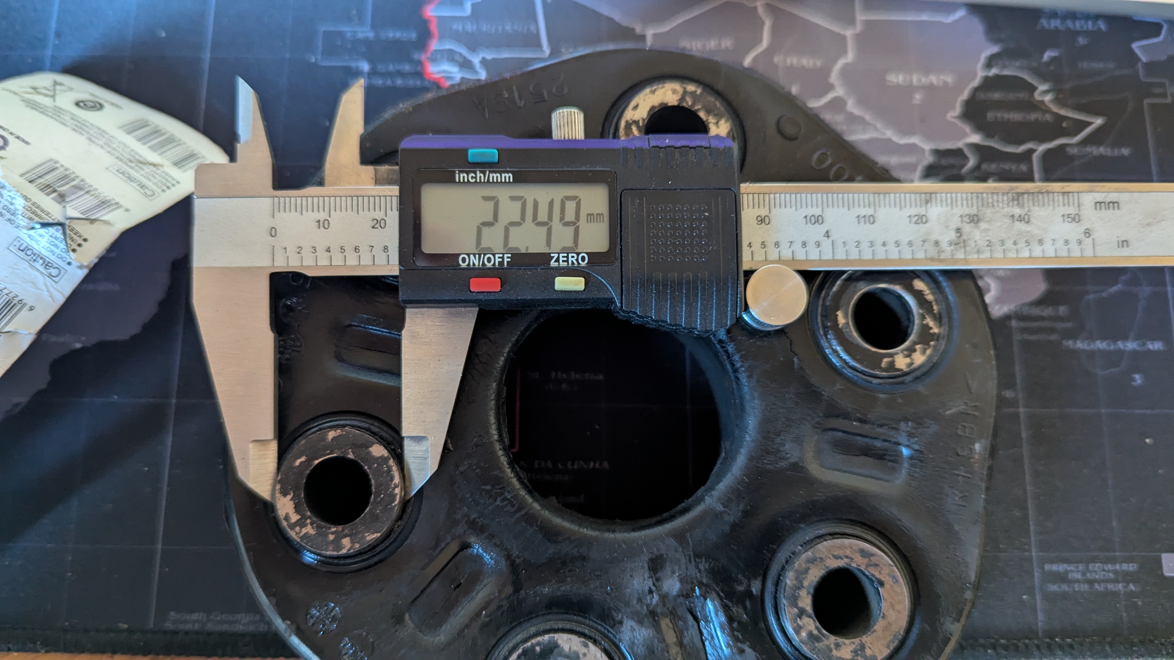

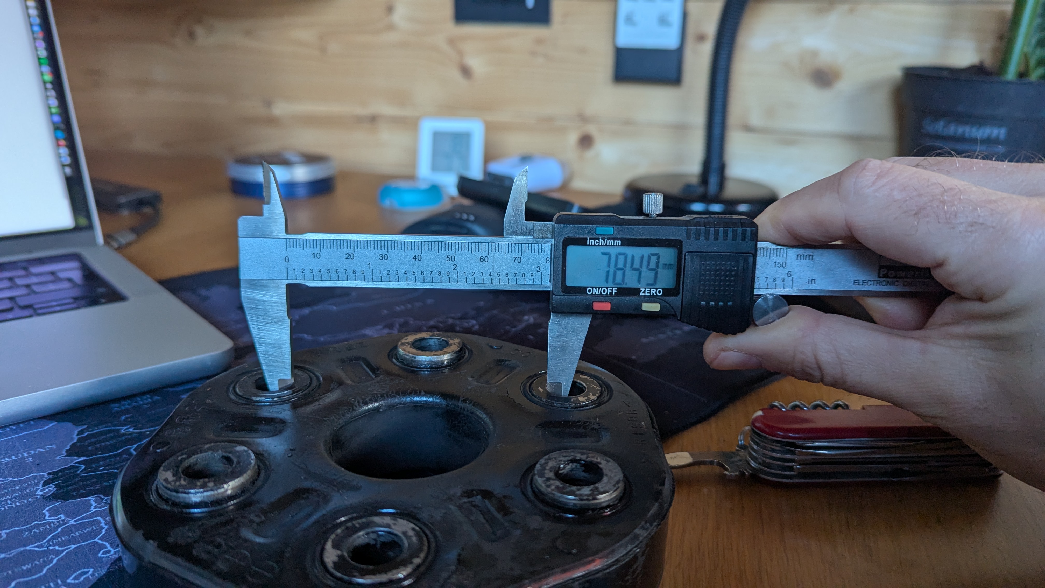

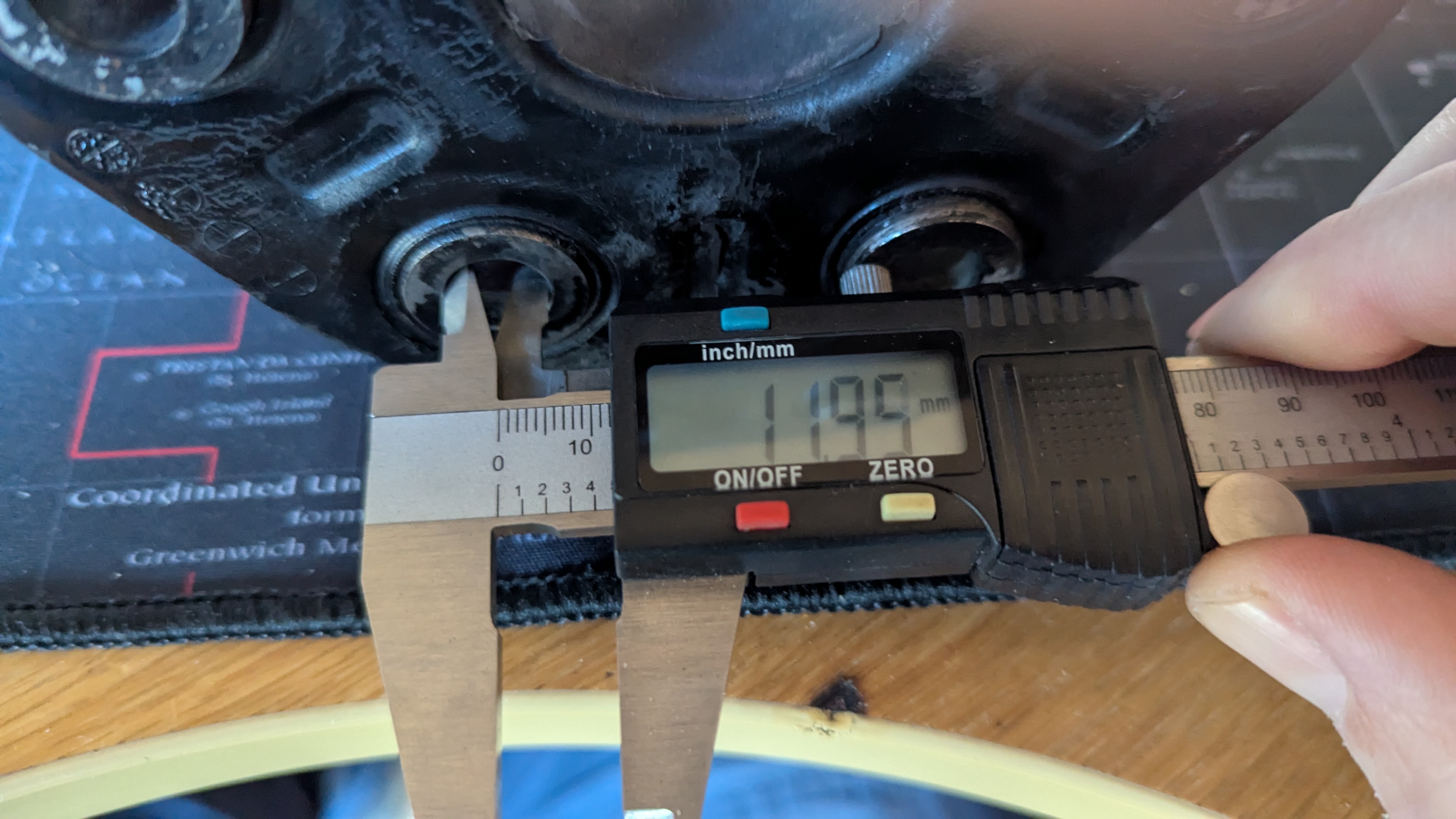

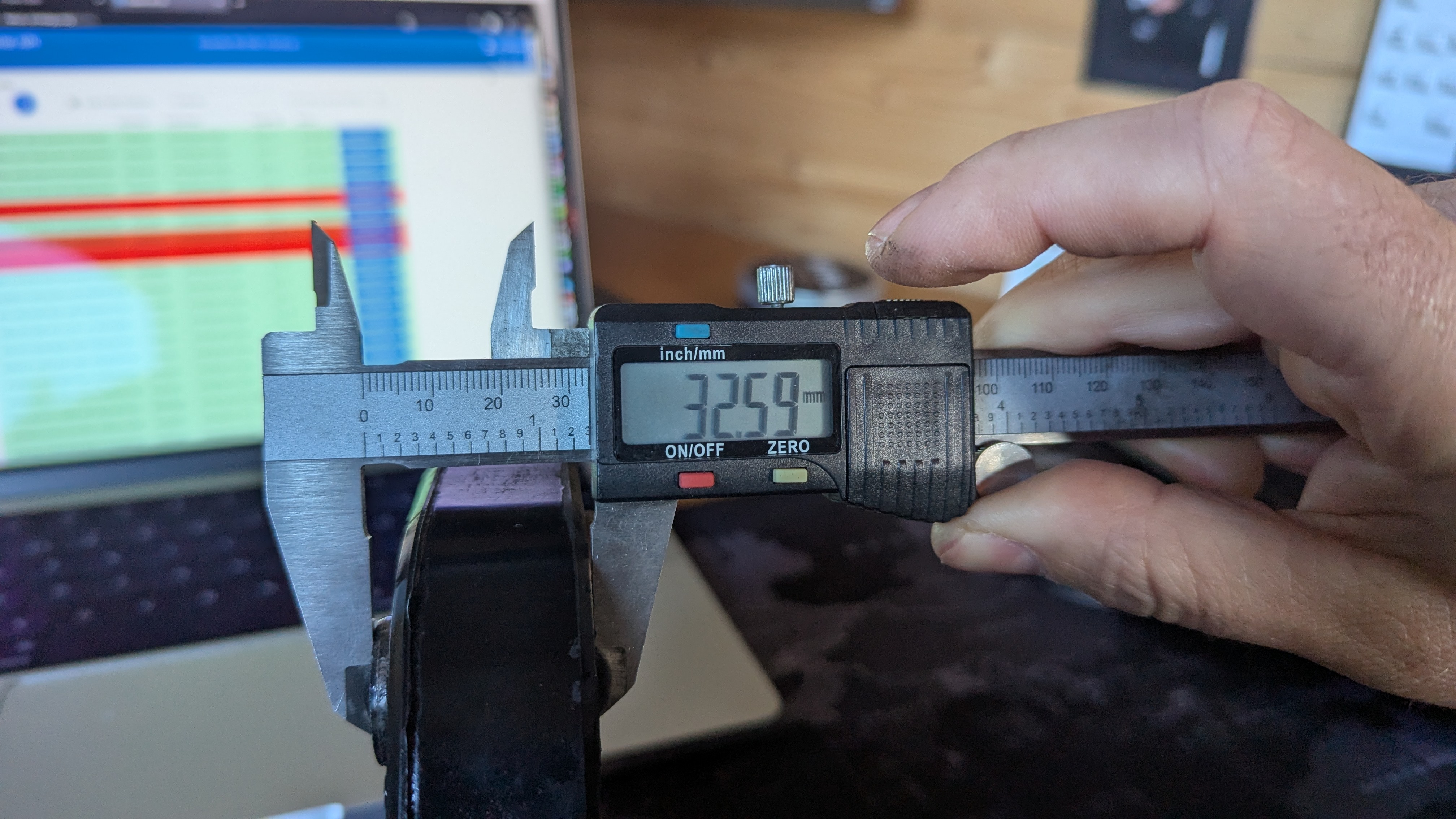

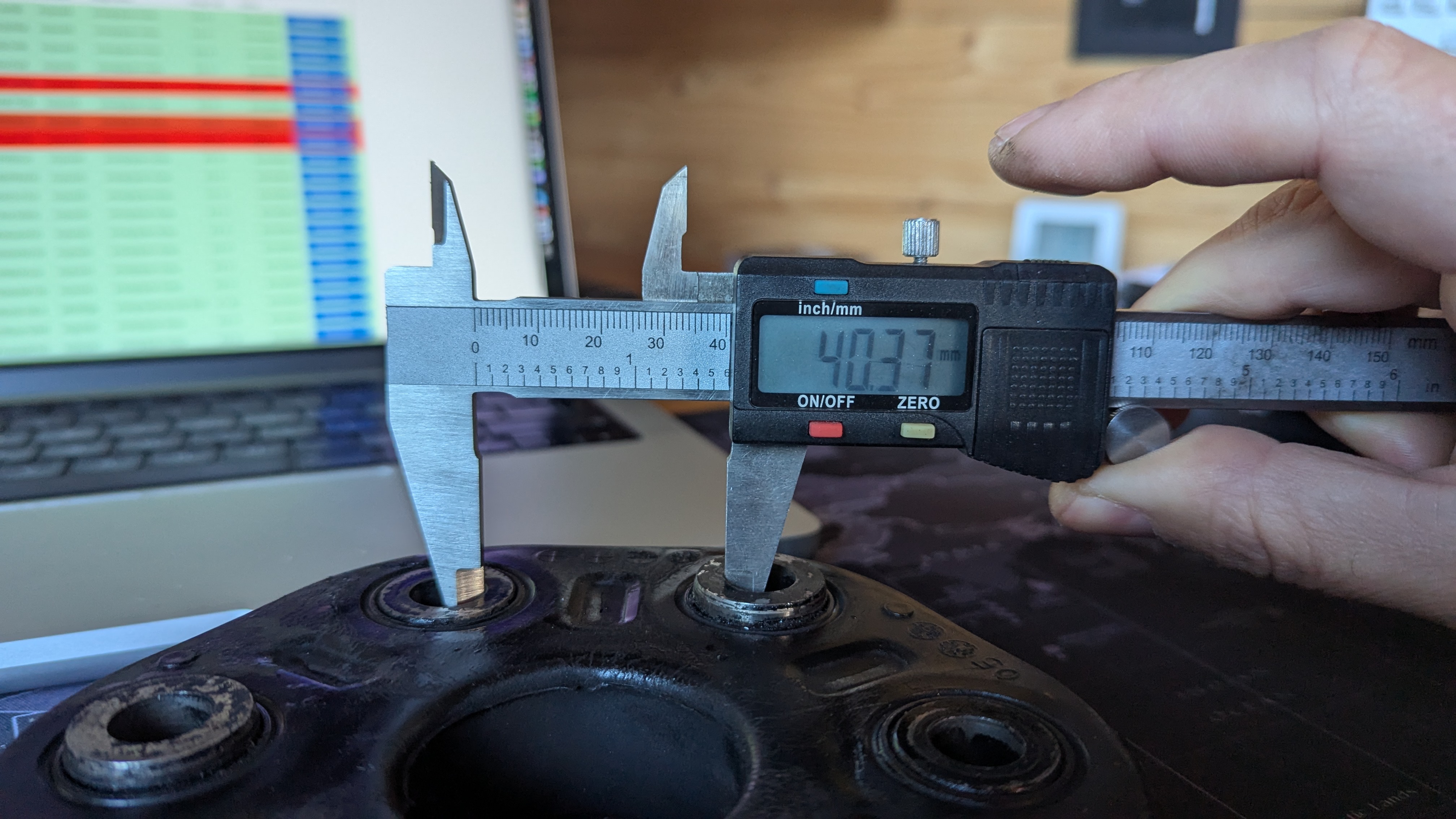

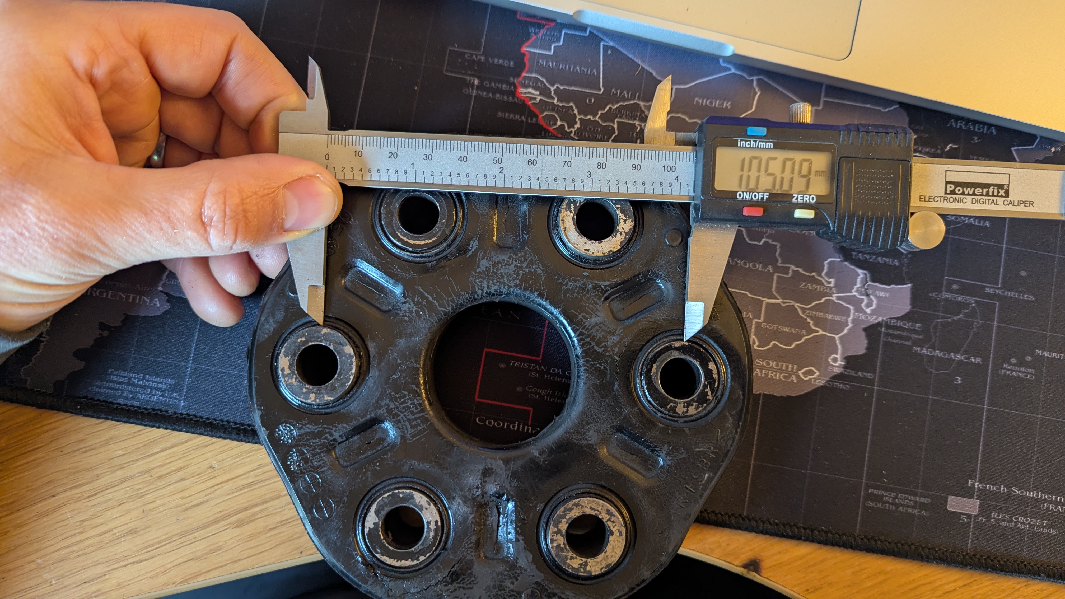

In the interest of completeness for anyone searching for this information and only finding feedback on my personal project, attached are some measurements.

It would be good to verify your measurements on the bolt holes / studs in the yokes. The flex discs can get distorted over time.
You still might struggle to center this unless there's a centering concentric bore.
There are 2 threads for anyone confused. The other has videos that look to show a guibo and a u joint on one short coupling that's allowing the driveshaft to pivot off center and wobble. This solid replacement is to try to eliminate that possibility - my current understanding anyways...
