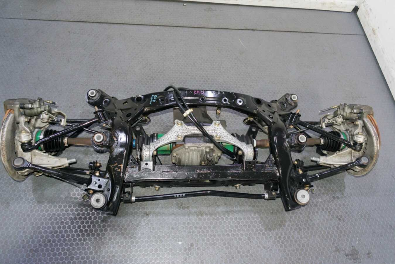

The issue here is you are neglecting these "simple mechanical facts"
1. the RX8 drivetrain couples the transmission and diff.
2. The RX8 prop slips in and out of the diff.
It looks like have done nothing to properly mount the diff and simply tried bolting the brace to the car. This wont work.
You now have no length variation compensation thus over stressing the rubber donut causing it to run out of round. This is even very apparent at stand still the rubber donut looks pre stressed.

Your diff bounces all over the place. You just bolted the PPF frame to some random undertrays under the car it looks like. So for the diff to move that much a whole lot of things are flexing. Now add the face the diff is seeing VERY minimal load as tires in the air this will break first time you even put any sort of power down.
Note how the diff only has those two small bushings that are transverse bolted. Thus the diff can rotate around those and the also offer very little side to side stiffness to the diff location. You have drastically altered the way the drivetrain is mounted/suspended in the vehicle without making sure to properly accommodate the forces and required movements.
The RX8 , RX7 and MX5 share the same setup so have a look what other people do when they remove the PPF frame/brace

Help us understand what we're looking at.
Does the transmission to rear diff frame C shaped channel connect to the GS450h transmission on multiple planes? To me it looks like you have the frame up along the driveshaft connected to the diff stock but have something not tied in well at the transmission connection because
the wobble looks to pivot at the transmission.
Can you post pictures of the diff to frame and frame to GS450h transmission connections? Those should help a ton.
And if you post them on Google photos it can help to add a comment to each explaining what we're looking at.
Is that the stock driveshaft? If it was modified is it concentric and balanced?

It might be that the heavier modified driveshaft is more rigid and kind of amplifies the problem more.
Having another driveshaft made likely will not solve the issue that I think I'm seeing in your videos. It looks to me there's a plane that's not locked down between the gs450h transmission and the rear diff.
It looks to me like:
- the tail of the transmission is allowed to move / flex left to right too much. Missing diff bolt to the torque frame? The diff doesn't look like it's tied to the torque frame well at the back.
- looks like some transmission to driveshaft to diff angles might not be right. These aren't always straight forward as things move and twist when loaded up.
- your transmission mounts might be too soft. I've seen shot motor mounts (ice) allow this amount of vibration in a drivetrain before.
- The u joint with the rubber mount up front may allow a wobble to start then throw the whole thing off balance. Is there something keeping the u joint collinear to the transmission output shaft? Can you flex the u joint to the side? I may see why you think a solid mount under there would help the situation. I'd focus here first.
What flex is there at the rear of the driveshaft / diff flange? CV? U joint?
It might be worth tieing the torque frame to the transmission instead of the floor? You have rubber mounting on the diff then solid? Mounted the torque frame to the floor. That turns the floor into a speaker.

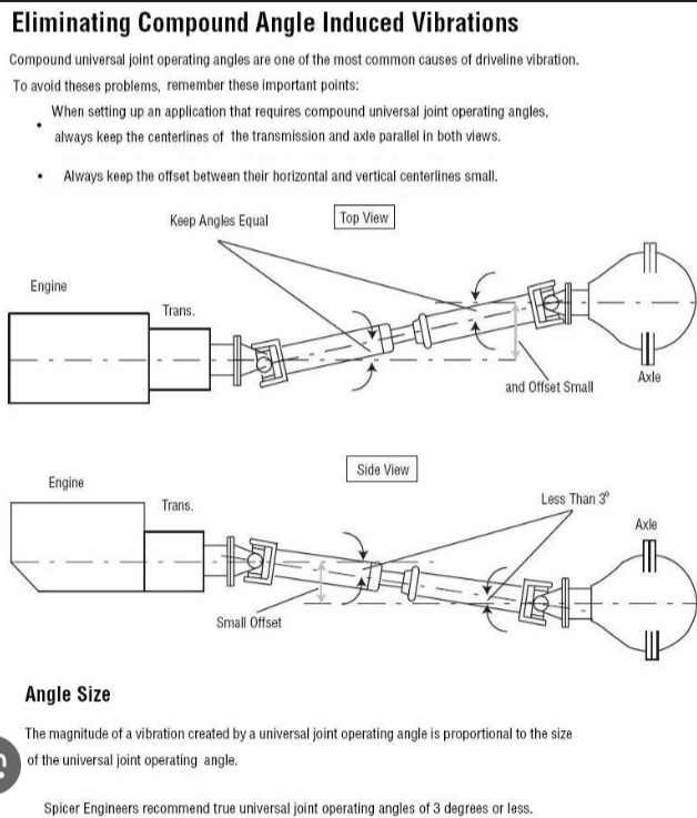

Ok so UJs are not a constant velocity joint and if the gearbox flange and diff flange aren’t square to each other, so that the angle of each uj cancels the other out you can create a vibration, also can’t see your entire prop shaft there but is it correctly phased? the yokes at each end of the prop should align, being 90degrees out causes issues

An odd number of u joints isn't a great idea as they are not constant velocity when angled.
Worth a watch before you decide,

I understand the issue but there are a few mitigating circumstances, the main one being that the u-joint will almost never be at a different angle from its set angle as the diff angle doesn't change (much) in relation to the transmission owing to the PPF holding it in place.
Plus there will only be 2 u-joints in the setup. One in the middle section of the prop and the other at the diff end.
The illustration show in the video above assumes the diff angle will change drastically in relation to the transmission which in an rx-8 doesn't happen.

Probably your issues are originating from these (which have already been pointed out):
1. Improper fixing of the diff (this however is propably not the source of vibration)
2. Universal joint fixed onto a rubber bushing (U-joints should always be used in pairs and the alignment of the input and output angle is critical. Some misalingment along with one of the U-joints connected to the rubber bushing might cause the vibration)
3. When swapping in the GS450h tranny, did the length of the shaft prohaps increase? You should check the critical speed of your shaft with your dimensions:
https://spicerparts.com/calculators/cri ... calculator
I would higly recommend using CV-joints in conversion projects. As the name implies, the joint provides the output speed according to the input speed, regardless of the angle. This has the benefit that perfect angular alignment is not needed. Also, you should try to keep the input and output angle as close as possibly to each other but still have the input and output shaft on adjacent planes to have some angle in the joints. This way the bearings of the joint will wear more evenly.
