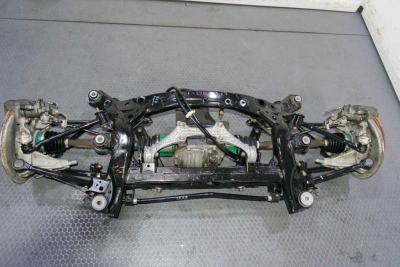

Hi All,
I'll get around to documenting my setup at some point, but i'm currently in need of some help.
I'm testing my setup with the custom driveshaft/propsharg i've had made, and it's very unstable. Like a wet noodle. See the videos below.
This is the 2nd propshaft -- the first one was a modified rx8 shaft. I replaced it thinking it must be the shaft, but the brand new shaft has exactly the same issue.
Can anyone offer advice on how to diagnose this issue, i'd appreciate it.
I've measured with a dial indicator that the shaft varies by ~0.5mm on both ends when moved by hand,
I know rx8s are quite particular about transmission - diff mounting, but surely this is excessive for that.

The issue here is you are neglecting these "simple mechanical facts"
1. the RX8 drivetrain couples the transmission and diff.
2. The RX8 prop slips in and out of the diff.
It looks like have done nothing to properly mount the diff and simply tried bolting the brace to the car. This wont work.
You now have no length variation compensation thus over stressing the rubber donut causing it to run out of round. This is even very apparent at stand still the rubber donut looks pre stressed.

Re: Project RX-8 w/ GS450h Drivetrain
Yes you need to solve two problems.
1.Diff mounting so it is done right
2. a single piece prop that has a slip joint
Your diff bounces all over the place. You just bolted the PPF frame to some random undertrays under the car it looks like. So for the diff to move that much a whole lot of things are flexing. Now add the face the diff is seeing VERY minimal load as tires in the air this will break first time you even put any sort of power down.
Note how the diff only has those two small bushings that are transverse bolted. Thus the diff can rotate around those and the also offer very little side to side stiffness to the diff location. You have drastically altered the way the drivetrain is mounted/suspended in the vehicle without making sure to properly accommodate the forces and required movements.
The RX8 , RX7 and MX5 share the same setup so have a look what other people do when they remove the PPF frame/brace

Help us understand what we're looking at.
Does the transmission to rear diff frame C shaped channel connect to the GS450h transmission on multiple planes? To me it looks like you have the frame up along the driveshaft connected to the diff stock but have something not tied in well at the transmission connection because
the wobble looks to pivot at the transmission.
Can you post pictures of the diff to frame and frame to GS450h transmission connections? Those should help a ton.
And if you post them on Google photos it can help to add a comment to each explaining what we're looking at.
Is that the stock driveshaft? If it was modified is it concentric and balanced?
Don't give up. If you have ideas your unsure of, post them here as ideas and we can help you work through them and help course correct.

It might be that the heavier modified driveshaft is more rigid and kind of amplifies the problem more.
Having another driveshaft made likely will not solve the issue that I think I'm seeing in your videos. It looks to me there's a plane that's not locked down between the gs450h transmission and the rear diff.
It looks to me like:
- the tail of the transmission is allowed to move / flex left to right too much. Missing diff bolt to the torque frame? The diff doesn't look like it's tied to the torque frame well at the back.
- looks like some transmission to driveshaft to diff angles might not be right. These aren't always straight forward as things move and twist when loaded up.
- your transmission mounts might be too soft. I've seen shot motor mounts (ice) allow this amount of vibration in a drivetrain before.
- The u joint with the rubber mount up front may allow a wobble to start then throw the whole thing off balance. Is there something keeping the u joint collinear to the transmission output shaft? Can you flex the u joint to the side? I may see why you think a solid mount under there would help the situation. I'd focus here first.
What flex is there at the rear of the driveshaft / diff flange? CV? U joint?
It might be worth tieing the torque frame to the transmission instead of the floor? You have rubber mounting on the diff then solid? Mounted the torque frame to the floor. That turns the floor into a speaker.

tieing the PPF (torque frame) into tranmissin is quite significant job ... just googling mx5 PPF delete will get you lots of pictures what people have done to remove it and also to retain it (rx8,rx7,mx5 have similar setup)....ive got a is300h as an upgrade for my mx5 project and ill be amaised if i can do it in less than a year and ive brought stuff to jig it outside of the car. the ppf is about 5ft long and its one hell of an effective lever.
with the 450h propshaft, instead of having one < 5ft propshaft you get 2 that are just over 2 feet, so as long as its all aligned it should be better.. remeber in oe application without the ppf there is always alot of flex of the diff (as they are normally rubber mounted). at the very least i would expect tghe vibrations with a 450h gearbox to happen at 2-3x the current speed.

I used to do spec Miata prep, so pretty familiar with this, just not all the names its got.rstevens81 wrote: ↑Fri Dec 06, 2024 2:40 pm tieing the PPF (torque frame) into tranmissin is quite significant job ...
I believe you could do it with 1 bent piece of sheet metal that bolts the stock PPF to the gs450h. But I'm spoiled with Solidworks, a 3d scanner and a bunch of sheet metal experience.
For clarity I don't think this is the root of op's issue, I think it's just amplifying the sound - and I'm making assumptions because I haven't seen pictures of most of his setup yet. It's hard to see what's what in the videos.

I've got a gs450h prop shaft, and an mx-5 prop shaft.
I will chop the end off the gs450h shaft and put on the diff-end of the mx-5 shaft.
The gs450h has the slip joint in the middle which will solve one issue. I've no idea where i'll mount the middle section...but i'll figure it out.
The only difference compared to a stock gs450h shaft will be that on the diff-end there will be a U-joint instead of a donut.
I can't upload an mp4 file so here's a link to the video explaining my idea
https://photos.app.goo.gl/Na9mM86KXQq73LB67
I do have a concern about the extra u-joint but I think it's my best option. I will very likely make/buy a solid coupler at some point

An odd number of u joints isn't a great idea as they are not constant velocity when angled.

I understand the issue but there are a few mitigating circumstances, the main one being that the u-joint will almost never be at a different angle from its set angle as the diff angle doesn't change (much) in relation to the transmission owing to the PPF holding it in place.
Plus there will only be 2 u-joints in the setup. One in the middle section of the prop and the other at the diff end.
The illustration show in the video above assumes the diff angle will change drastically in relation to the transmission which in an rx-8 doesn't happen.
