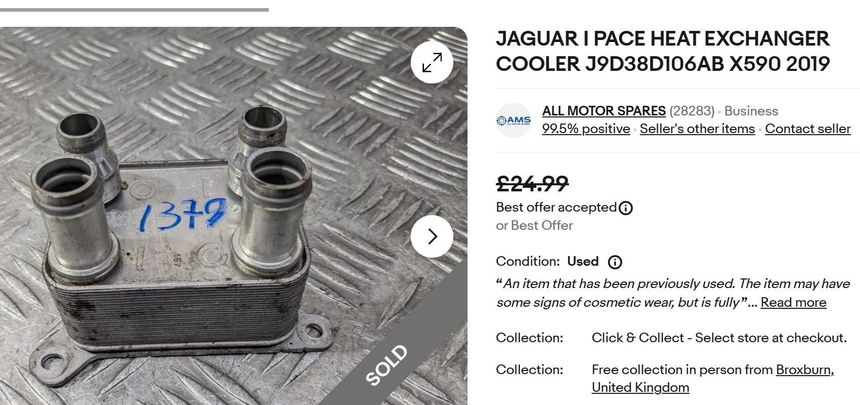

Re: Is scavenging inverter/motor heat safe during winter?
this is the parts i used
over size radiator for summer temps passive no fan, 3 way bypast and heated in winter.
temp controlled using a PLC
Nicely done!
I would recommend you use Fiat 500 Siecento radiator. It is much smaller in height and size and is plentiful for summer.
I recognized the greatest source of heat is actually charger when car is stationary. This is the only reason to keep a cooling fan.
https://mazdamx3ev.wordpress.com/2023/1 ... ng-piping/
